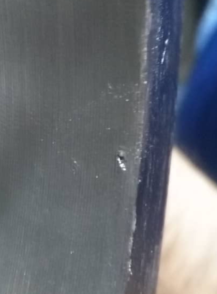

We are welding flux cored stellite 6 with automatic mig welding machine , only in bore welding(not outside) we have some porosity in welding after machining.
Amper 160-180
Wire 1.2mm
Attached image of porosity
Anyone can help me
