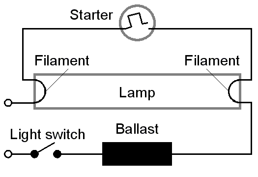

I Just tried to install a couple of units that someone gave me (used) some time back.
They are both dual bulb units. About 48" long.
So, i wire it up - only one side lights (and that takes about 10 seconds).
I swap the starters - same side lights (ie no change)
I swap the bulbs - no change (still same side lighting)
I get the other unit - wire that in. On this one, only one bulb lights (happens to be the other side)
The starters - no change
Getting frustrated now.
I swap the transformers. No change. Still the same (physical) side lighting, and, on both units, it takes about 10 seconds.
The terminal block that takes the mains in is a push lock one (push, and insert wires, then release)
6 terminals (3 pairs) - i assume they are in commoned pairs, but, in case, if tried wiring to the other sides, and, no change there either.
The only common part to both bulb/starter/transformer combo is the capacitor. I assume it *must* be this?
...but i know zero about these things. Am i just being an idiot somewhere? (and what's with the bulb that does light taking 10 seconds to do so?)
