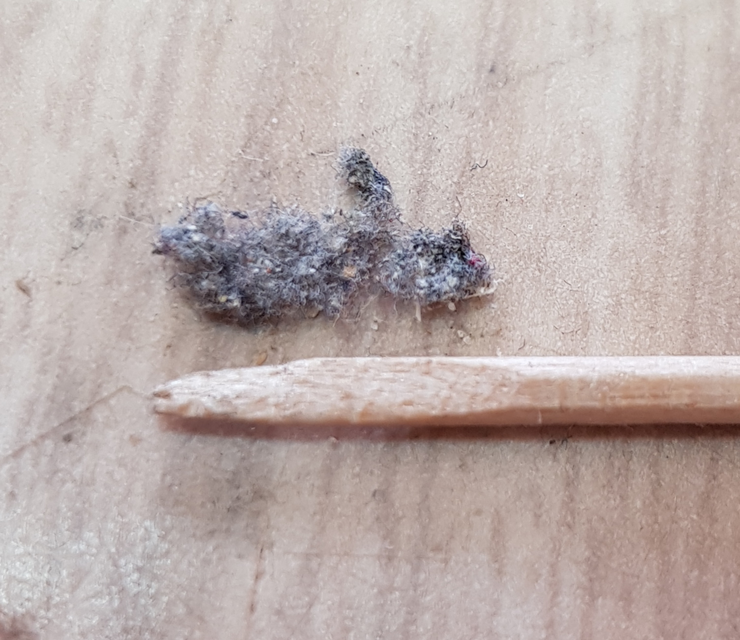

I have a Galaxy S8 with a USB C socket. Usually I charge it from a wireless pad. On the occasions I use the standard power lead I've not been happy with the connection, it never seemed to locate properly and I'd intermittently get slow charging messages.
Having nothing better to do I thought I'd try to find out why?
It didn't take much effort to discover the root of the problem, just a bright light and a jeweller's loupe.
You've guessed it - FLUFF.
Quite a considerable amount that meant that the plug was held out by around a millimetre.
Remedy, shave a toothpick so that it fitted comfortably into the socket without straining the connector strip and remove said detritus.

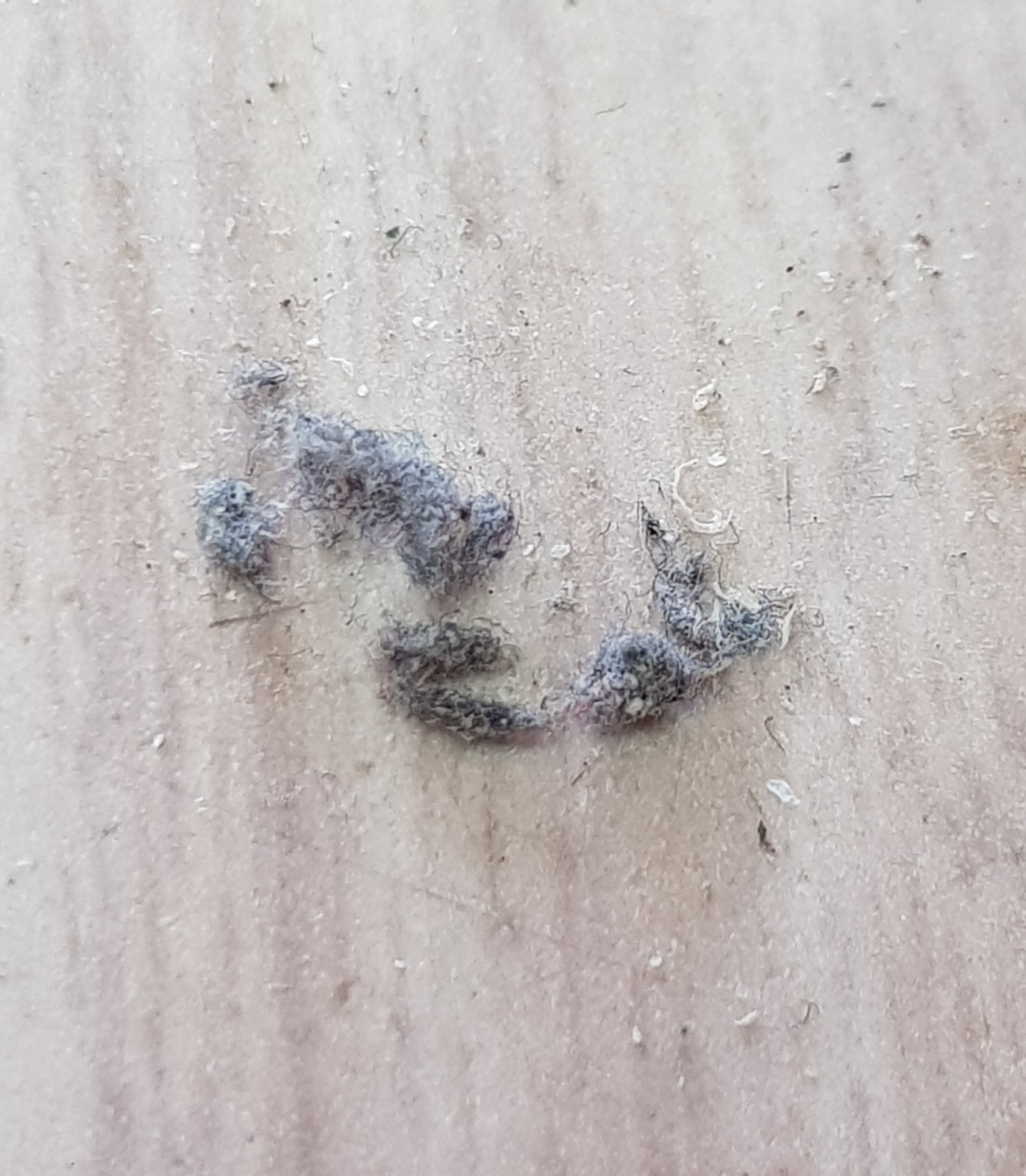

And to give it some scale
That little lot has managed to build up in under a year (in fact probably less than 6 months since this has been a noticeable problem for some time). I can't say it has ever been an apparent with USB B sockets. Maybe I'm getting fluffier in my old age?
Still, all working fine now and the connector snaps home nicely.
