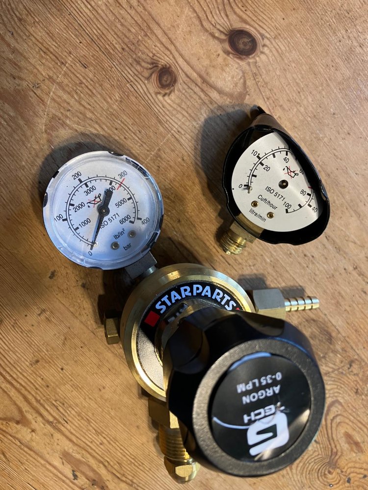

Been in engineering all my life but never welded, wanted to fix up an old car so I bought an R-Tech 180 MIG set a few years ago which came with a cheapo Starparts regulator (pretty sure it’s the same as R-Tech part No. RT-CR0590-1 on their website). The reg has two 50mm gauges and I mangled the LP one (see pic) which is calibrated in flow units (0 to 40 LPM / 0 - 100 CFH) but is clearly a pressure gauge calibrated for flow. I assume it’s calibrated for the set up I bought and gives a simple, cheap (but not necessarily accurate ?) way of setting flow without having a specific flow measurement device fitted.
I thought I would simply be able to buy a new flow gauge from R-Tech, Starparts or somewhere selling a suitably compatible unit but I can’t find one. I called R-Tech’s tech help line & left my number on their auto answer system but didn’t get a call back (bit disappointing….) so maybe this forum can advise ?
Can anyone tell me where to get a suitable “flow” gauge or why they’re are not available ?
If a gauge calibrated for flow isn’t available I assume I can simply use a pressure gauge and set the flow via the low side pressure ? If I go this way is there some simple rules for what low side pressure to use for a standard MIG set up like mine ?
Or should I really fit a peashooter flow device on the reg outlet (as well as fitting a low side pressure gauge) and adjust the flow via the low side pressure and flowmeter valve ?
I just want to get back to it without too much expense or hassle.
Thanks
