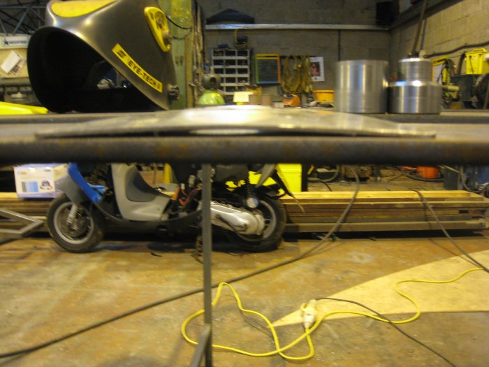

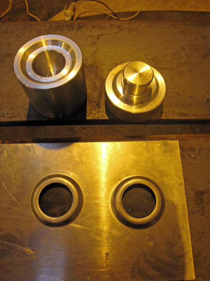

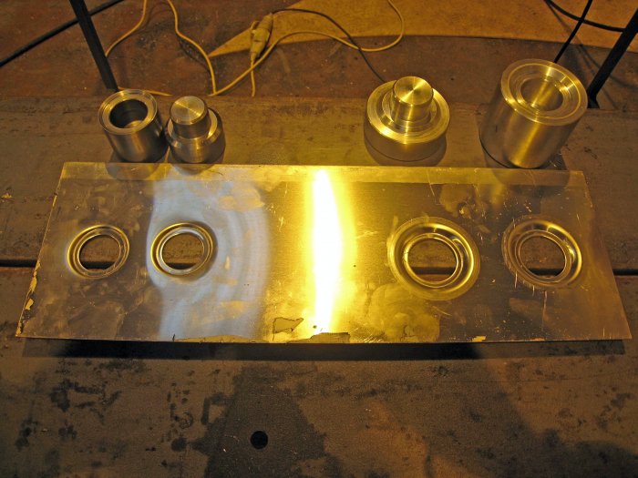

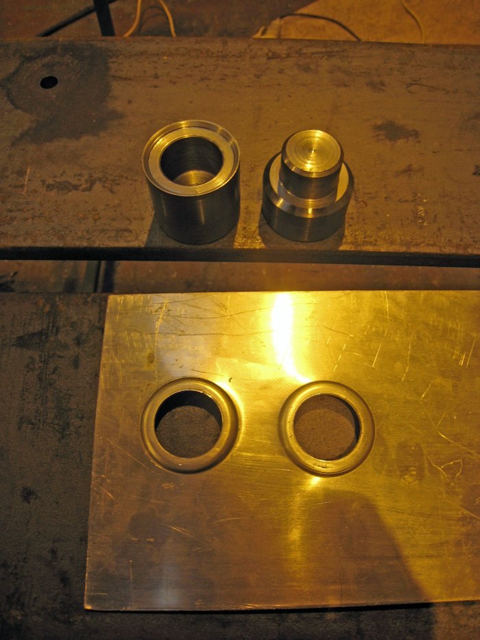

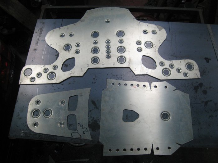

Had a half day to myself so started making flanging tooling for a light weight seat I will be making for my buggie projects.

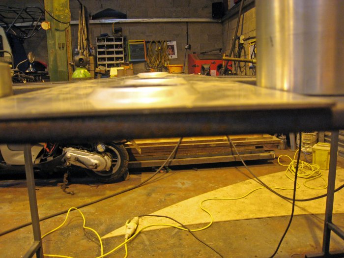

First attempt did not go too well the sheet had a tendancy to buckle when the dimple was formed. To overcome this I made another set with a flange on the outside of the dimple which worked a treat when pressed the flange clamped the sheet and helped keeping the sheet from buckling.
