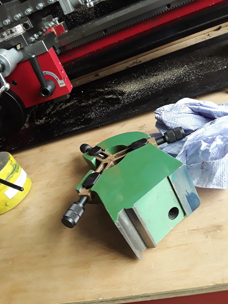

The mini lathe fixed steadys are poor, they don't sit flat on the ways and rock slightly. Warco went through their entire batch and couldn't find me a good one. Any tips on how to adjust the surface? I've seen Zoro do a scraper for £8. I also have a diamond flat grinding block, could try that?
Photo shows my steady with some engineers blue showing how it sits on the ways.
