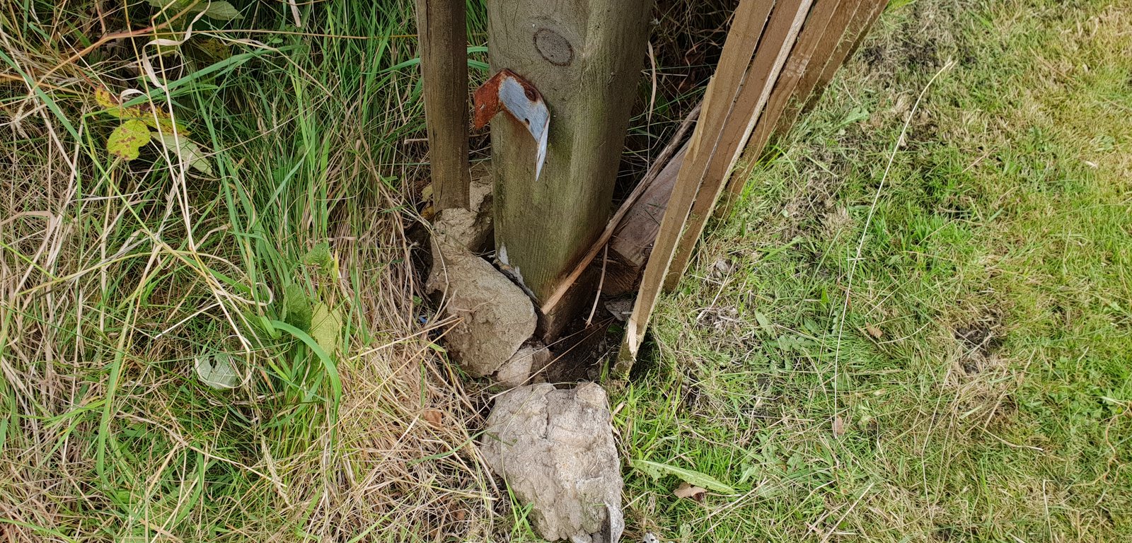

It's even better to use 4 inch square recycled plastic set in concrete as posts . Even better if they are for an H section post for dropping in fence panels . The 3 mtr ones I dropped in 33 yrs ago are still there .At this property the 4 inch oak fence wire posts were all rotted away at the dew point ( an inch or two below the soil and about nine inches above it) all posts were set in concrete the wood in the concrete was as new they were however well soaked in old creosote from when the bungalow was built thirty years ago . I spent ages chopping out the old concrete and wood then dug a new hole half way betwennth next post and bespoke made a new fence panel to drop in th new concrete H section post I was using for fence posts . There after a new hole was dug in clean soil at a full panel length missing all the rotten stumps . Had to use the other half of the first panel to make the end one and also chop out the old concreted in post . . I did 22 panels like that
This is what the post office aka BT did/ do to telegraph poles . Soak a post for six weekes (aka " pickling the timbers or post or pole ) in a tall tub so the creosote preservative is going to reach up the post nine inches above the finished soil level or lay them flat in a tank of creosote , re treat once every seven years by digging out 4 inches of soil/back fill and treat from there to 9 inches up the post/pole then the posts should last a hundred years or more . If you put a lead capping on the top of the post that's cut at an angle to run off rain the top end of th post wont rot either .
When I did my training course with BT in Harrogate in 1988 we found loads of poles 96 years old IIRC and as good as the day they were planted .
The main reason previously treated with modern copper salt based preservatives etc. is as the preservative degrades after a few years , the posts rot at ground level. This is due to the dew point...………. from an inch or so below the ground to about nine inches above the ground keeping the wood wet and encouraging rot & insect attack .
