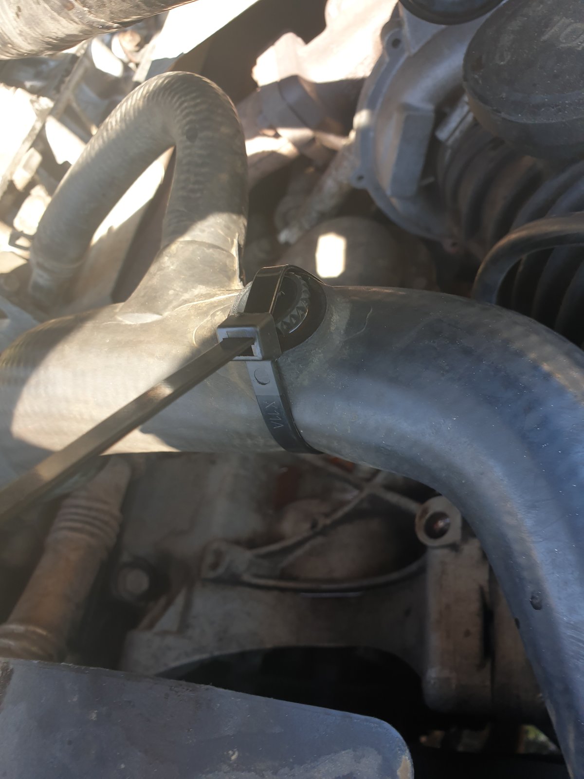

Whats gone the 0 ring or has it snapped half way down like the normally doMOT tomorrow, just doing a final check over and noticed it weeping.
Shouldn't have touched it but can't miss the MOT
This should last until I get a new hose
The good old cable tie againPulled the thread out of the hose
I hate to say it but on a TD5 it's a good chance that's a sign it is starting to pressurise if it was weeping. New hose will fix it but a good chance the fuel cooler seals will start to leak next.
at least cut the tail of the tie wrap, much more professional... like that it looks like a bodge, cut back it'll look factory....![]()
you are joking and this is a wind up? "Pulled the thread out of the hose"
Sadly no, he said it was weeping and that is first place they show.
His isn't pressurising so it's ok, it a later TD5 too soo doesn't suffer from the head shuffle.
