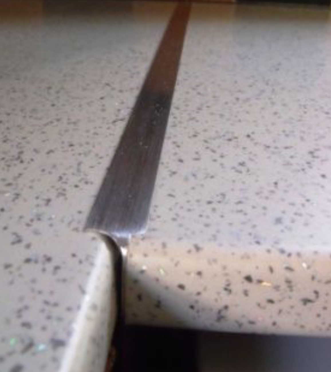

We are talking a few degrees for out of square rooms not huge angles.If you do not start the cut at 45 degress for the thickness of the radius on the leading edge then the 2 pieces will not fit together???? This is exactly what a masons mitre does and where there is a 45 degree portion on one end!
Ie. Moving the far end of a 3m worktop towards the wall 10mm to close the gap.
Need to go completely off the jig stops for bigger changes as the pins will need moving in or out to accommodate the angle change.
