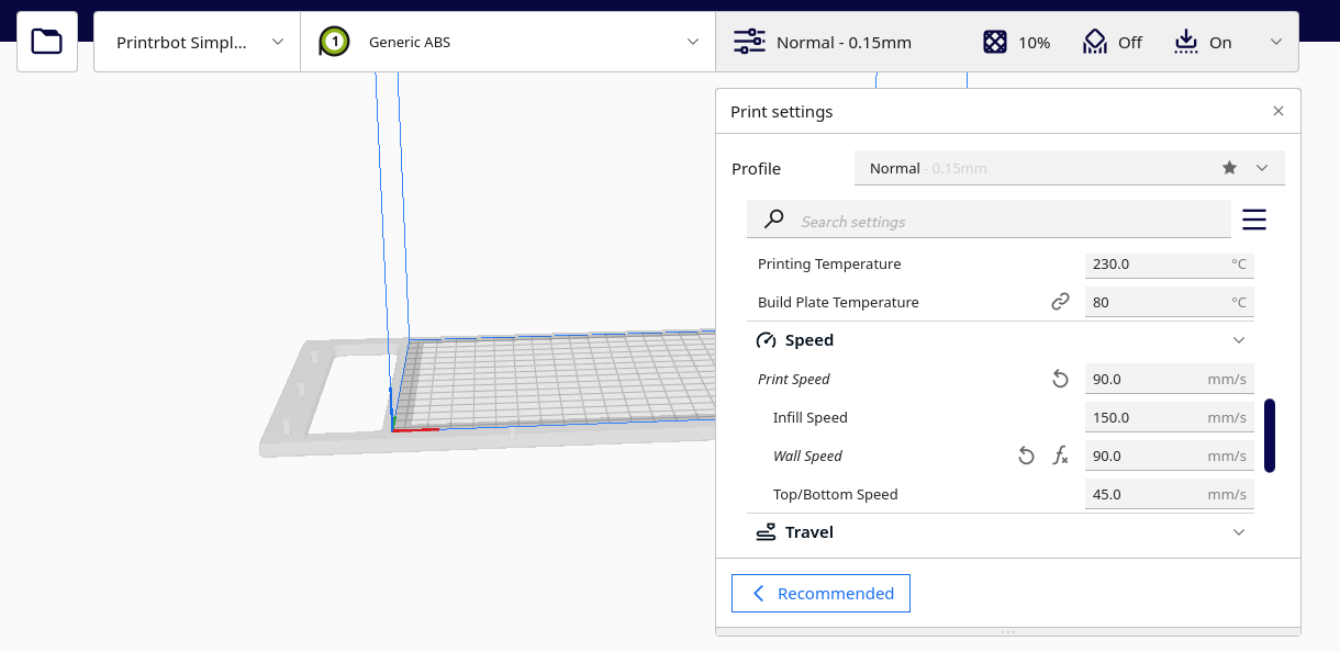

Yep the biggest issue though is printing the boxes. 7 hours for a 3 x2 x1 is way too slow. So I need to address the supports issue and let them keep printing while I get on with other things.It can be the hotend sensor itself calibrated different from machine to machine too. I had a sensor go bad (well I broke the fine wire as it entered the hotend...) and had to fit a replacement, and I had to reduce my nozzle temps by 5c to get the same hotend temperature as measured with a thermometer.
I suspect cura is the same as prusa in this respect, but the default speed for non prusa (or ultimaker) printers are snail speed slow. I think slicer makers go with really conservative settings for printers from other brands apart from their own, and maybe they pick the speeds because its better if it works for everyone even with badly tuned settings and issues but is dog slow. So now the fun bit after getting it printing right is seeing how far down you can push the pedal...
Maybe by looking at the flow (extrusion) rates but I'd have to look up what they should be for different nozzles.Is it possible to work out what nozzle size was using in a slicer to generate the Gcode??

My P1P is approx 4 times faster. I had to prove that to myself by printing some boxes I had previously printed on the Ender 3.Been busy testing today but managed to get some good intelligence on what's working.
As its for gridfinity boxes and bases the extra temp is really making the difference. It would be nice to get a little more speed as it's only doing 50 currently.

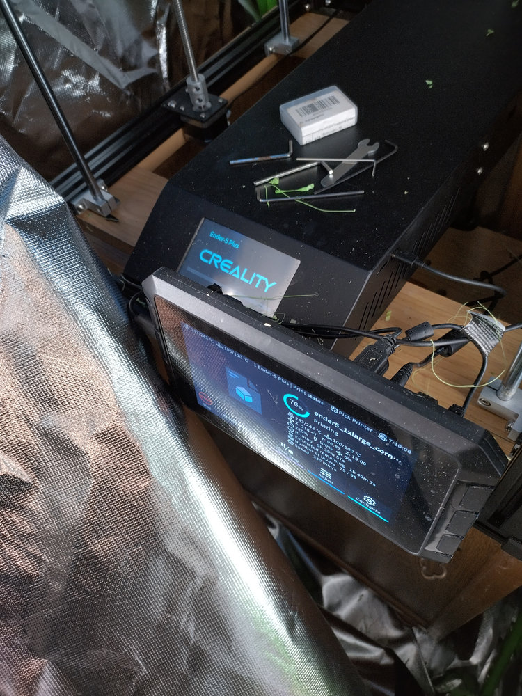

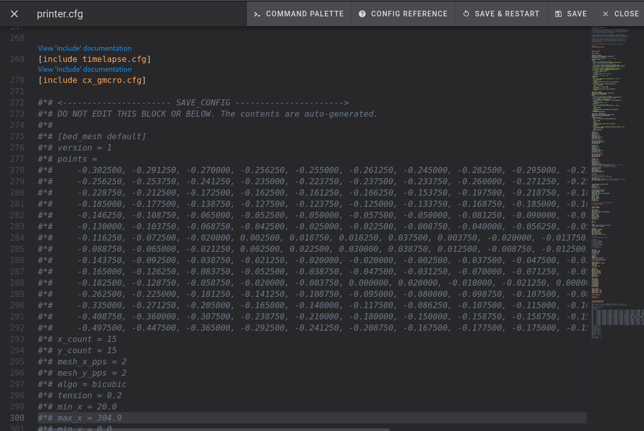

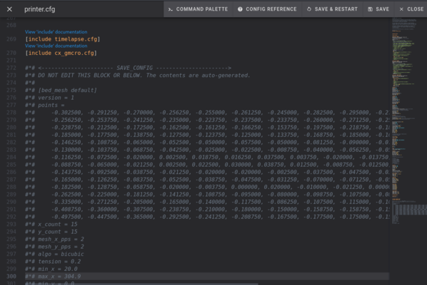

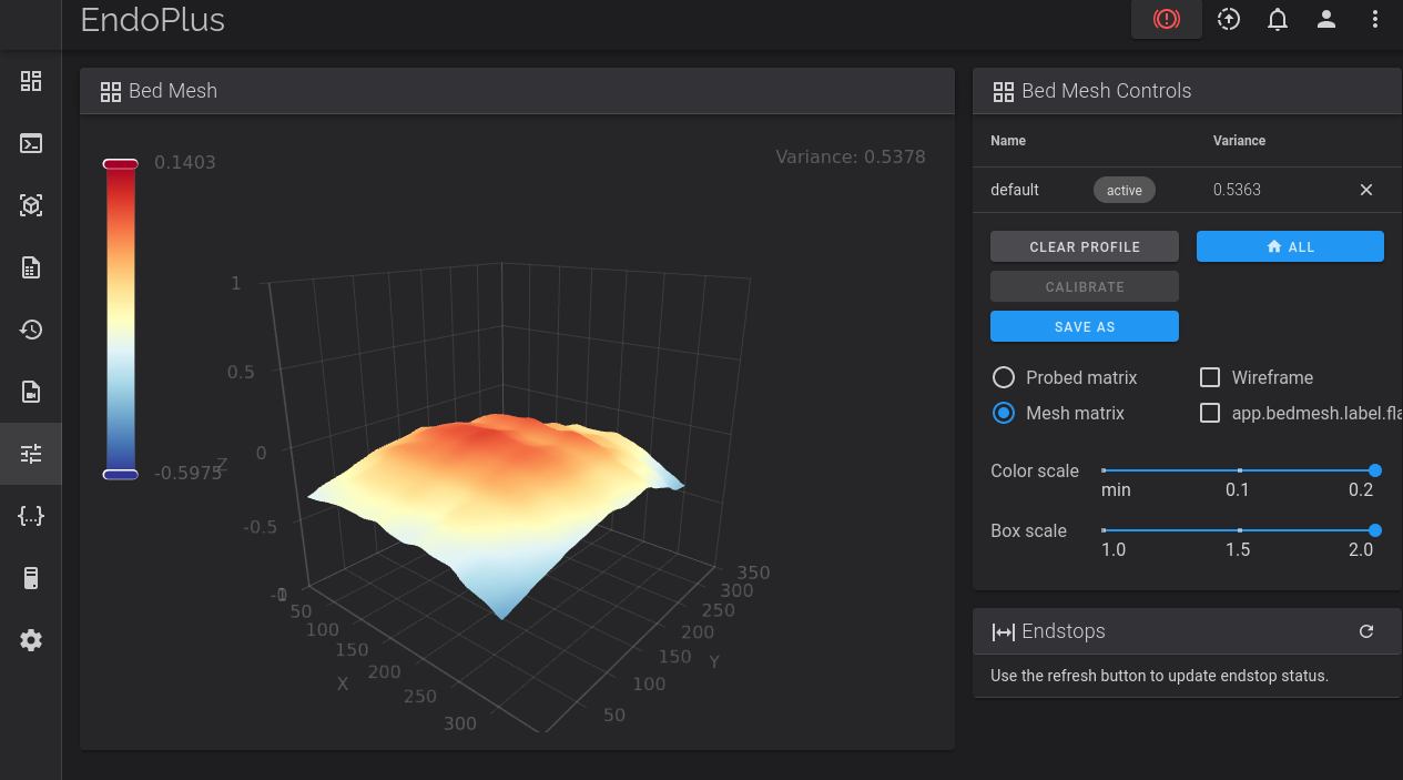

My ender5-plus has klipper firmware on it on the stock 4.2.2 creality board it came with which turns the printer itself into a zombie controlled by the host only, no control via the front panel at all and the display just shows the boot splash screen permanently, so you need a second device to run klipper host on (a pi or linux tablet etc) that connects directly to the usb port on this version of the ender. The idea being that the interface and UI and heavy lifting is all done by the host, leaving the oem board free to just be a controller for the steppers which is why it is so much faster. The host has a octoprint style print preview, uploading and queue for prints, integrated cameras that you can set up for timelaps or live monitoring remote and a bunch of other features.
Creality themselves sell their sonicpad tablet that comes with klipper host and will reflash the printer as part of its initial first start process if you want the click and go solution. Here's their blub https://www.creality.com/products/creality-sonic-pad and as usual with creality, the prices dip considerably in one of their many sales (they were 84e in one sale this year)
I was going to use a beaglebone sbc as the host, then I got a sonic pad gifted me so that's what I'm using and, much as I like to make things from scratch its pretty slick to be honest.
