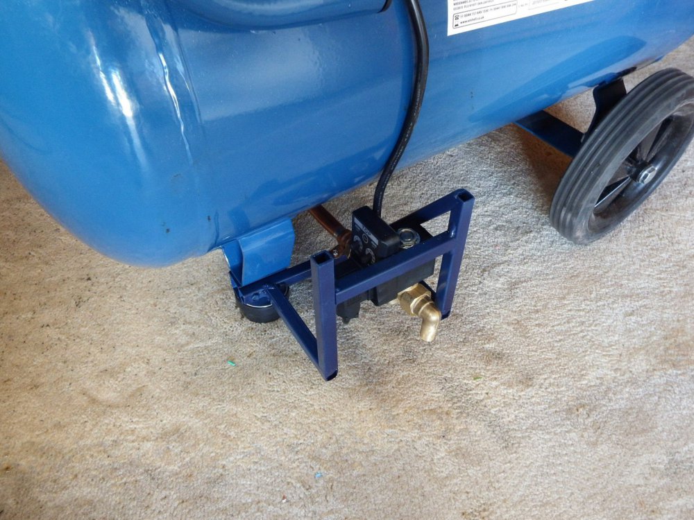

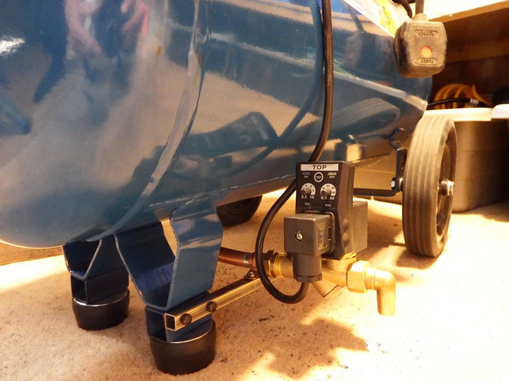

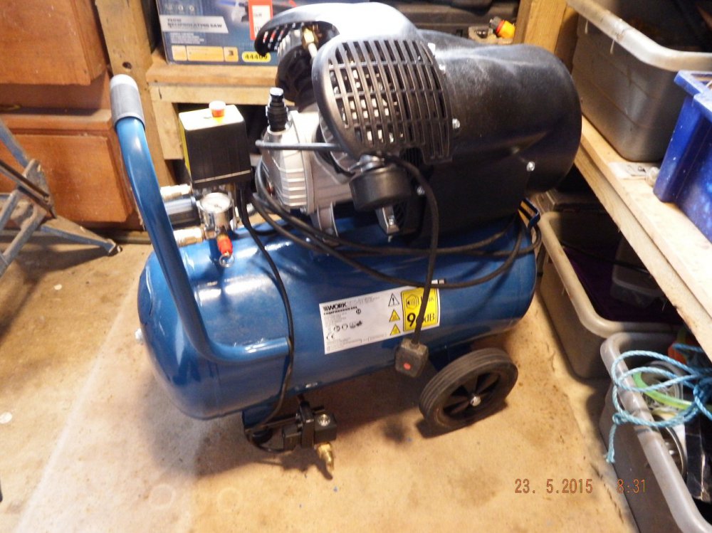

How do people wire up their auto drains ?
The method I am considering is parallel with motor so the auto drain only works when motor running
