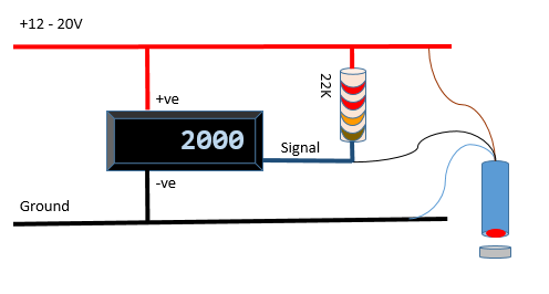

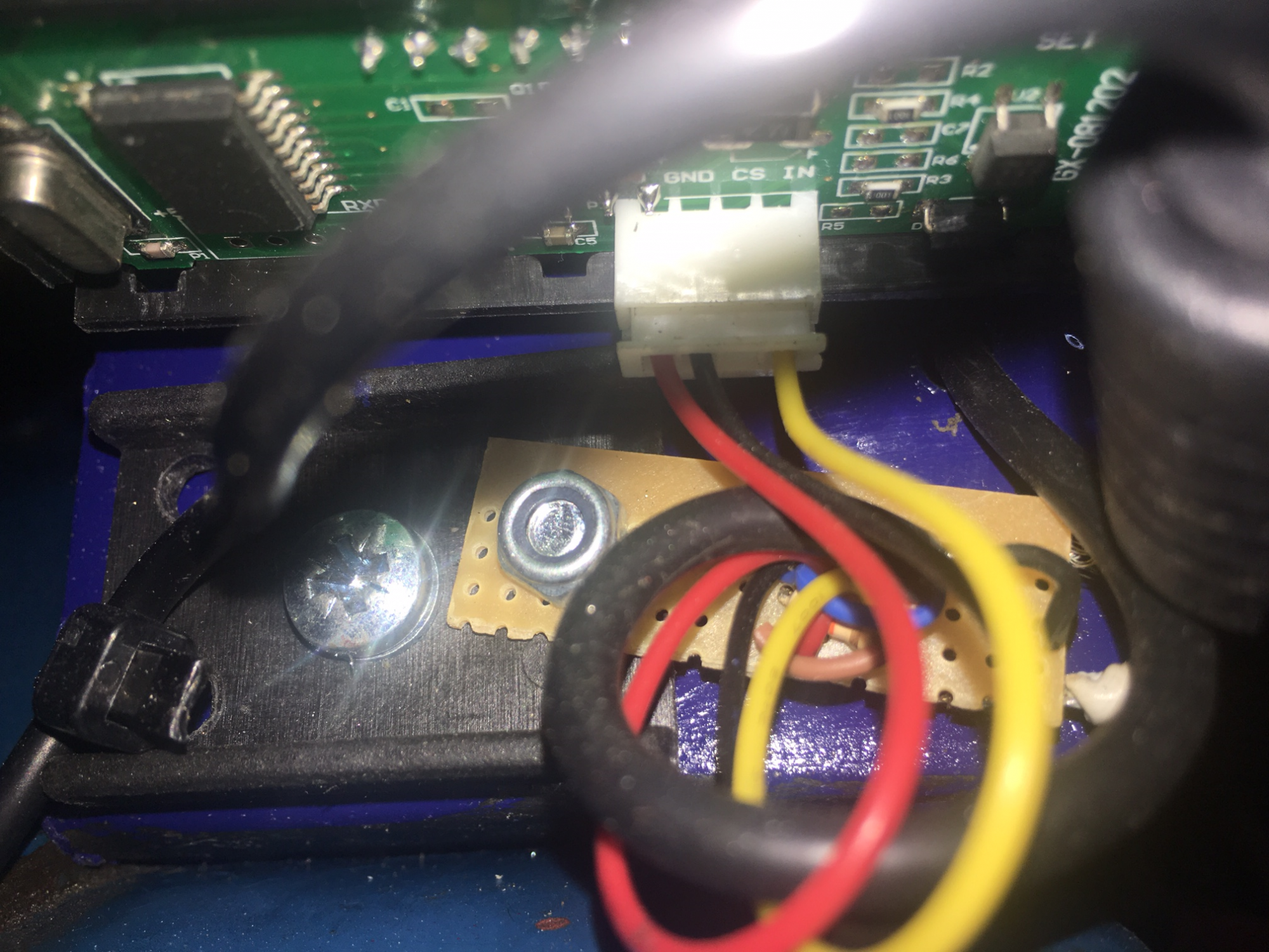

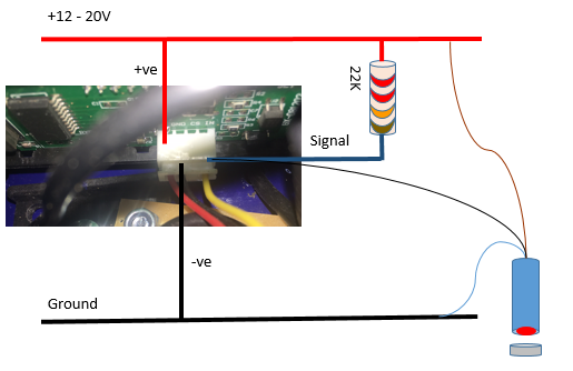

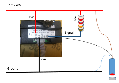

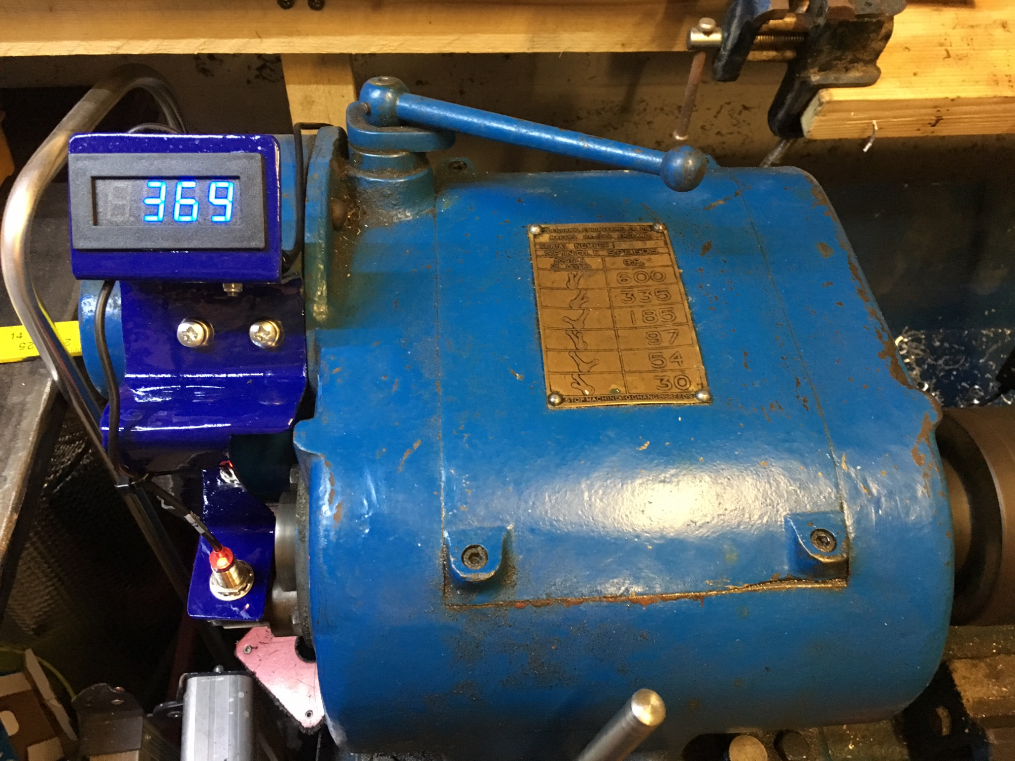

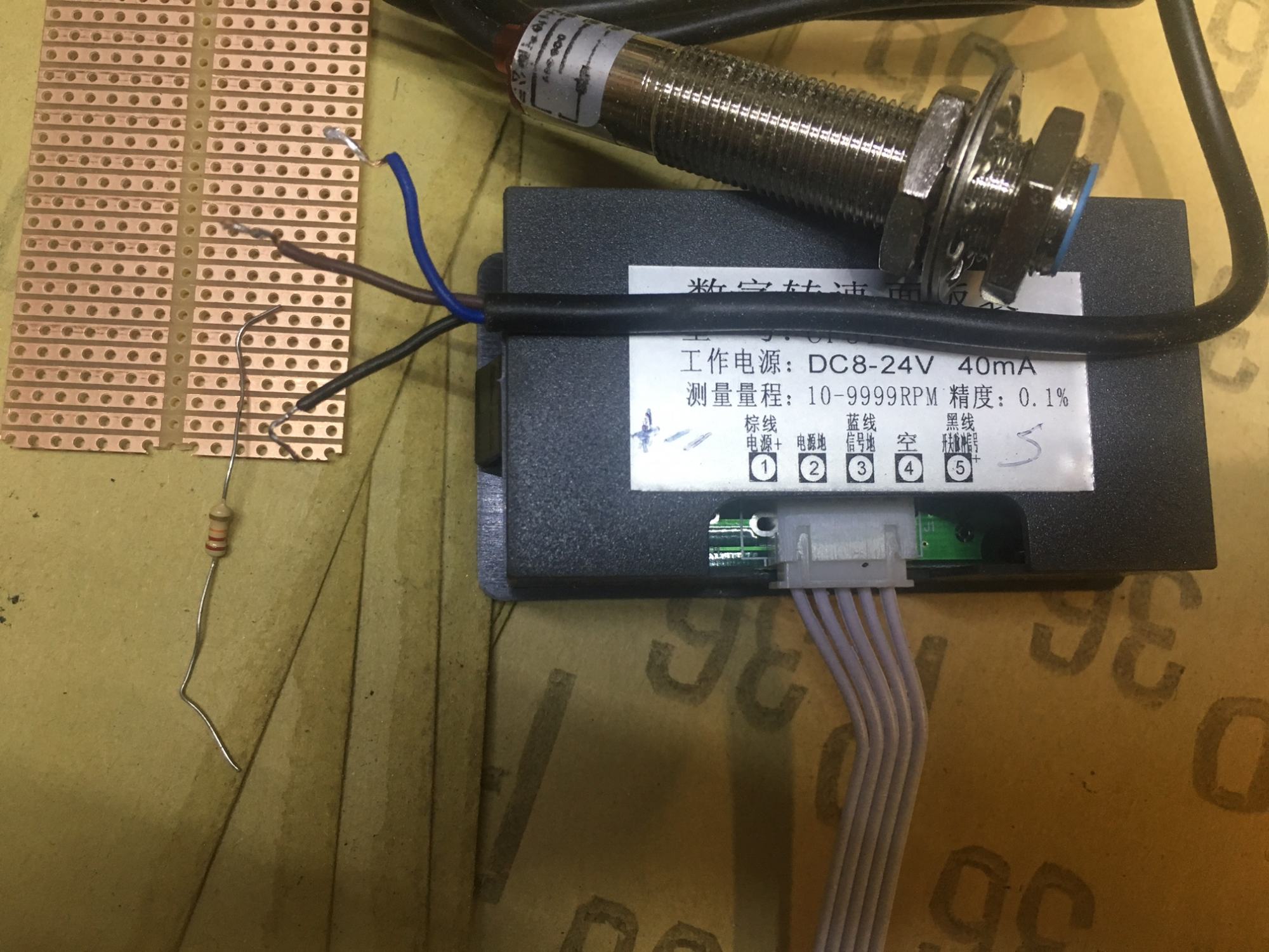

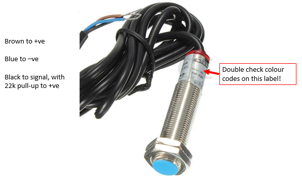

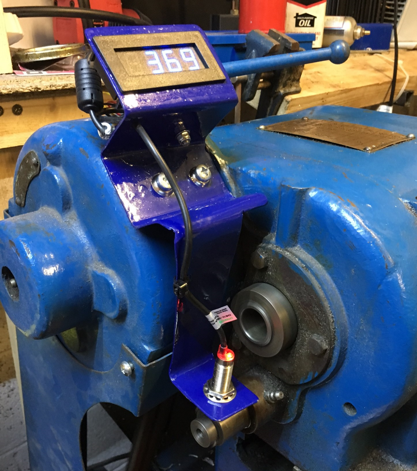

Following this thread, I ordered two of these and have fitted the first to my lathe (bringing a 1944 Denham into the 21st century
) - the second will go on the vertical mill.
Works pretty well! I suspect it will be more useful on the mill - hopefully get that done tomorrow
) - the second will go on the vertical mill.Works pretty well! I suspect it will be more useful on the mill - hopefully get that done tomorrow
didn't think of that! Oh well - it's relatively easy to unbolt the sensor if I ever need to do that!
