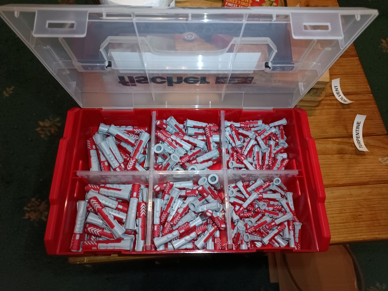

I suppose not if you're using a 16mm wall plug...
What it does give you is the option of having a female insert to take a machine screw rather than a wood screw without using a resin socket (I'm all ears to other options too!)
They are intended to bridge the gap between plasterboard and solid wall so that the wall is bearing the load, not the plasterboard.
Just sharing my experience of a good product.
i use red plugs and a no 6 drill . shove the red plug well in to the block and use 3 inch 10 woodscrews .you can get them tight enough to virtually snap the screw sometimes the screwdriver struggles to put em in .I've had to do that in the past with the old's red/brown plugs with some soft block two plugs and a very long screw.
The Fischer plugs don't seem to pull out like traditional plugs do thank goodness!

I've tried them (not that particular brand)...they either work perfectly...or they create a bigger problem. I prefer something that just works even if it take a bit longer.Anybody else had a use of them?
That's the trouble I was having, sometimes on softer material they weren't gripping and making the hole bigger, I use them quite often and had found them very hit or complete miss! I have not used resin fixings for many years and those were for bolts into concrete will have to look at it. Thanks for your reply!they either work perfectly...or they create a bigger problem.
