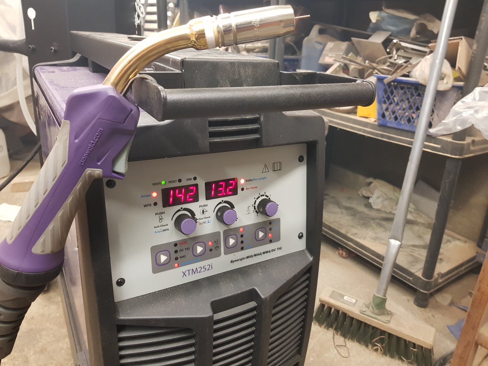

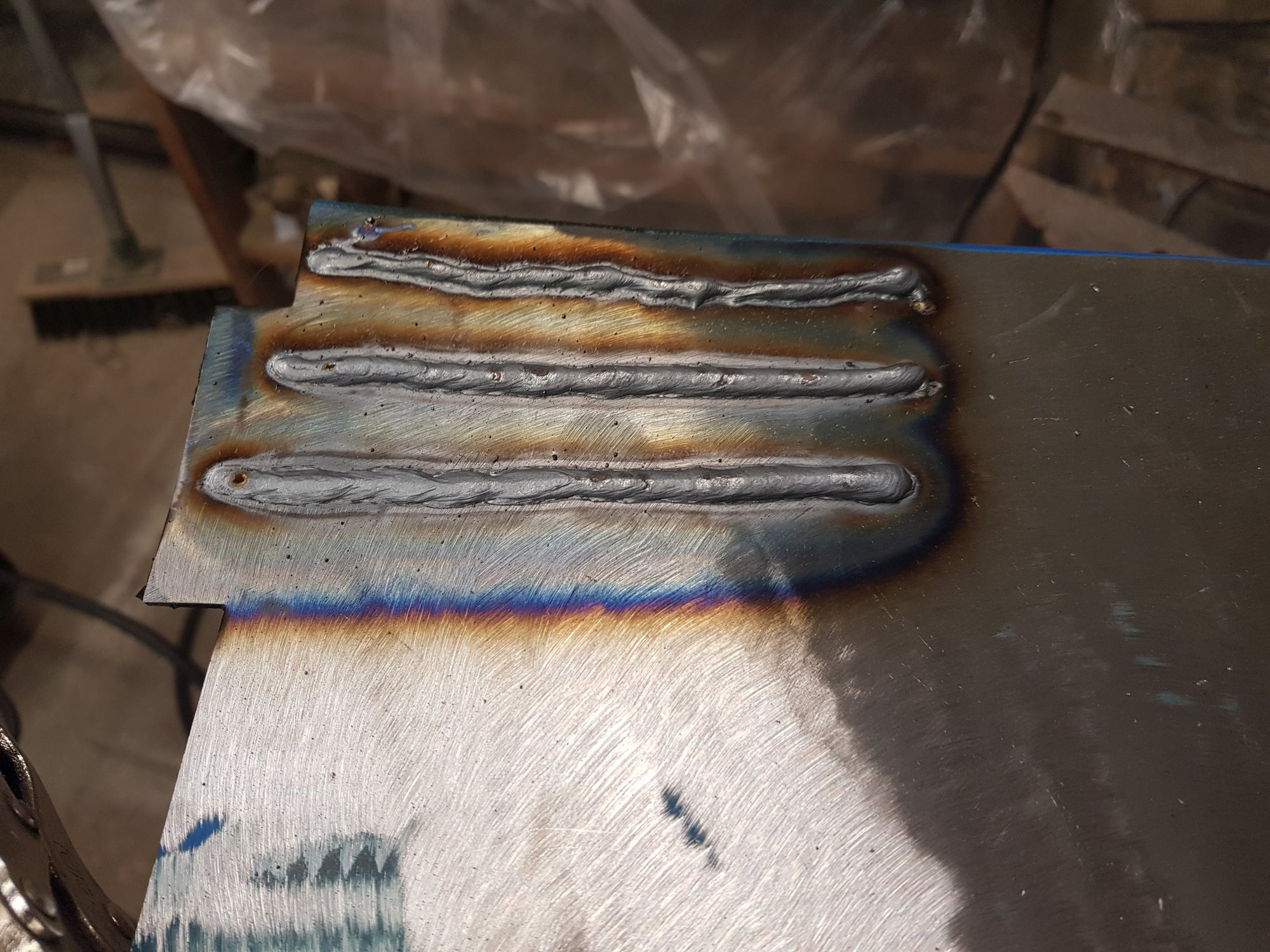

Finally got the Parweld 252 setup today and managed my first welds with my own mig welder
These 3 aren't actually my first welds, I had a bit of a play up the other end of the sheet messing with the settings.
First one was much to quick. Second maybe still a bit fast one the travel speed? Third was going quite well until about half way along you can see where the torch lead got hung up on something.
It's 2mm sheet, using 1mm wire, 95-5% gas and the synergic settings on the welder then turning them up a wee bit.
Any input will be greatly appreciated.
