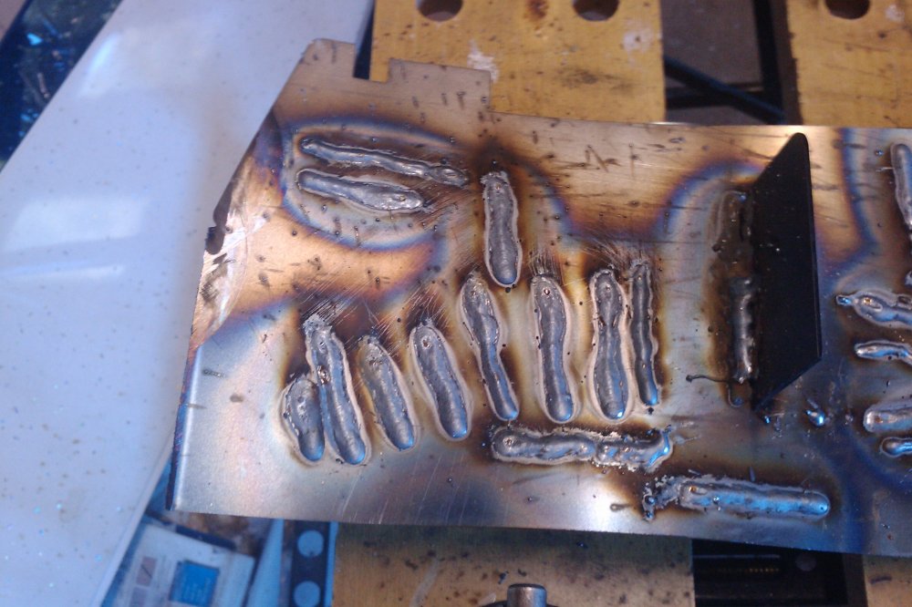

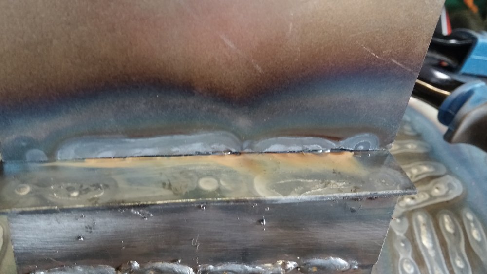

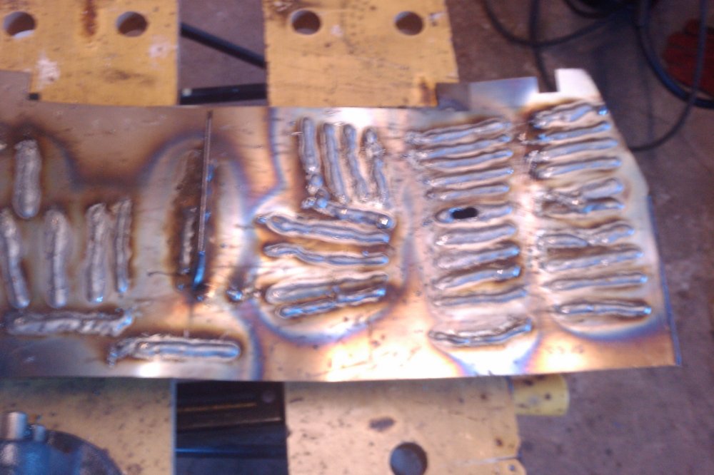

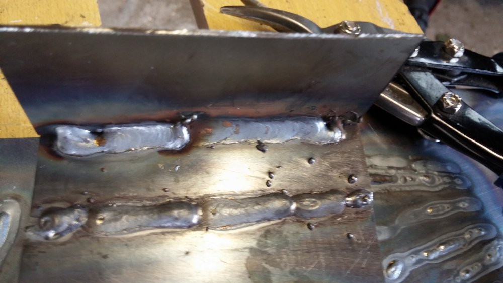

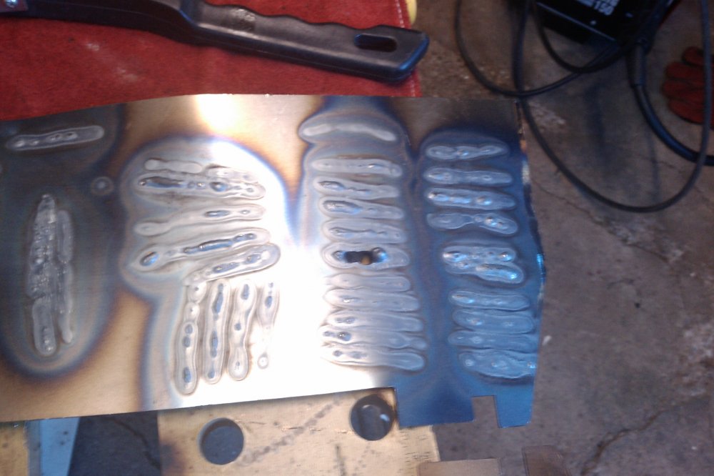

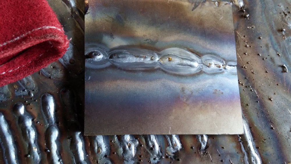

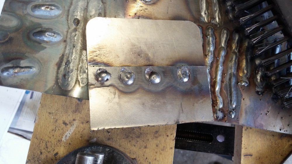

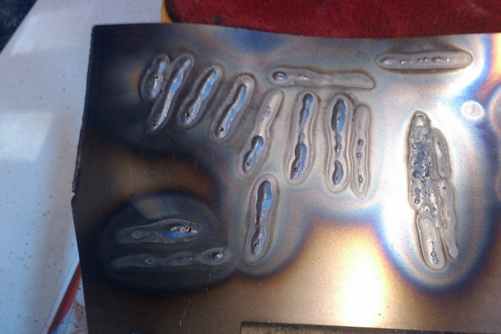

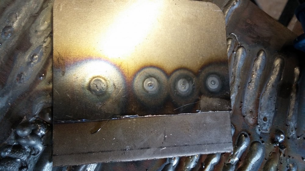

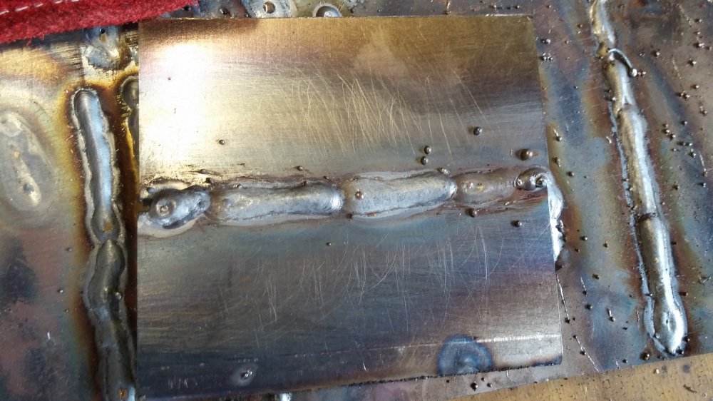

I've uploaded the best of a bad bunch
let me know what you think. I've included a back and front of each.
I had another we play with my machine and did a few different joints and this time I did all the weld straight with no weaving as advised, and I'm happy with the results as I can see an improvement from when I was first playing aboutI've uploaded the best of a bad bunch
View attachment 46642 View attachment 46643
View attachment 46644 View attachment 46645
View attachment 46646 View attachment 46647
One question though, how do I stop blowing through when I get to the end of a joint? you'll see from the photos I've stopped short
thanks again for all your help guys.
Cheers,
Geo
Why all the stopping and starting on a joint? To be fair I should if I was you get a section on 5-6mm plate about 100-150 square and just fill it with continuous welds starting along the edges 1,2,3,4 then work inside those 1,2,3,4. look to complete the job without any voids. It will get smoking hot so a big heat sink under it is good and keep dunking it in water(don't do this with working welds though). work around it without going in one direction so start 1 right to left, 2 away, 3 left to right, 4 towards etc. even swapping hands coz when your in a tight spot you often have to do this
The aim is just to make it look neat and straight all the welds running straight and just touching the last.
Then and only then move to joints, when you have that sussed and confirmed with a big hammer break test work on uphill, downhill, overhead etc.
When I learnt we had to sign our names and I really do feel my long name got me extra practice inthis tests your ability to see what you are doing and keep track of your progess.
Mig welds can look good yet perform poorly lacking penetration and forming unseen voids within the weld (not normally an issue on thin stuff but bear it in mind) , on some metals I have seen them actually come right off clean (rare but scary) even though visually they looked fine. 2-3 mm stuff though if it looks good it likely is good just don't take it as granted on stuff that matters
The advice re practice welds on much thicker metal still holds good. As you master each thickness/gauge you can progress to thinner and thinner stuff so that, when you actually start to weld what you want to join, you are proficient enough to avoid blow through and reduce warping to a minimum.
I disagree , he is going to be using different settings, arc transfer , and even technique welding squares on a thick lump of steel. He will then approach his 1mm thick joint and be just as lost with how to approach it. He would be better taking the steel he wishes to use and performing the joints he wishes to learn on until he is happy with the results. Car body welding is very rarely done in continuous runs more often than not it's a case of tack after tack . Looking at the progress in the pictures he is moving in the right direction. Well done mate.The advice re practice welds on much thicker metal still holds good. As you master each thickness/gauge you can progress to thinner and thinner stuff so that, when you actually start to weld what you want to join, you are proficient enough to avoid blow through and reduce warping to a minimum.
