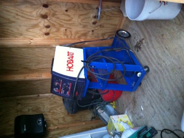

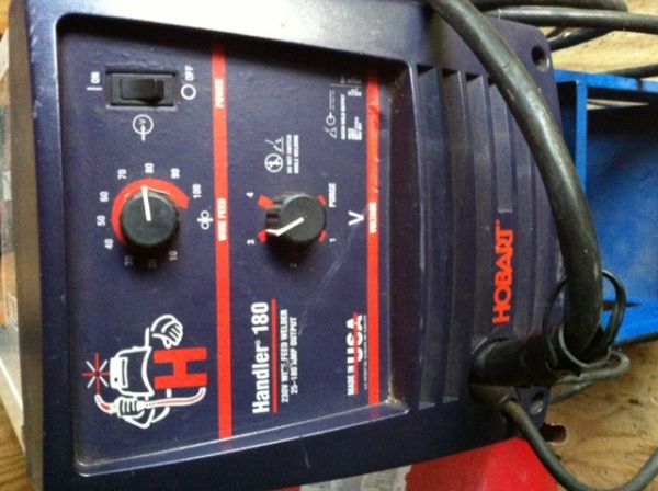

Im buying my first welder and was wondering if this second hand welder found on craigslist would be a good one to start with? Hobart 180 Comes with an argon bottle and is priced at $400. I would be welding mainly 1/4" steel.
Hi there,
If you're mainly going to be welding 1/4" steel, you'll be working at it's full capacity, for the most part. If you're mostly welding thinner material, and only doing the 1/4" every now and then, then it should be ok.
Goes down to 25A too,- which would be good for bodywork type thicknesses.
Dunno about the price, I wouldn't recognise a dollar, if it didn't say "One Dollar" on it.
Just looked those dollars up, seems to be about £250, so seems a good enough price, assuming it works, that is!
