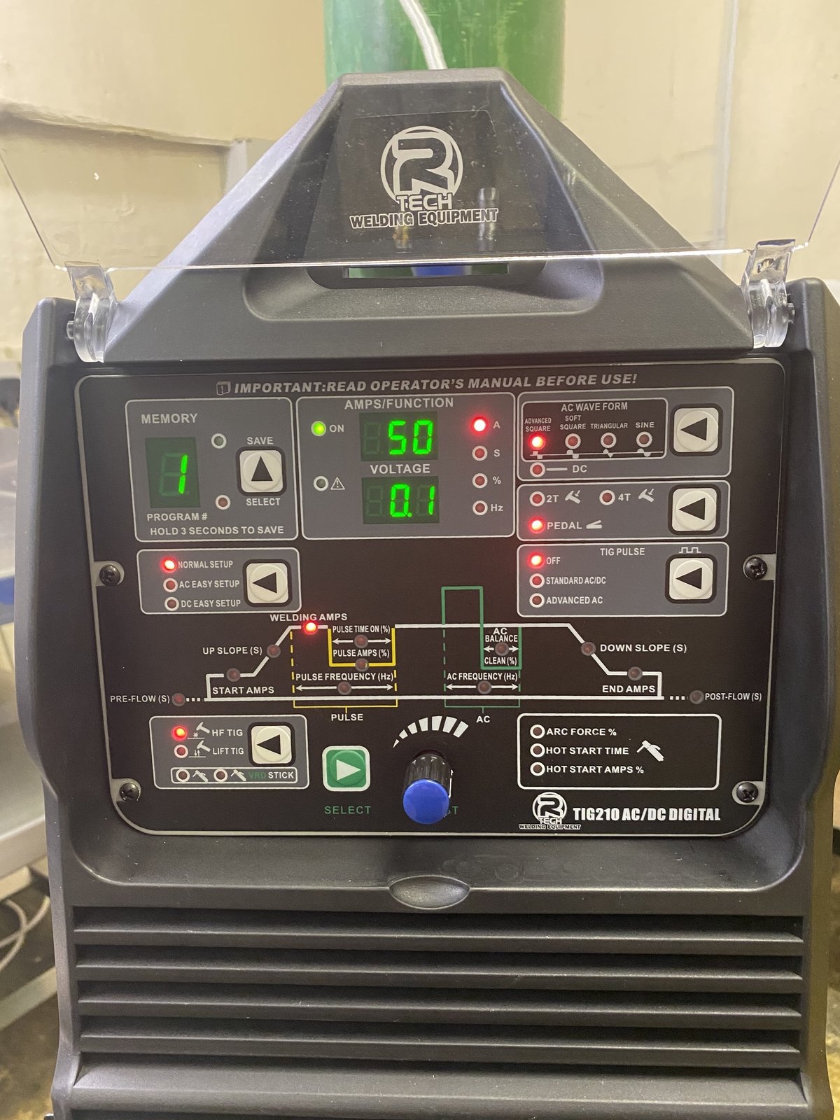

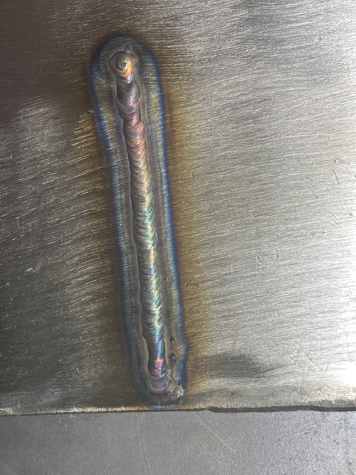

i am currently self learning or trying to I have a r-tech 210ac/dc machine, been reading and watching for months now and had the machine turn up a few days ago, no I’m expecting months/years before I can hit anything acceptable.
but I’m really struggling as everything I watch/read you all have a neat little white cone/arc.

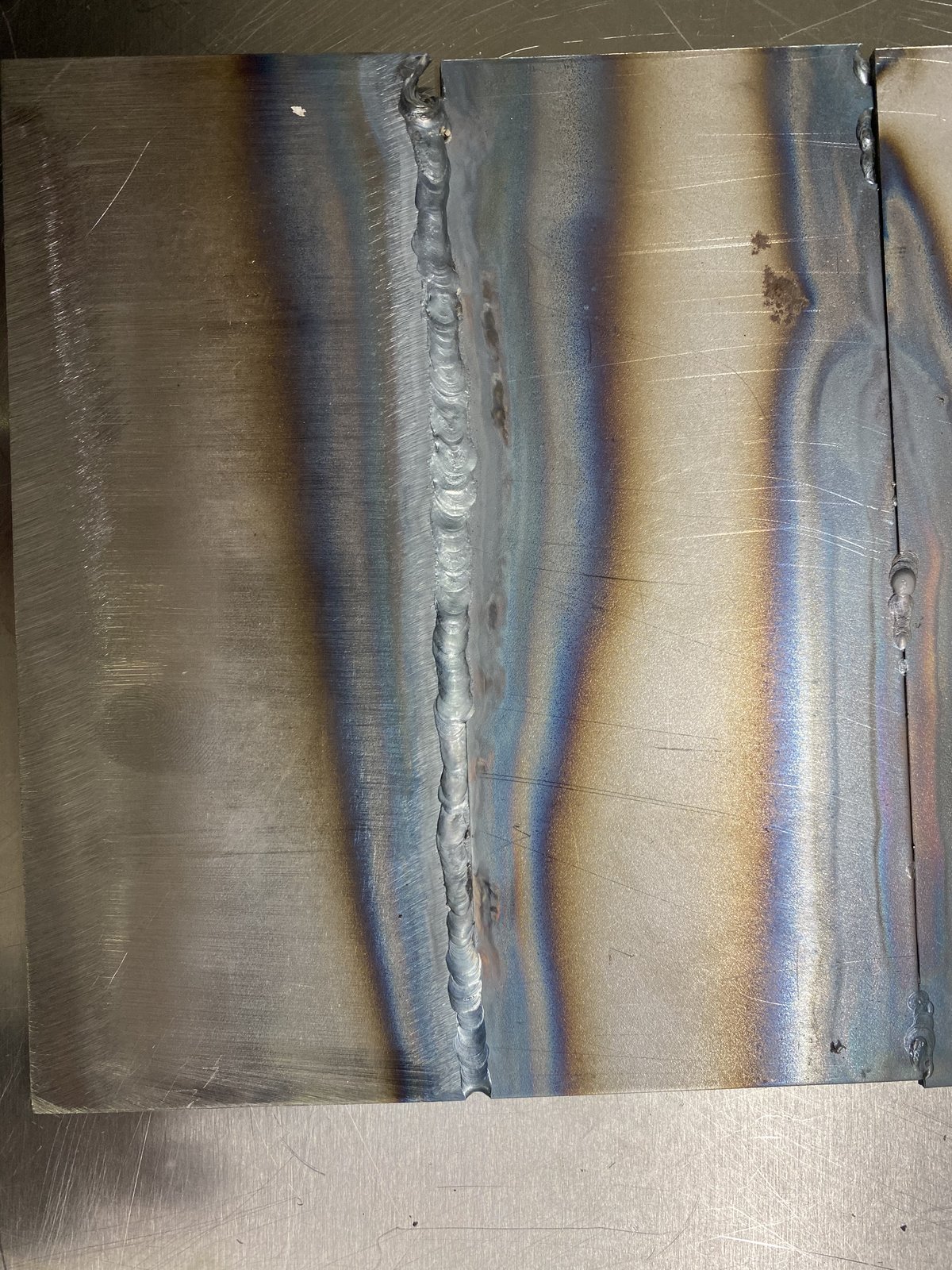

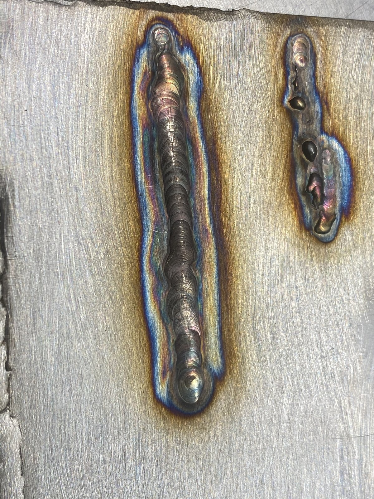

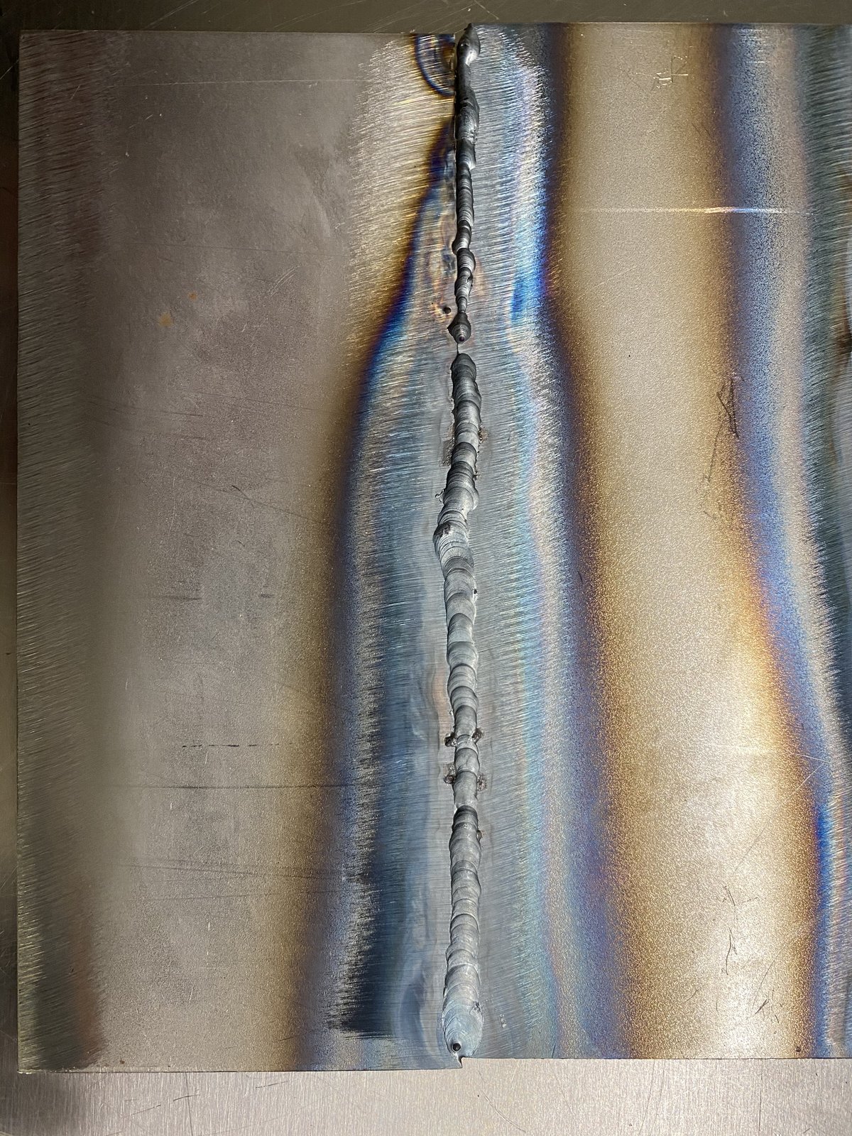

it seems to fire up fine but I never see that cone more a wondering circle/arc and never really get a puddle.
I’ve only been running beads to get the hang on the torch position
in flt 2mm steel or 3mm stainless no filler added yet.

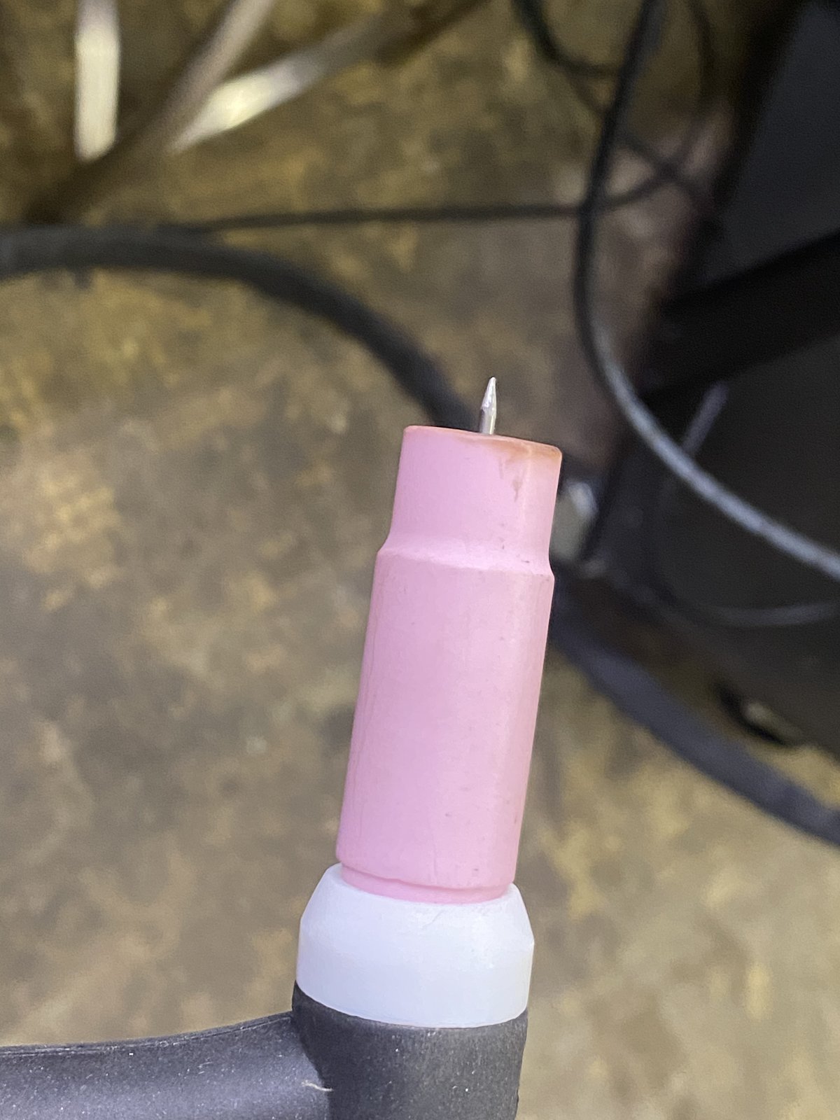

2mm I’m using 1.6/2.4 tungsten, 7/8 cup, bouncing from around 50-80amps using a foot pedal, 8ltr/min flow rate, 0.3 Pre, 5 post.
Could anyone help please

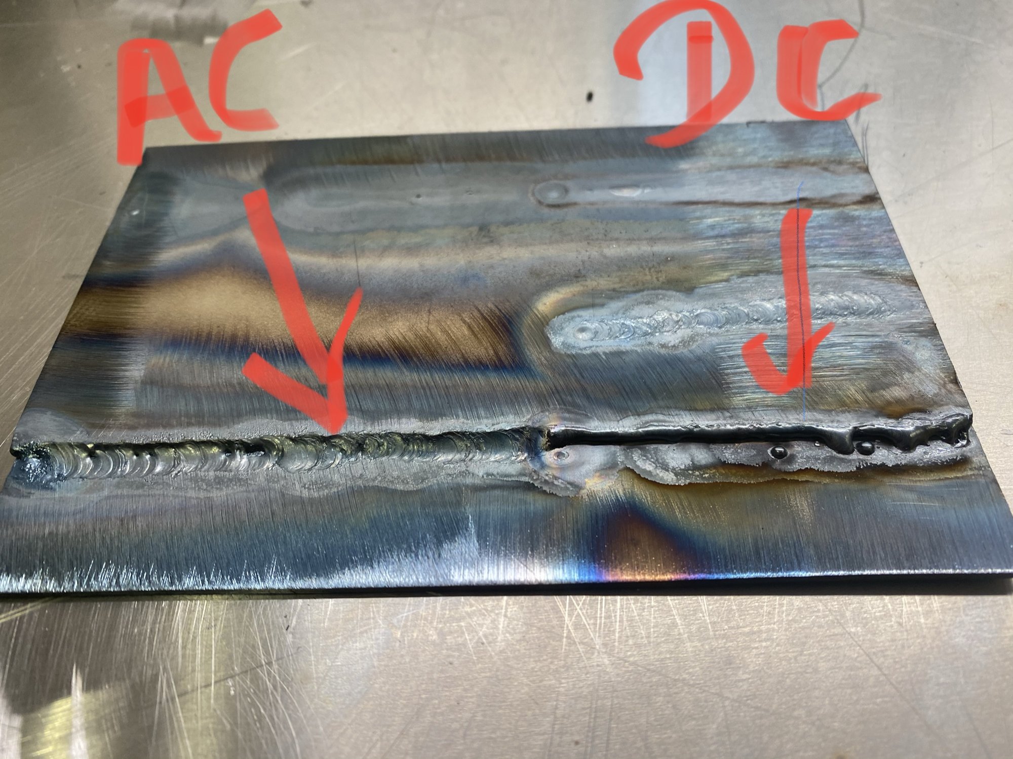

Now I feel really stupid, didn’t even notice that DC button , just ignored that button as I thought it was AC stuff.
