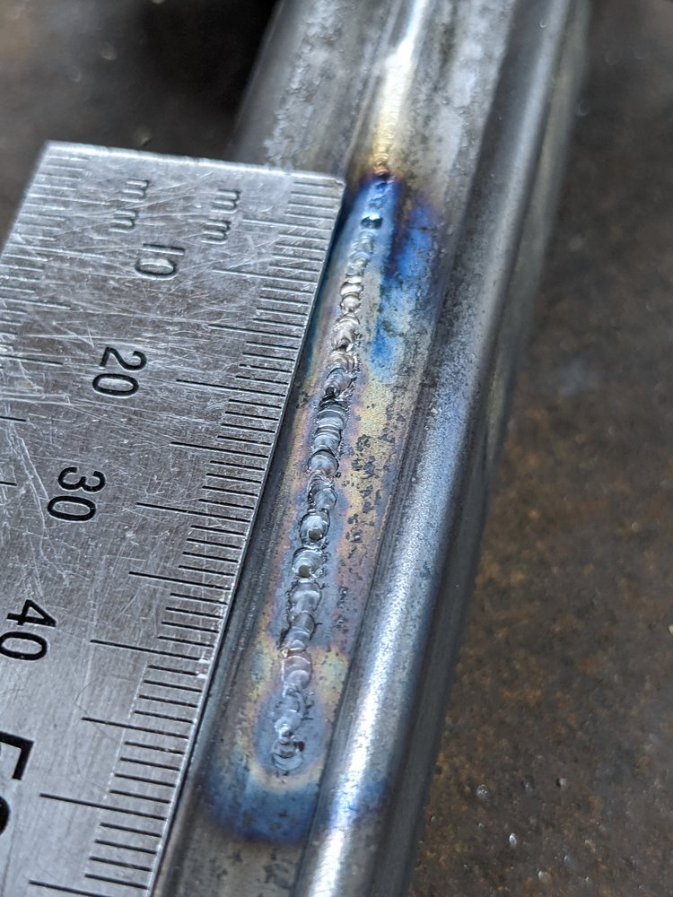

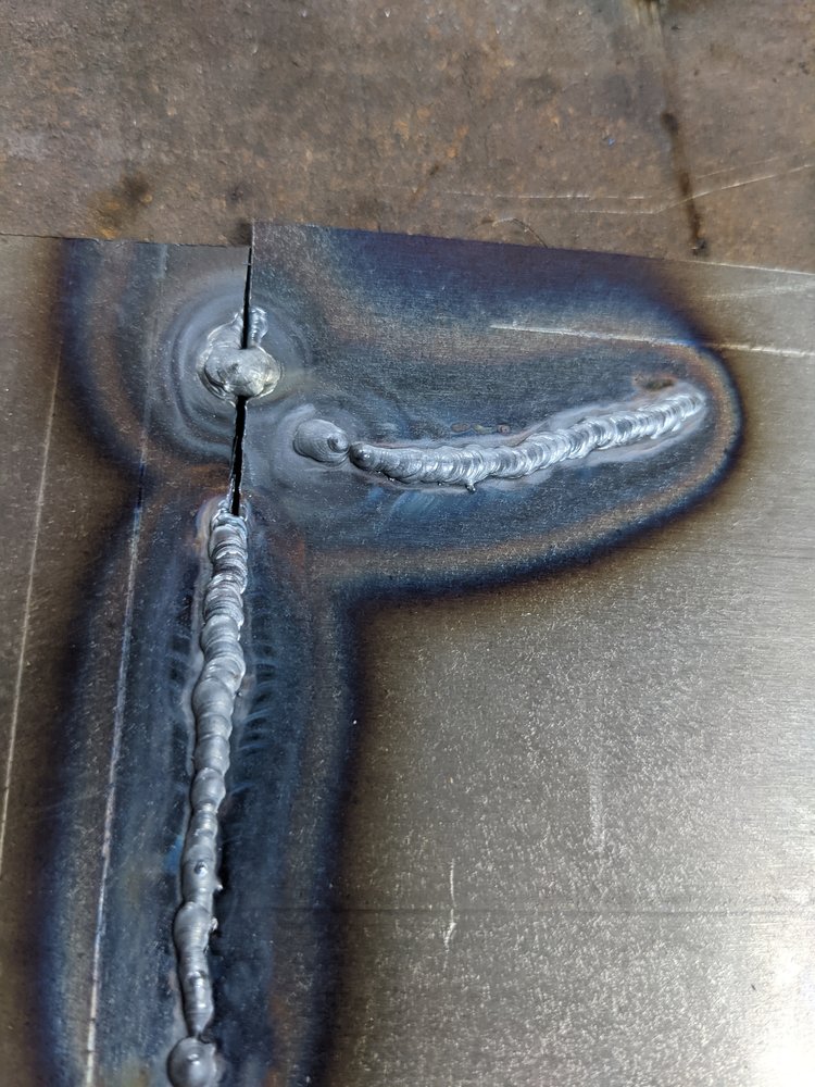

are you using the torch negative,
Earth clamp positive?
Cheers, will have to get used to a bit more prep than I usually get away with. And yeap, time and practise! Literally the first evening, so not expecting them to look great at the moment!Running down the area of the joint with a flap disk or grinding disk, until it's shiny, shiny will help.
But you're getting there...
Takes time and practice. I'm no expert. I'm an amateur.
