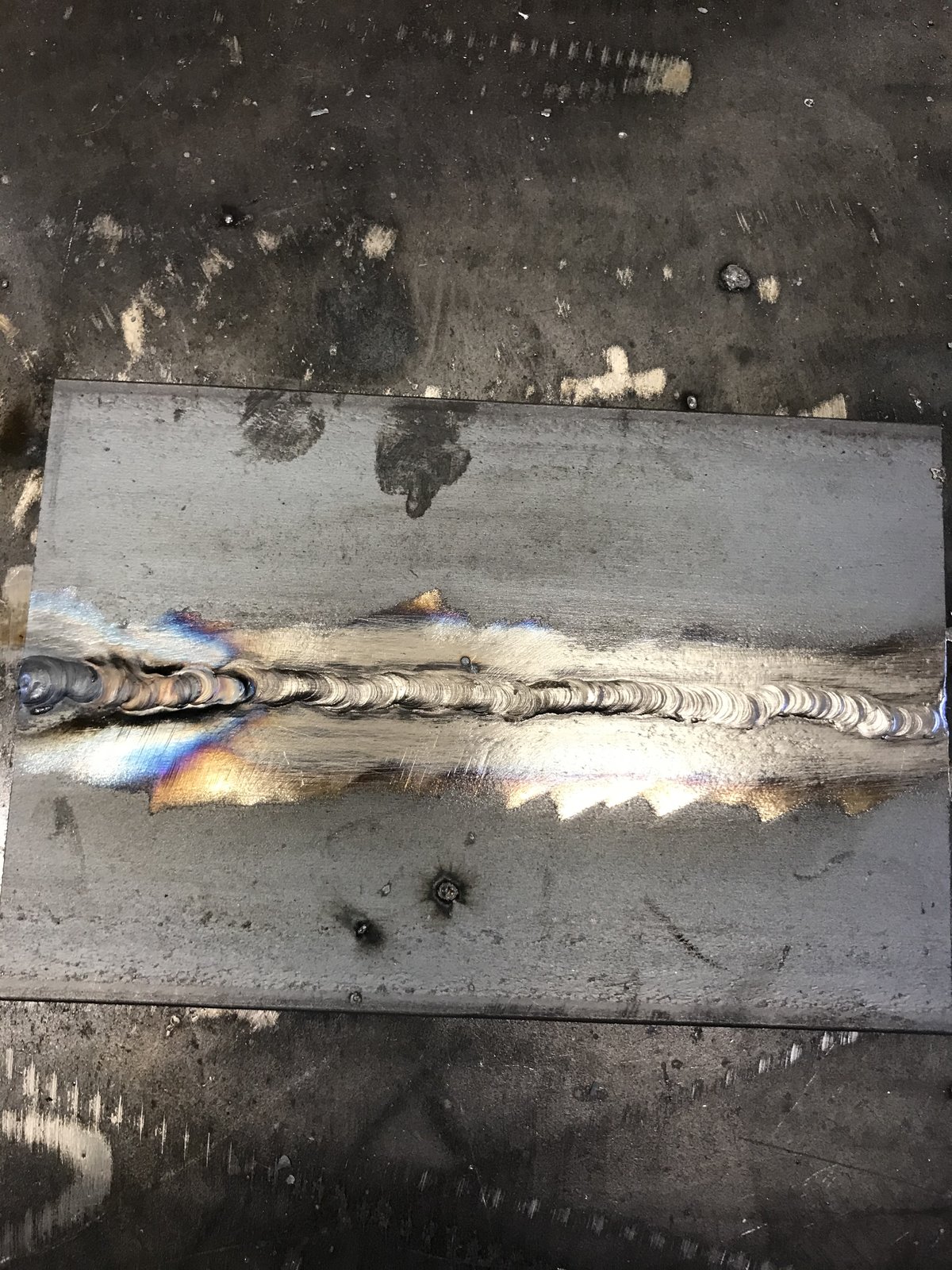

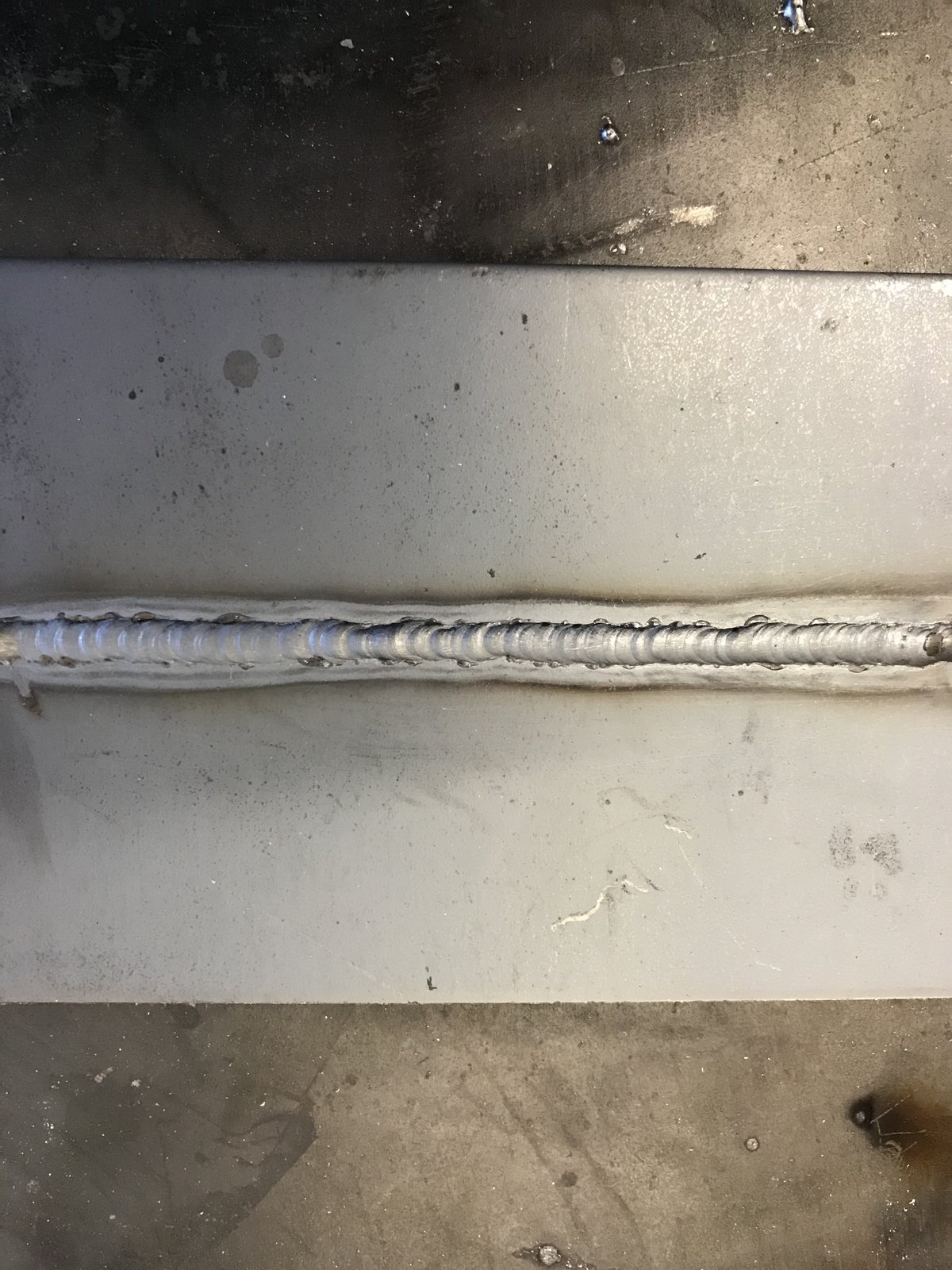

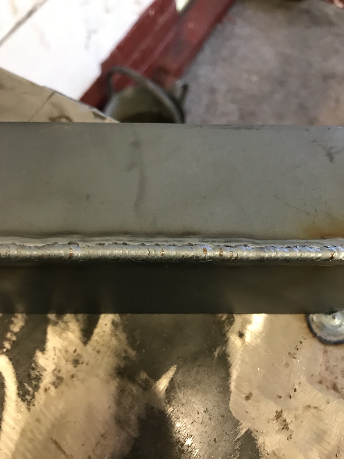

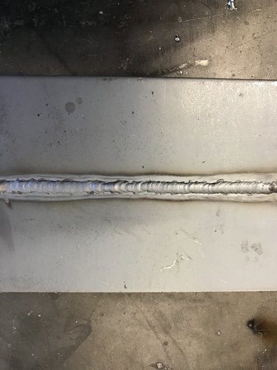

Wasnt too bad the pen,i think the butt was 115A and the corner was 90A,yeah its not the best mate just playing around but il get thereLooks a bit cold, I would probably run a 3mm closed square butt at around 110 - 120 amps, and just a little less for the corner, either 1.6 electrode or a 2.4 ground to a sharp point and a 1.6 filler, keep the torch fairly steep, no more than 10 -15 deg from vertical, and keep the arc very tight, practice the torch movement through the length of the joint, it looks like you got hung up and had to stop, then restarted with a different torch angle
Its not too bad though, I've seen worse, whats the penetration like?.
