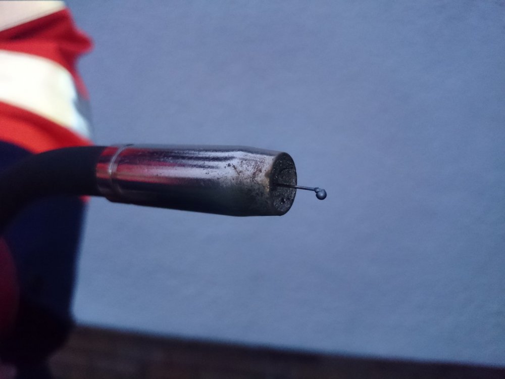

Spent some time today playing with settings and getting myself comfortable with some 1.5mm sheet. I started with Clarke recommendation of 1 Max for 1-2mm sheet and tweaked the wire speed until I got a nice sizzle.
I cut my sheet in half and tacked it back together using the thin sheet technique, I changed the settings multiple times throughout the line of welds which will explain the different looking tacks, elsewhere on the sheet I was just testing different settings.
Here are some pics
From these pictures Im sure you already have things to mention but 3 things that stood out to me were;
1. Balls forming on wire: appeared to get better when I increased the wire speed but occasionally happened
2. The welds seemed pretty sooty to me, I was doing the work outside but there was 0 breeze, I was making sure my gun angle was around 20% from perpendicular at all times.
3. Poor penetration, when I counted to two in my head I was getting close to 0 penetration, but with a count to 3 I was getting a moderate amount. My power setting was fairly high at 1 max, how could i change wire feed to improve this or should I just continue to arc for longer?
I would be over the moon if I could get some pointers, on a plus side I have tried pretty hard to break the sheets in two and failed so I cant be doing too badly
