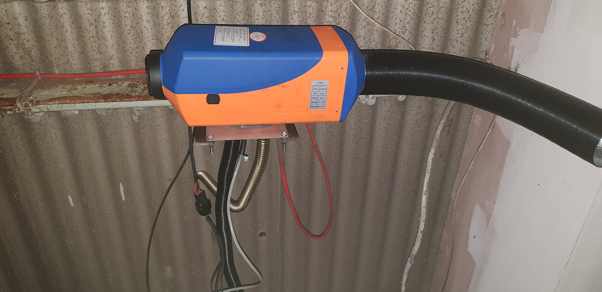

Well fired it up for the first time today.

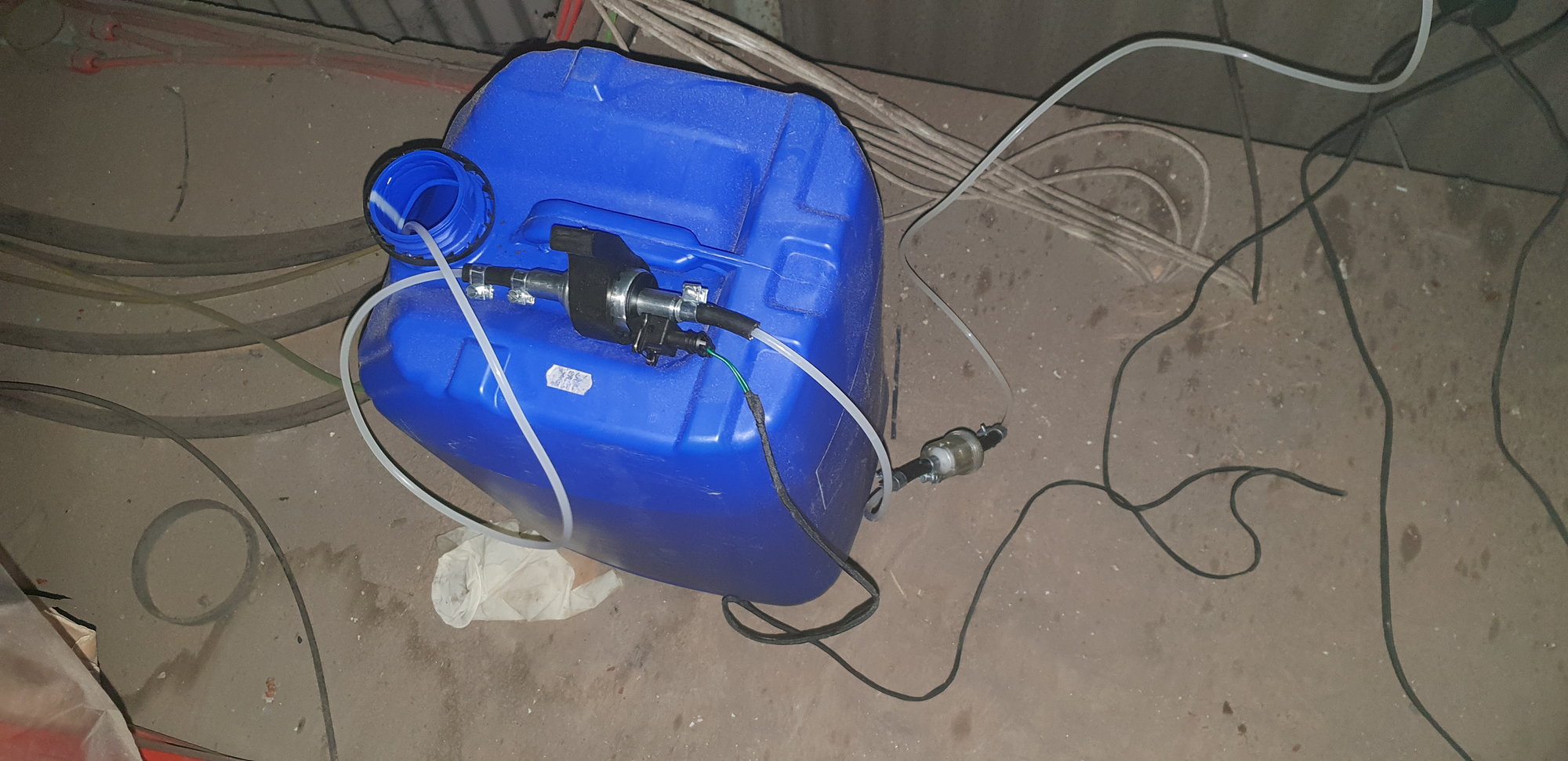

Took ages to purge air out of the fuel line - filter needs to be upside down like photo.
Obviously this is a very temporary lashup. I have ordered a proper 30L tank.

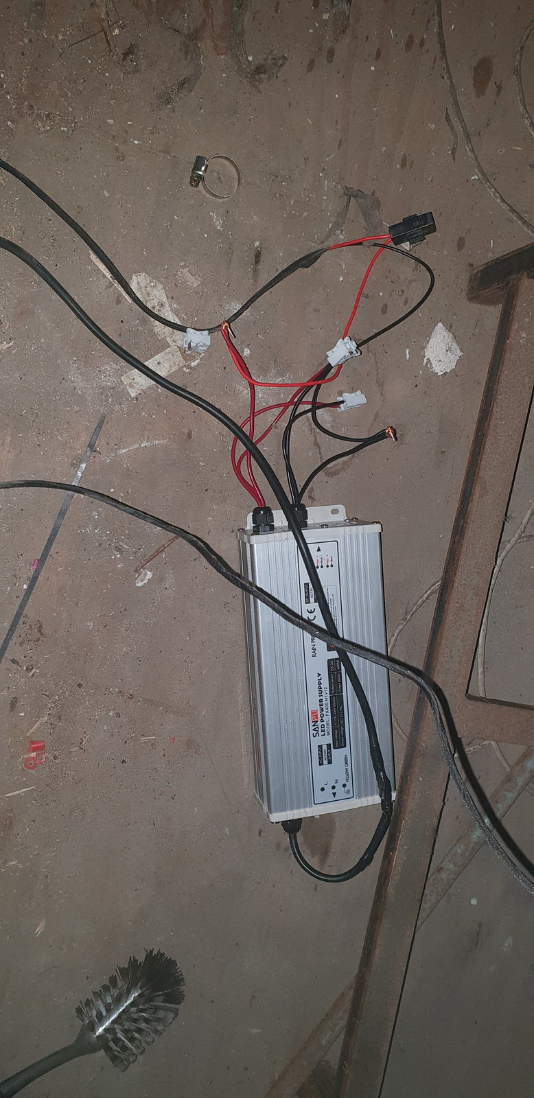

The start up currect is 10 amps - melted the connectors. Will hard wire it with solder and heatshrink.
Exhaust is VERY noisy - even though it is outside. I will install the silencer included.
