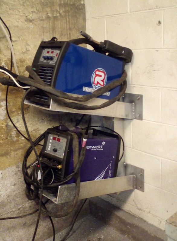

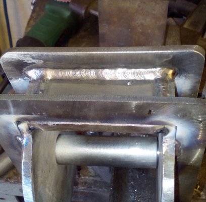

Had the R-Tech for a month or two now but only used it on small weld runs such as the wall bracket for my welders below.

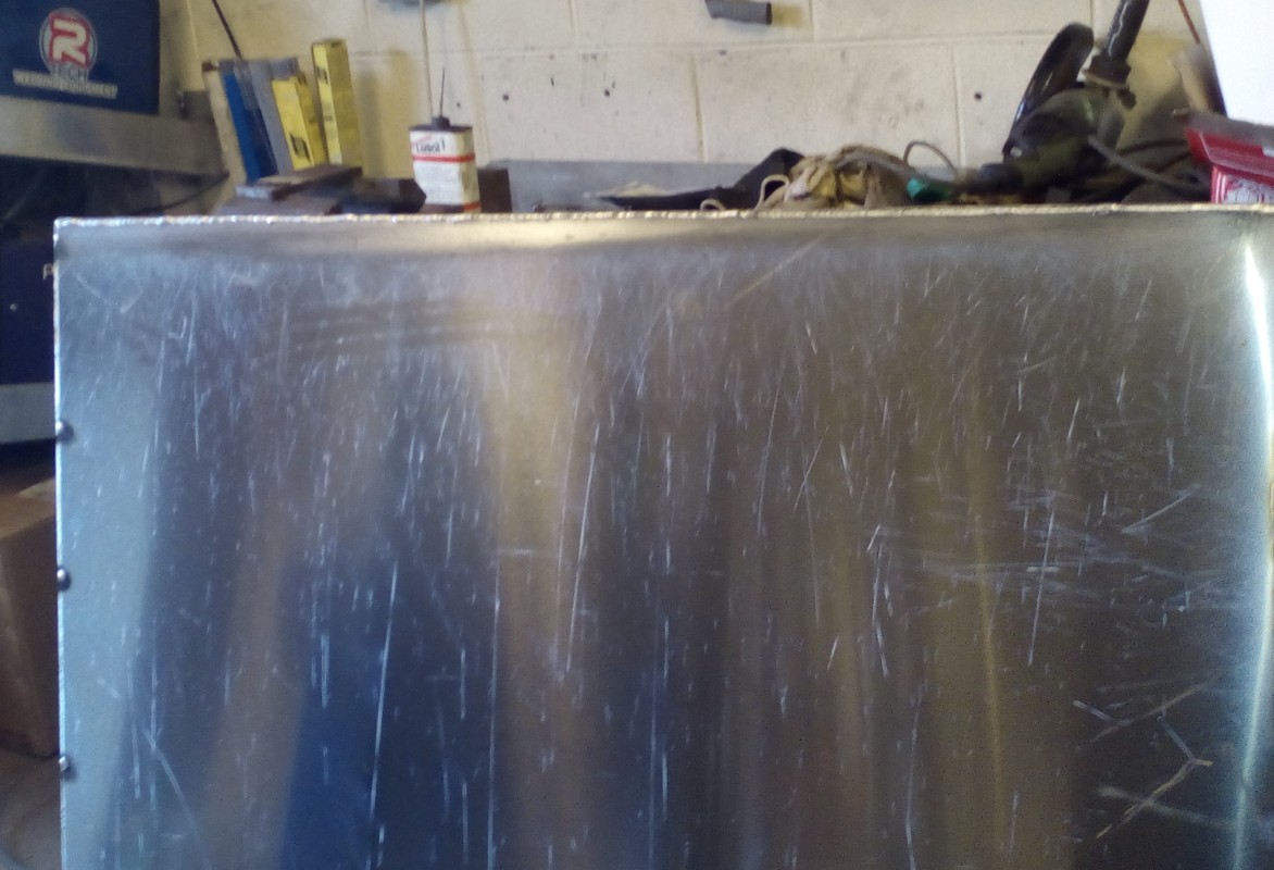

Today however I had a tray to weld up in 4mm 5083 alu, tray measure 1.5m x 1.1m with a 120mm edge and I used almost 2 rolls of 1mm 5356 wire.
Happy with the way the welder performed, handled it no problem at all. Next job will likely be welding extensions onto the Alu pods on a Cheetah Cat for extra long shaft 60 Hp Outboards, it will be 6mm Alu so that will be a better test.

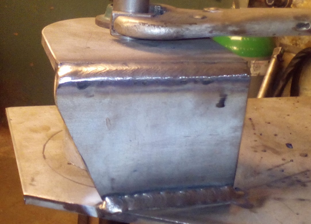

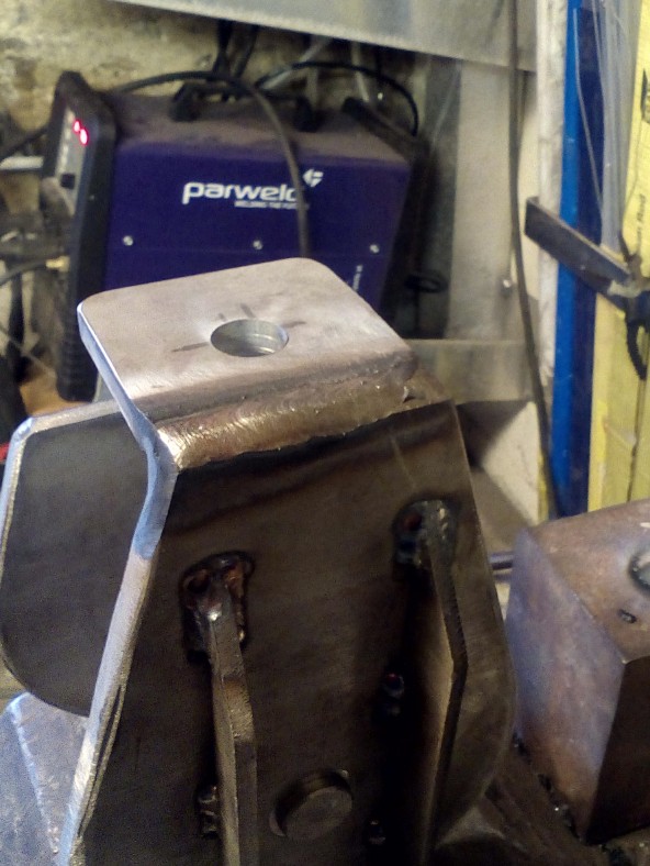

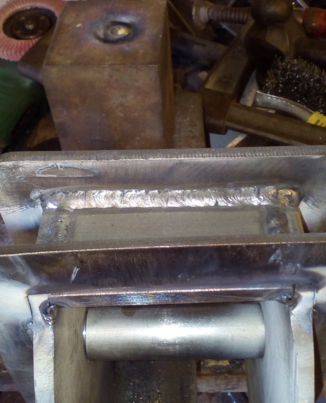

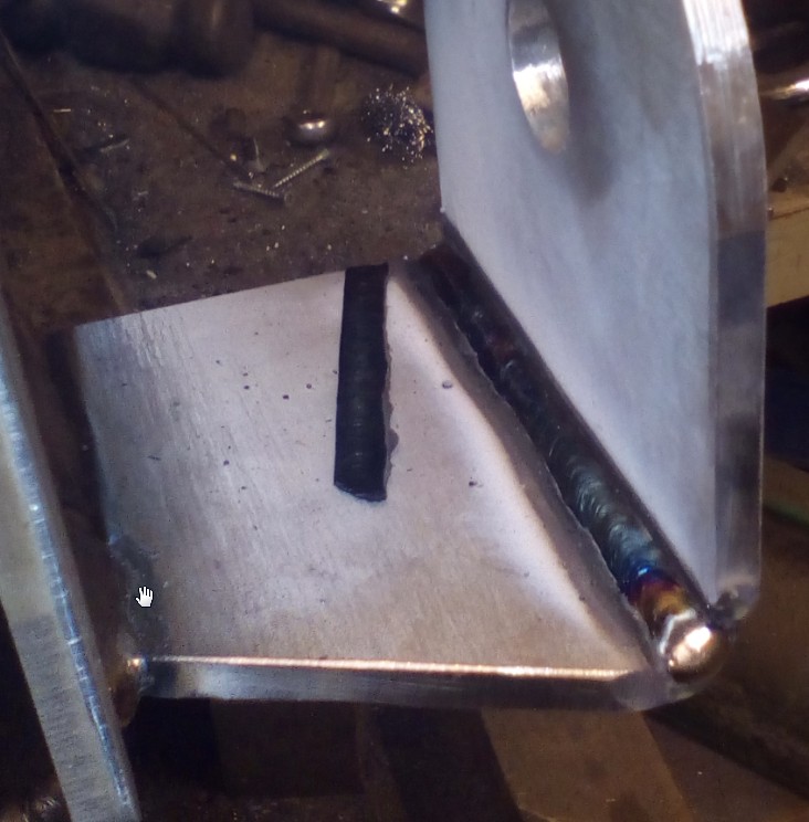

Anyway here is a couple of pics of the welds it was putting down today.
I just need to get a decent bench made up now so that jobs like this don't involve me crouching on the workshop floor, my knees are knackered
