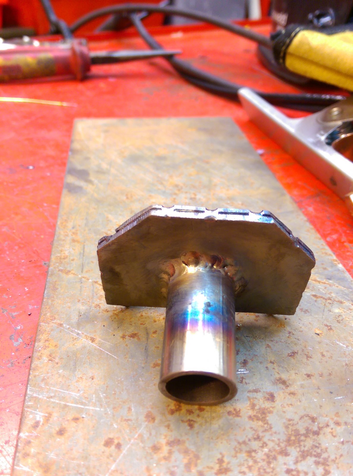

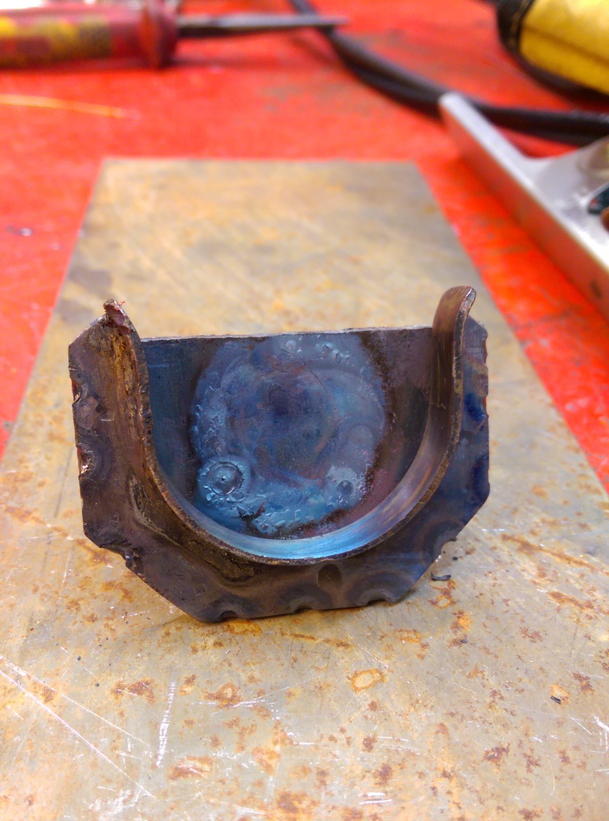

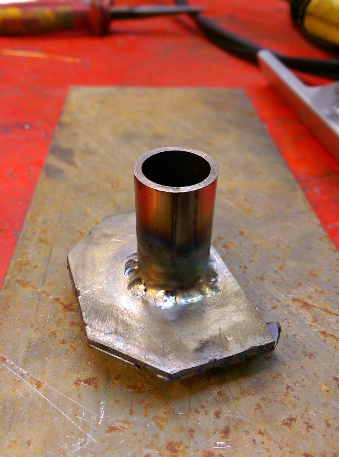

What do you think?
Be gentle!
It's part of a petrol tank mount I'm trying to make.

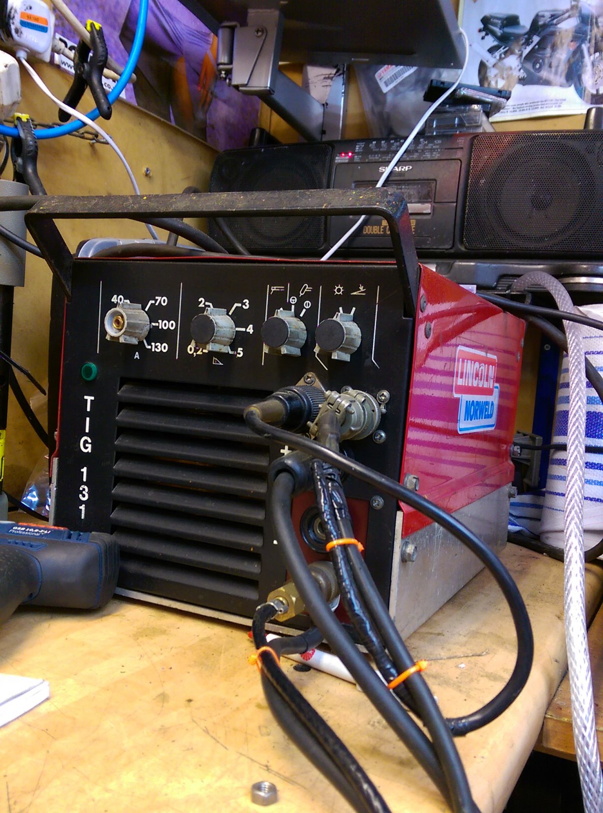

55 amp max on the control with a foot pedal. WP9 torch.
2mm plate and 1.6mm tube.
I was using a 1.6mm tungsten, no6 cup, and 1mm filler.

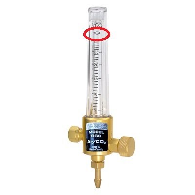

I think I was using about 6 litres per minute on the gas but I don't know where to take the reading on my flow meter, top or bottom of the little floating gauge?
I used 3 tungstens, last one is still untouched.....
I've got an old Lincoln Norweld DC machine.
