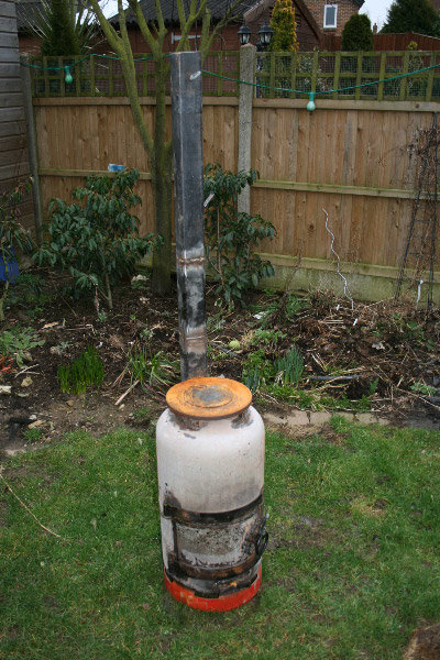

I've had the Mig since Christmas and have finally finished my first project!

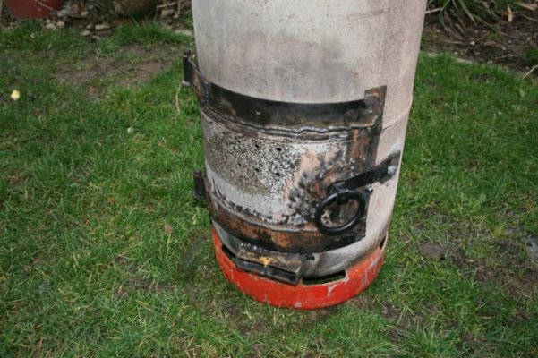

Gas bottle burner. 4" box chimney made from some old metal gate posts. Hot plate is a Pug 106 front disc. Hinges and latch are left-over fencing bits (I'm a landscape gardener by day).

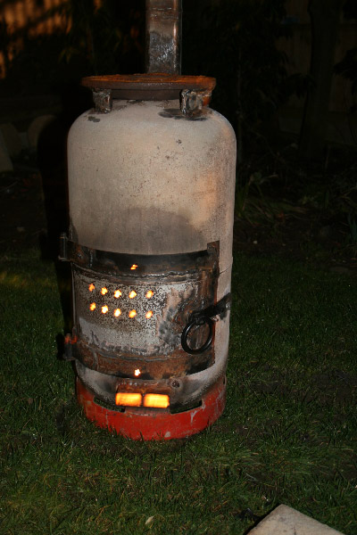

First firing wasn't too good - the fire went out! I added some box-section vents and the front and drilled holes in the door. I also extended the chimney. Now it seems to work!
Gives-out a decent amount of heat. I've made it for a mate who has got some woodland and needs this for when he and his family go camping up there.
