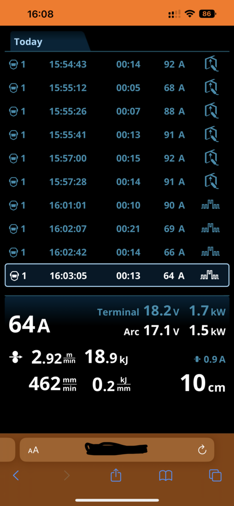

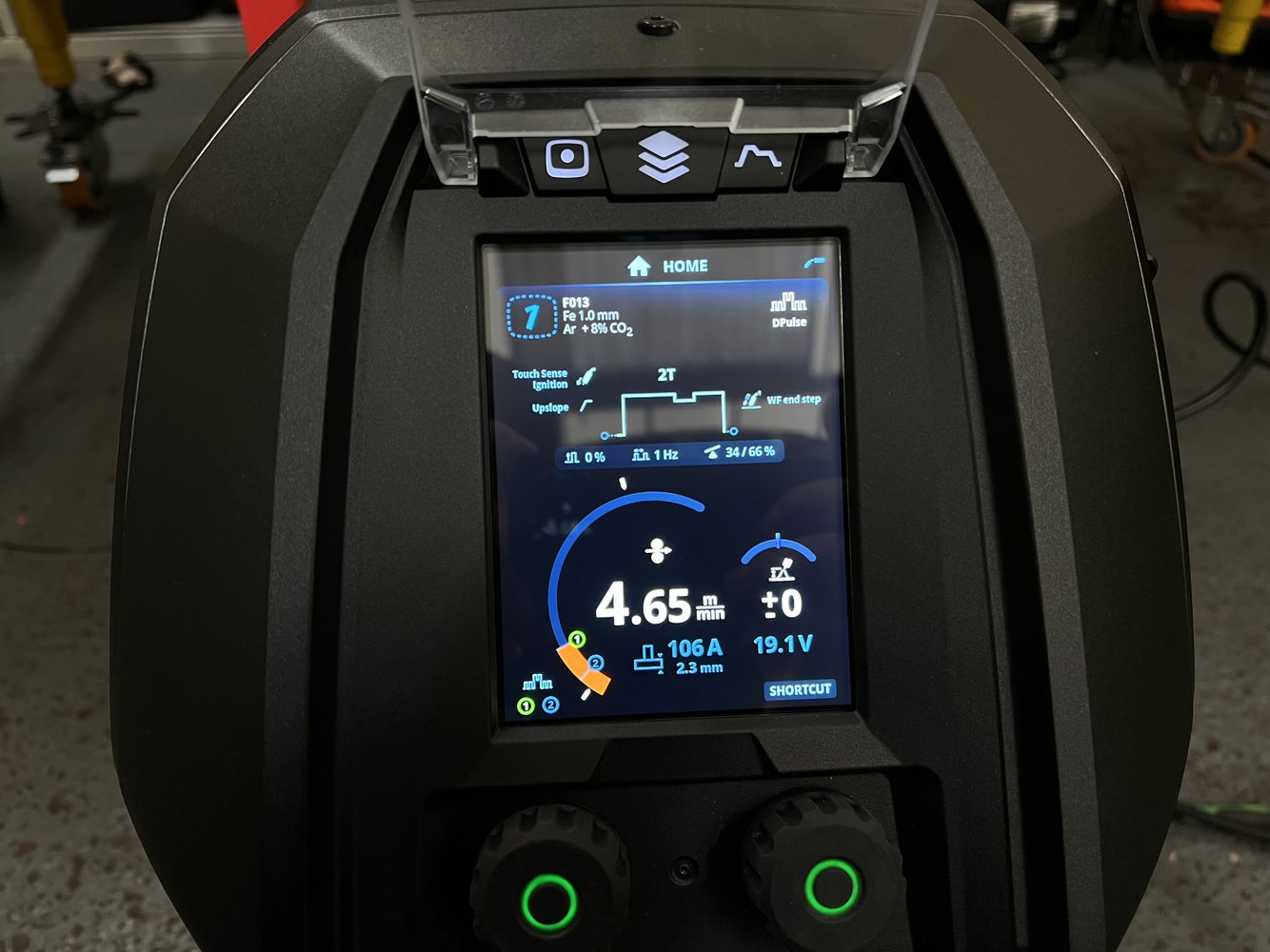

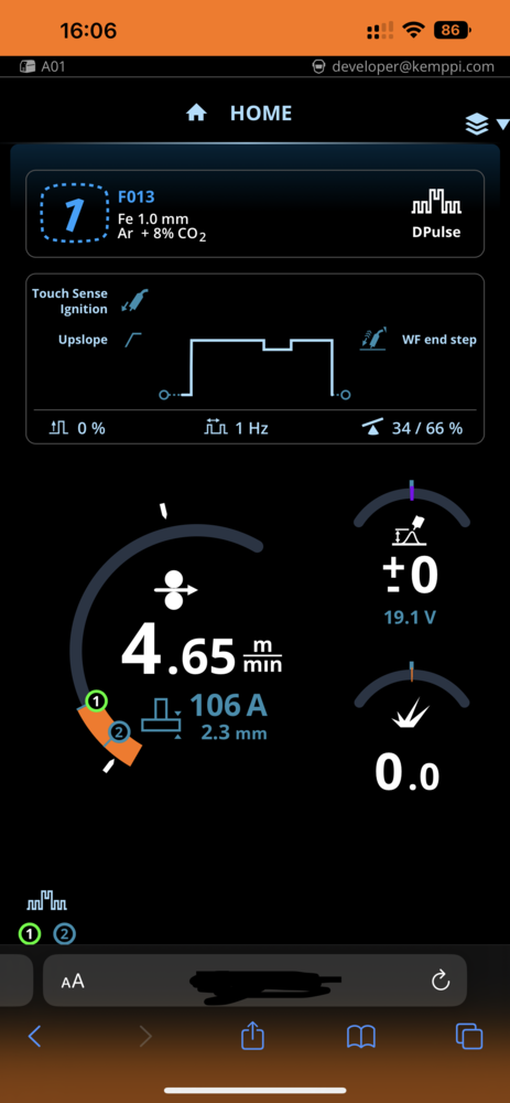

The TFT screen is very nice, in fact its luxury imho, and once the machine is connecting to the wifi (yes built in wifi.. whatever next) you can go to the IP Address of the machine and control it over the air remotely.. fully ridiculous and amazing if you ask me. Almost no lag and the phone or tablet that you can connect can be used as a live read out of what your doing.. you can then can review your welds details as they are all saved i the history of the machine.. I could easily put this machine in the corner or under the bench and just control it remotely which is fantastic.
One feature I do like.. is at the end of the weld if you enter how far you welded in CM, it will then tell you your welding travel speed, which is cool as it gives you a bit of a reference if your racing along or too slow... nice feedback feature if you ask me!

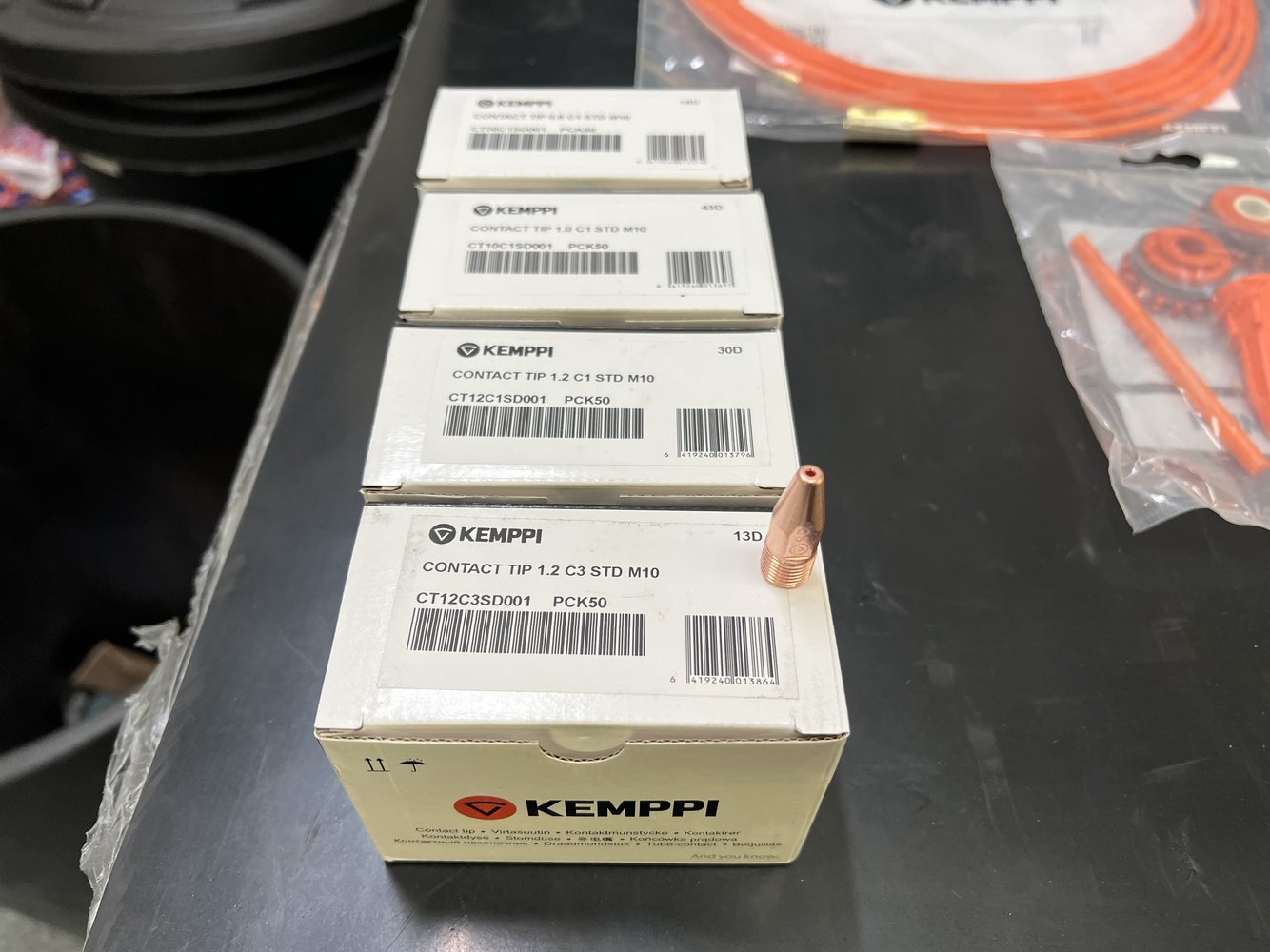

Just everything about the machine screams quality, but you do get what you pay for at the end of the day, I get its not cheap, and the consumables are eye watering expensive (I think the tips are £1.40 each, and those are boxes are 50 on the table... ouch!)

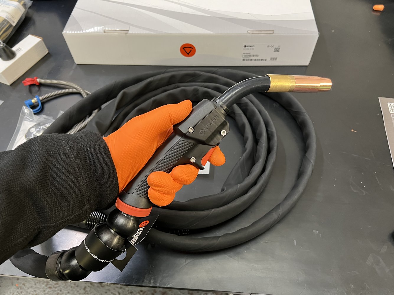

The torch is lovely, its such a quality bit of kit, I have never had a water cooled gun before, so doing a weld and stoppign and being able to touch the end is and its cold is mental.. They do sell a 5 series 400amp gun for this machine but I opted for the smaller 300amp unit, which actually is no bigger than my small FE25 that came with my RA 253A and has the smallest consumables.
