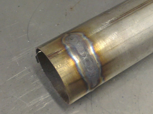

So I bought a TIG welder this weekend and decided to have a go at some welding. Not strictly my first ever because I had a little go on one a couple of years ago that was set up by the owner but this was all my own doing. I did an autogenous weld around a piece of stainless tube which was cut most of the way through. I think I had the amps a bit high and maybe the gas a bit low as I got a lot of heat in it and turned the work black.

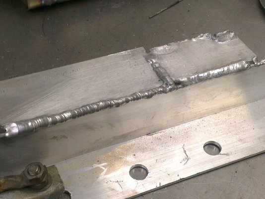

Second bit was some 4mm thick ally angle on AC. First run was autogenous from far right running to left. Next was a filler run that got a bit hot towards the end and I couldn't keep up with the filler. Then the last one was a small butt-weld across with filler, that I think I turned the amps down a bit too far for to compensate for the heat in the part.
Anyway, that's my first TIG welding. Thanks to Windy Miller for lending me his bottle of argon so I could check the machine works and have a play. Just one problem I have now is I've sunburnt one side of my face despite having the mask on the whole time. I think it's reflected off the bench and filing cabinet to my left.
