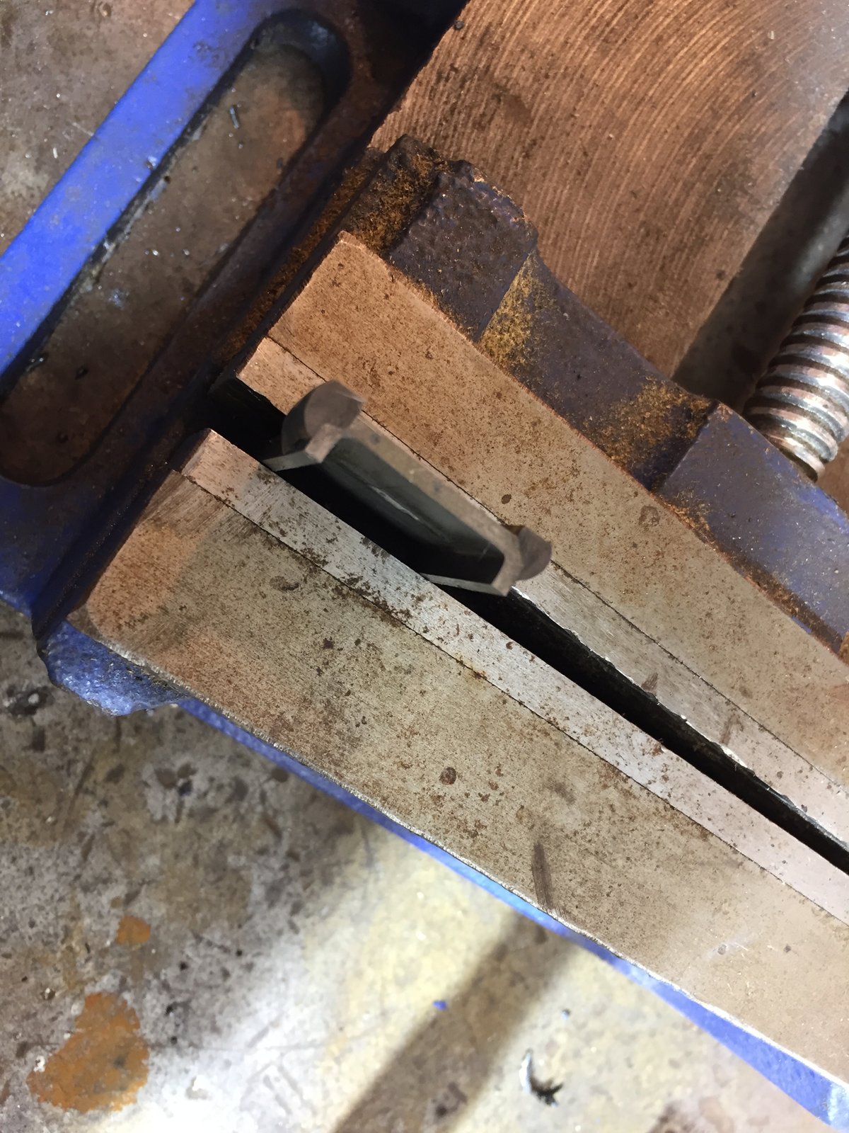

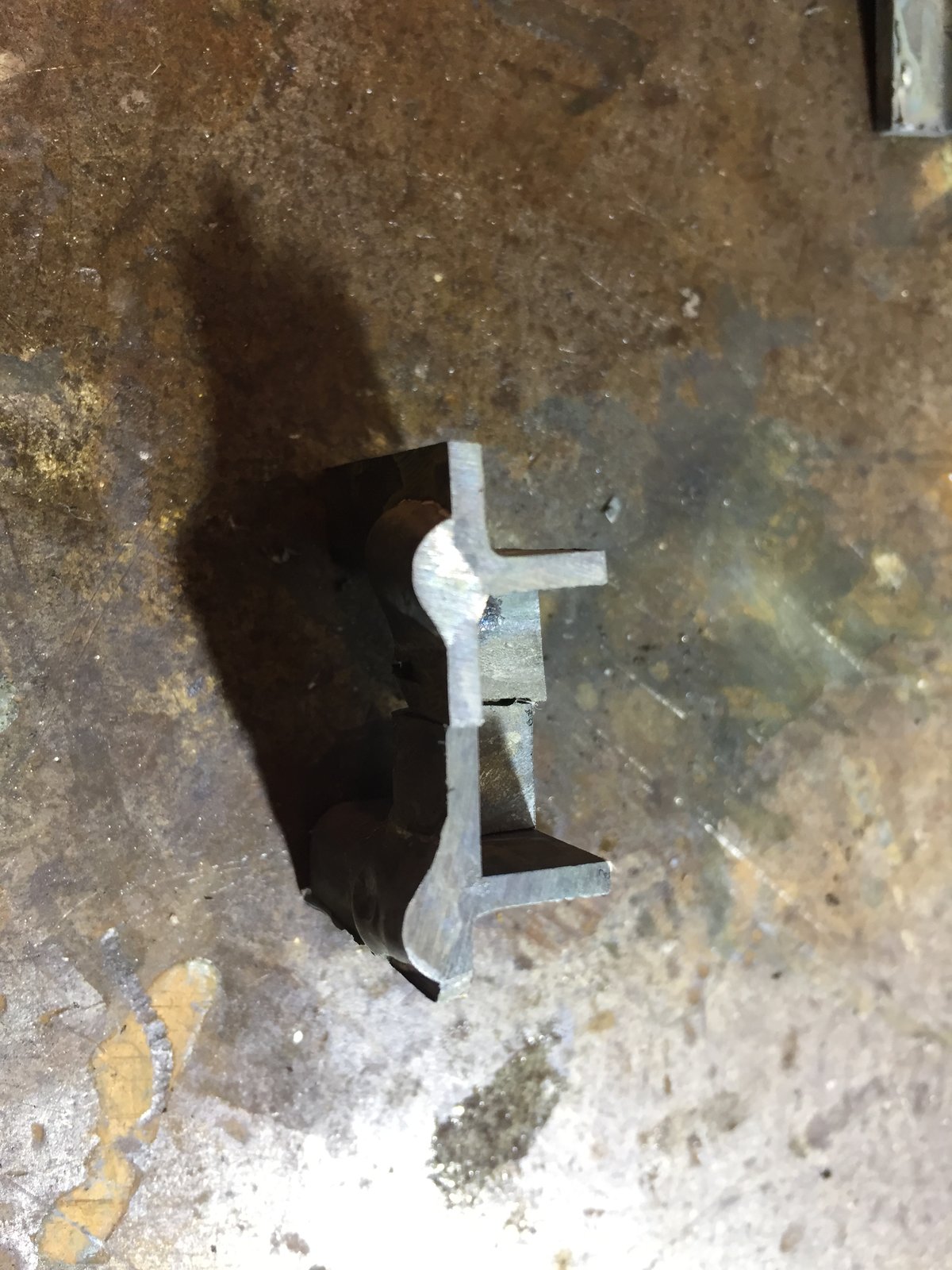

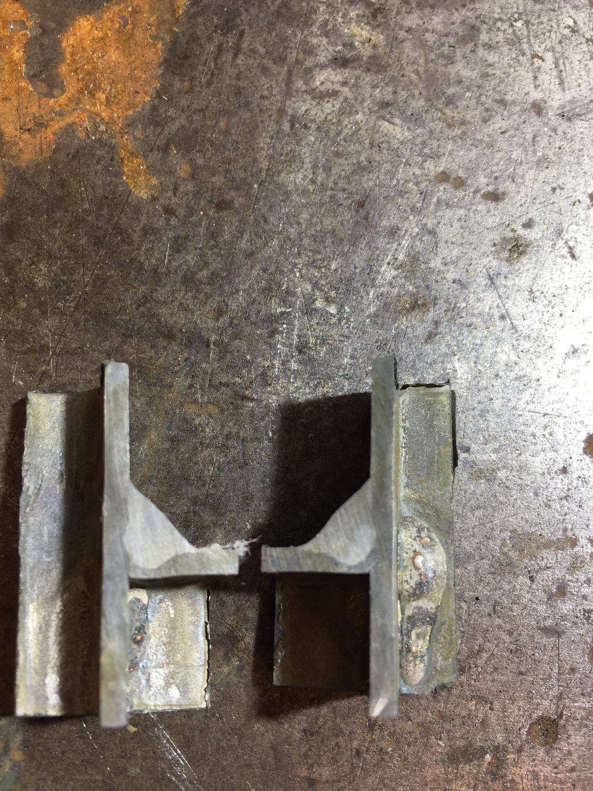

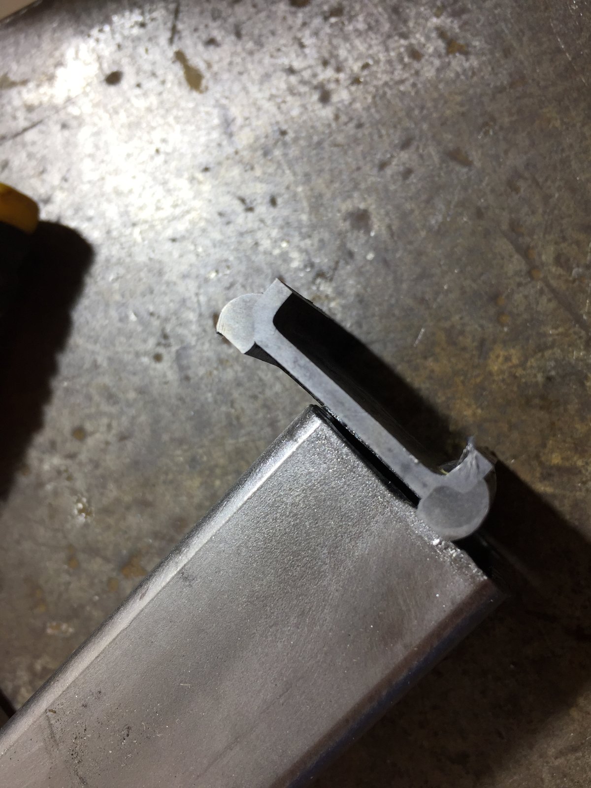

Been wanting to have a go at this for a while - didn't make too much effort with this bit as didn't expect it to work so it was rough cut with the bandsaw, quick go on the belt sander then tidied up with 600 W&D. Etch solution was swimming pool PH down.
Now I now how to do it I will be doing some more test pieces, this bit was left in for about 20-30 mins.
