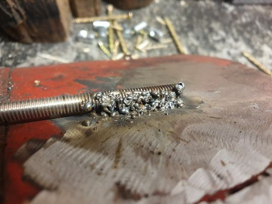

Set my Clarke 150 TE up today and had ago for the first time..Can you advise which way to go, Wire speed, Voltage number e.t.c..
Go easy on me ....lol...
As said, get some 3mm and turn the power up and then tweak the wire speed to suit and practise runs before you start joining stuff together. Turn the feed up high then turn it down till it stops pushing back at you and machine gunning then work on keeping the torch steady and at a set distance from the metal using both hands. Keep at it you'll soon get the hang.
