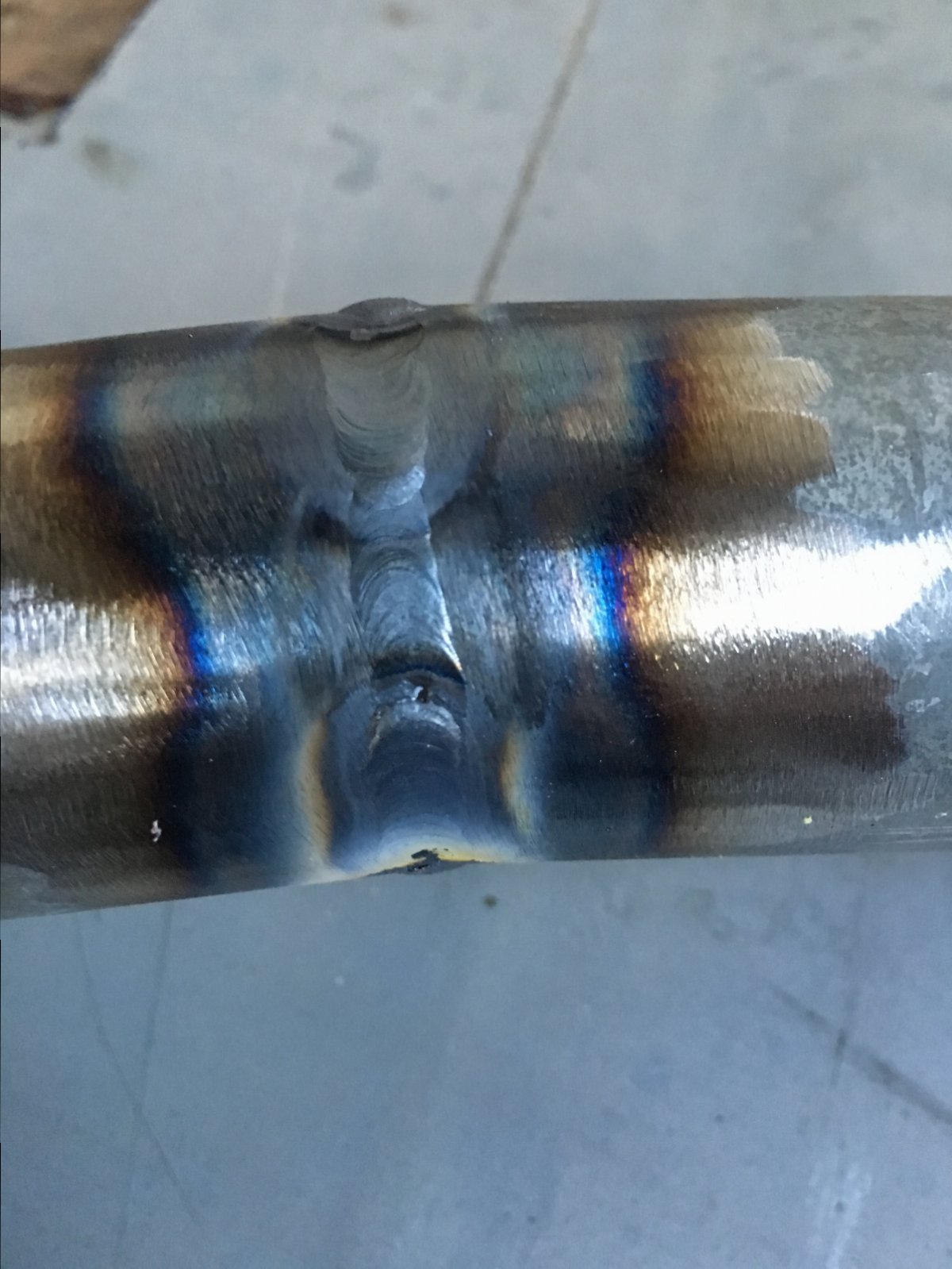

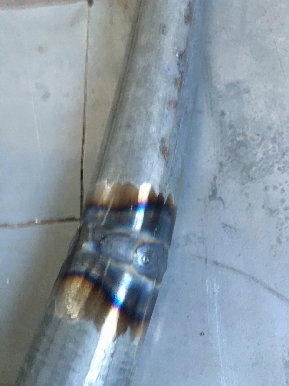

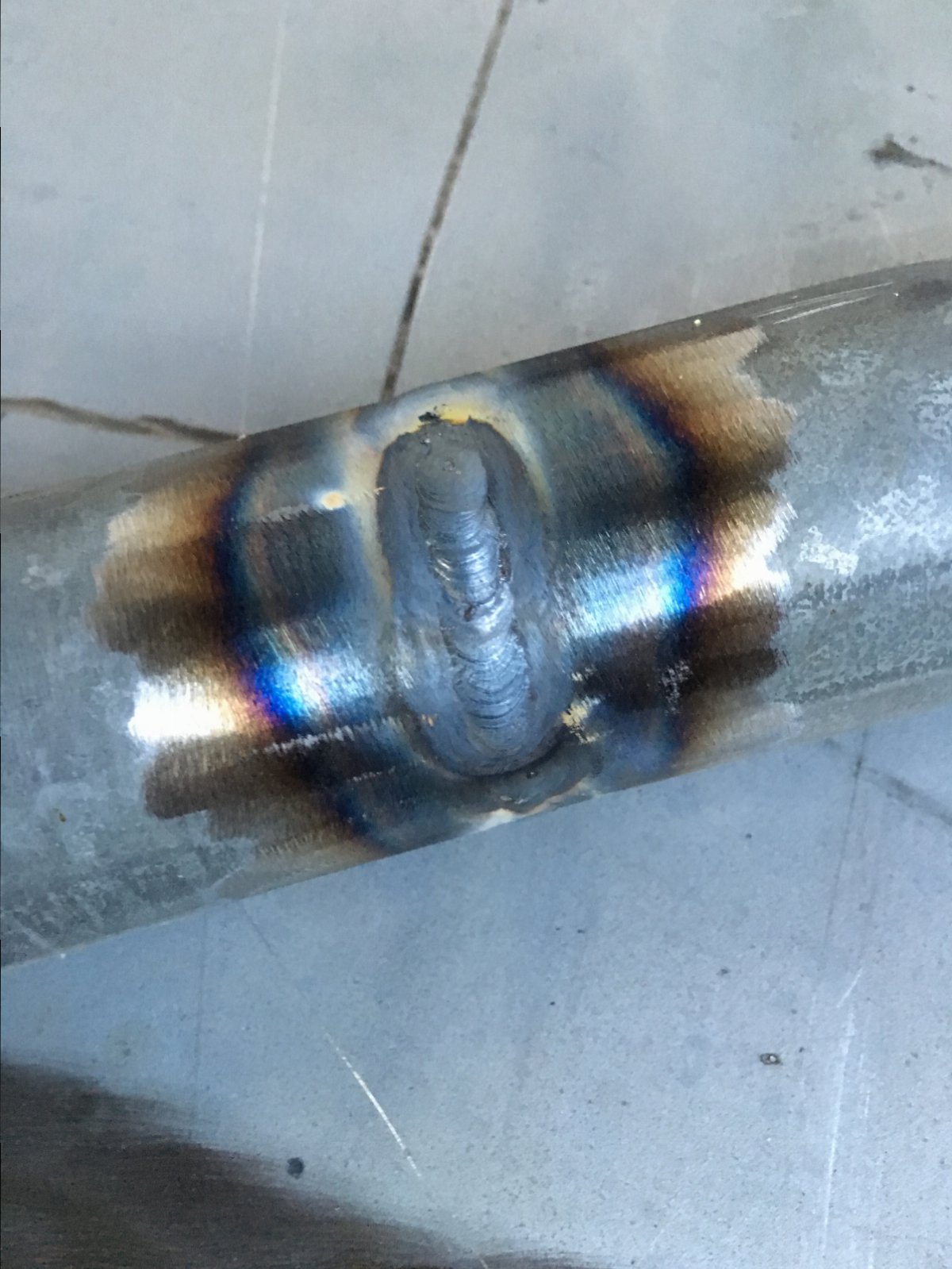

thanks for that, i guess you mean slight v prep?Open root isn't necessary , a slight prep is much better for the job. It looks like you're doing a root and cap too, I wouldn't bother, a single run will suffice fine on that thickness
Yesthanks for that, i guess you mean slight v prep?
great thanks Richard im guessing that the pool will tend to flow down with gravity making it more harder to control & stay consistant in speed?Don't weld past the point at which gravity takes over.
Stop at 12 o'clock.
It tends to sink giving you no cap hieght .great thanks Richard im guessing that the pool will tend to flow down with gravity making it more harder to control & stay consistant in speed?
