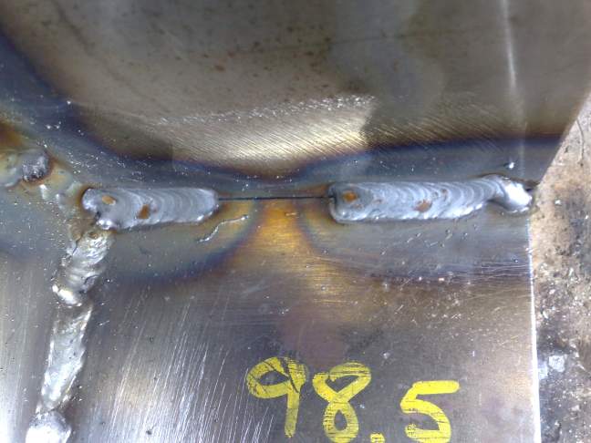

What I really wanted to post was a couple of fillet weld pic's.
I was really pleased with the appearance of this pair of weld beads in the first picture, what do you think?

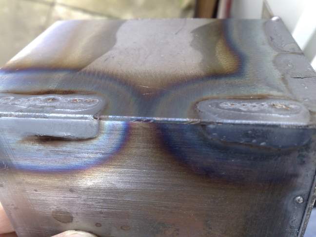

The third image is of the the back, the bead seems to have penetrated through to the other side, maybe could do with a tiny bit more penetration but its pretty much there I think? Its not fused the corner at the root, but deffo penetrated further up. Comments?

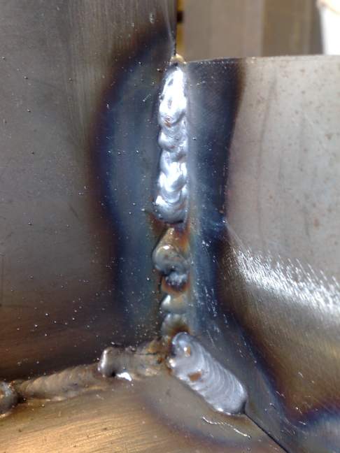

The second is my first attempt at a vertical weld fillet. Not quite as tidy! How can I improve this?
For all these fillets I had increased the wire speed by about 1 notch from flat and butt welding so it was on about setting 7 on the dial (130 amp clarke, running on 5% CO2 and argon mix, 0.8mm wire, power setting 2 of 4).
I was trying to do the christmas tree movement that some one else mentioned but not sure I was doing it right!
