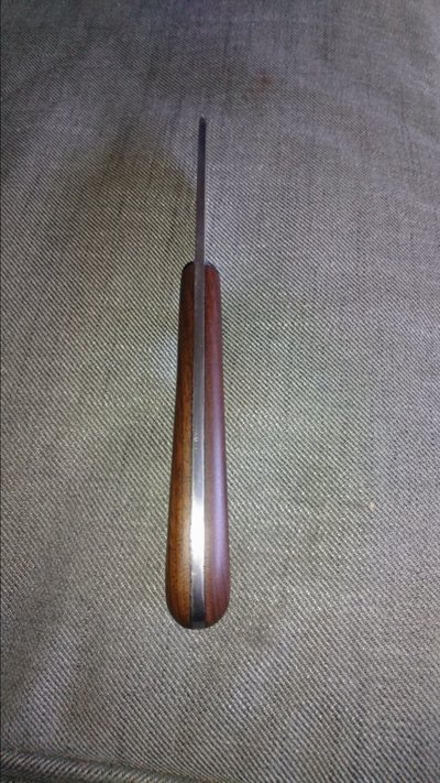

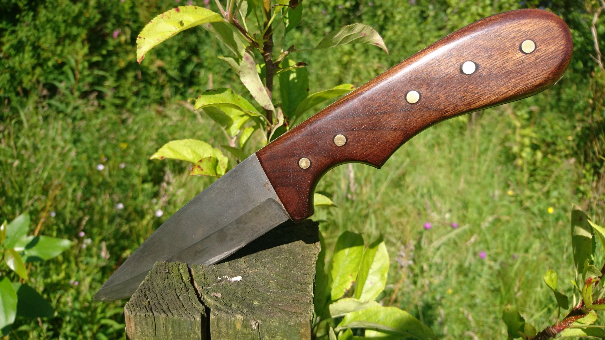

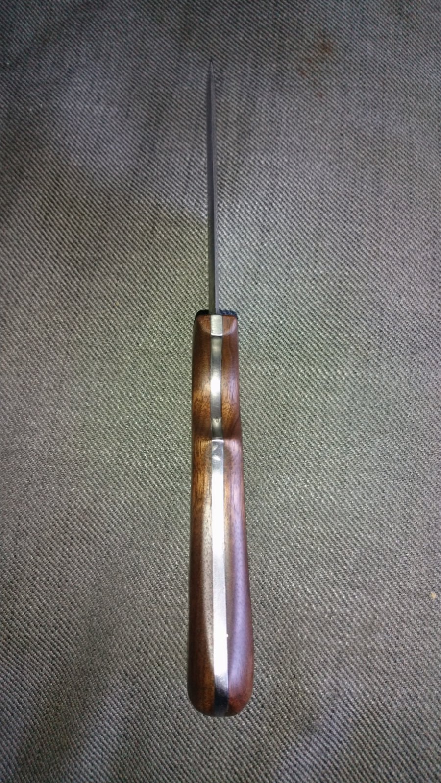

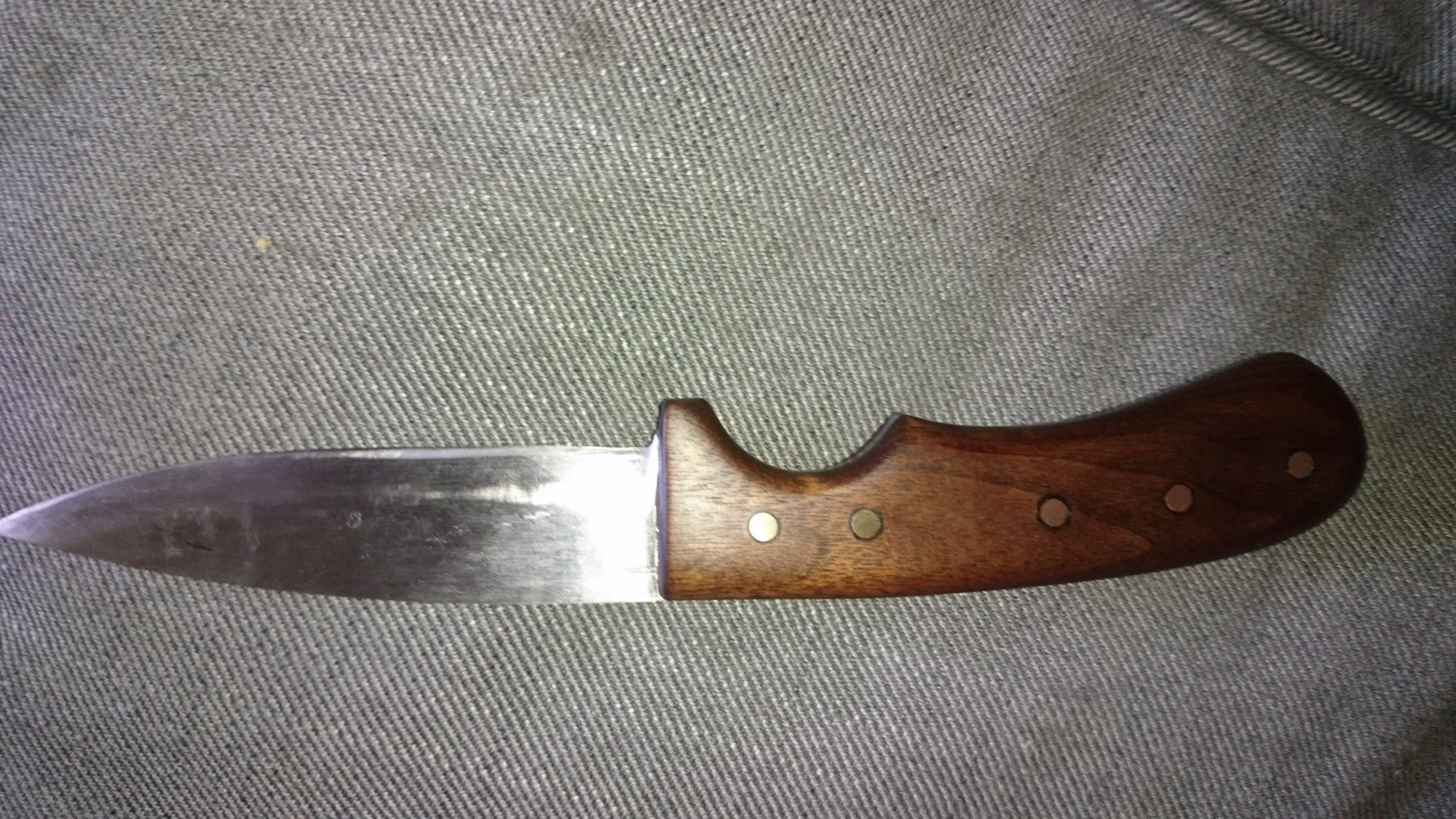

Not quite finished yet. But does anyone know a good leather worker who might be interested in making my sheaths?
Fixed blade 01 tool steel, walnut and brass pins, for a deer stalkers friend

Thanks but I am really looking for quality in keeping with the higher endSheaths aren't that hard I've done a couple and they come out nicely. Get some 3mm veg tan leather, I buy it from the identity store in Matlock. Make a template in paper, cut it out in leather. Make a welt so you don't cut the stitches and mark your stitches with a stitch wheel then drill through the leather and sew it from both sides with two needles. I wrap the knife in cling film and wet the sheath then form it round the knife with a piece of dowel and leave it to dry. They hold the knife really securely wit a nice click when it is pushed home.
