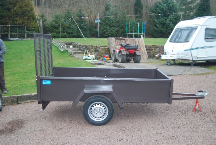

Hi guys, lots of good projects here so thought I'd post a few pics of a trailer I made a few weeks back

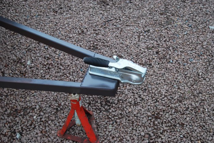

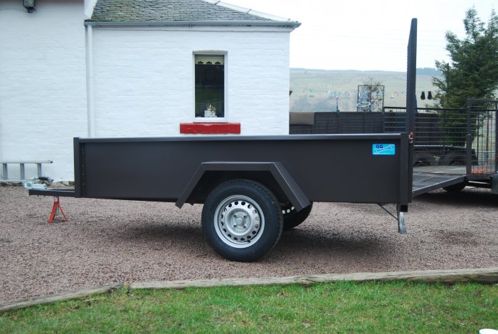

the sides and headboard of the trailer are made from 2mm mild steel which I folded on my box and pan folder. the side/headboard panels were then seam welded to 50 x 500mm SHS with a 50 x 50mm SHS rear cross beam to keep it all square. The tub was then welded to the axle and A frame drawbar (50 x 30mm RHS).

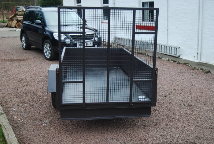

The tailgate ramp is fabricated from 30 x 30 SHS and 10g 1inch weldmesh. I have used 750Kg rated Indespension units with 13inch wheels and a Bradley cast 50mm hitch. The finish is an agricultural paint sprayed on top of zinc phosphate red oxide primer. The floor is 18mm phenolic coated plywood.
