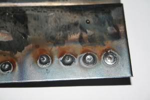

It came with CO2, but I am used to CO2/Ar. I bought a CO2/Ar cylinder but it din't seem to work, the CO2 works but even on full blast I get all this brown stuff:
Is this caused by lack of gas? The cylinder/regulator does seem to be releasing gas but it's only a quite his even on full.

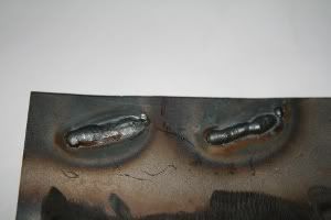

Also, I was expecting that the lowest setting to be enough for car bodywork, but I have to use second lowest to get decent penetration (second lowest setting on left):

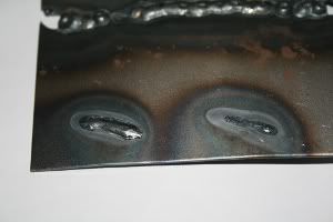

flipped over:
flipped over:
