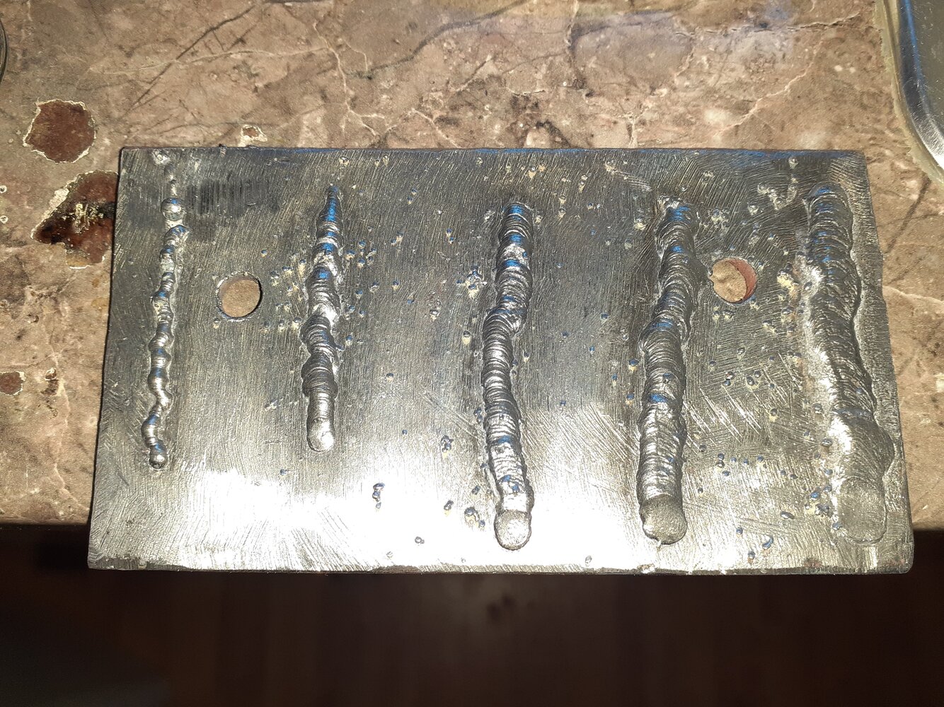

Using an old piece of quarter inch thick steel plate to test the Impax IM-MIG 120A welder, from Screwfix. This was using SIP 0.8mm flux core wire at various settings.
From left to right. 40A, 60A, 80A, 100A and 120A. My only previous welding experience was an Aldi buzz box arc welder, over 15 years ago. Some of my old previous attempts with that are still on here.
