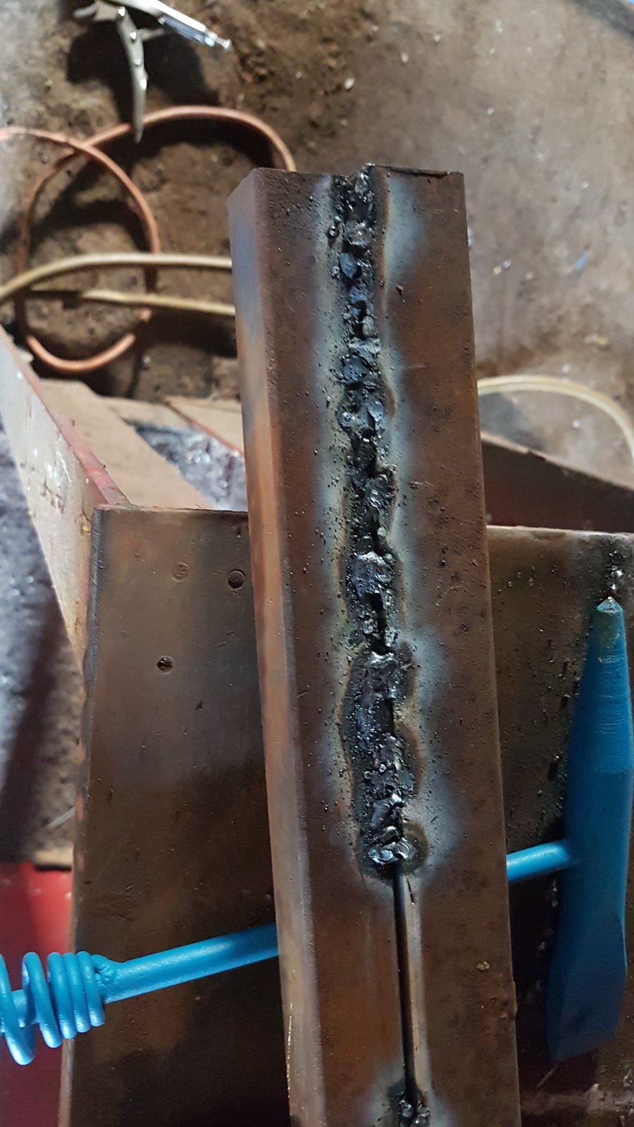

S Sparkyarc19 Member Messages 125 Location London england Nov 17, 2019 #121 Bro there is no rush dont worry mate
Munkul Jack of some trades, Master of none Messages 7,794 Location Cumbria Nov 18, 2019 #122 Slow down! You're moving too fast and that's why it's skipping here and there.

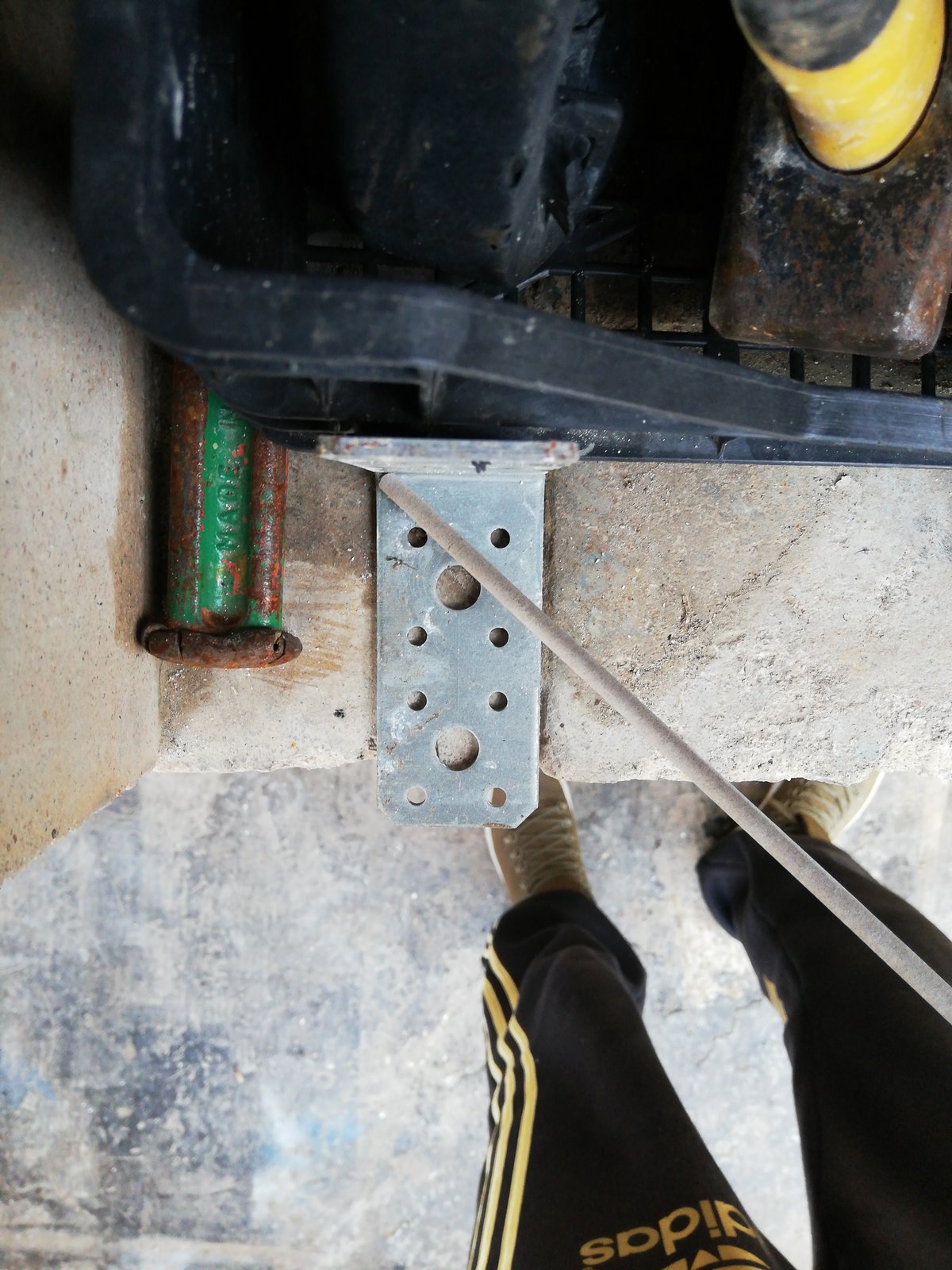

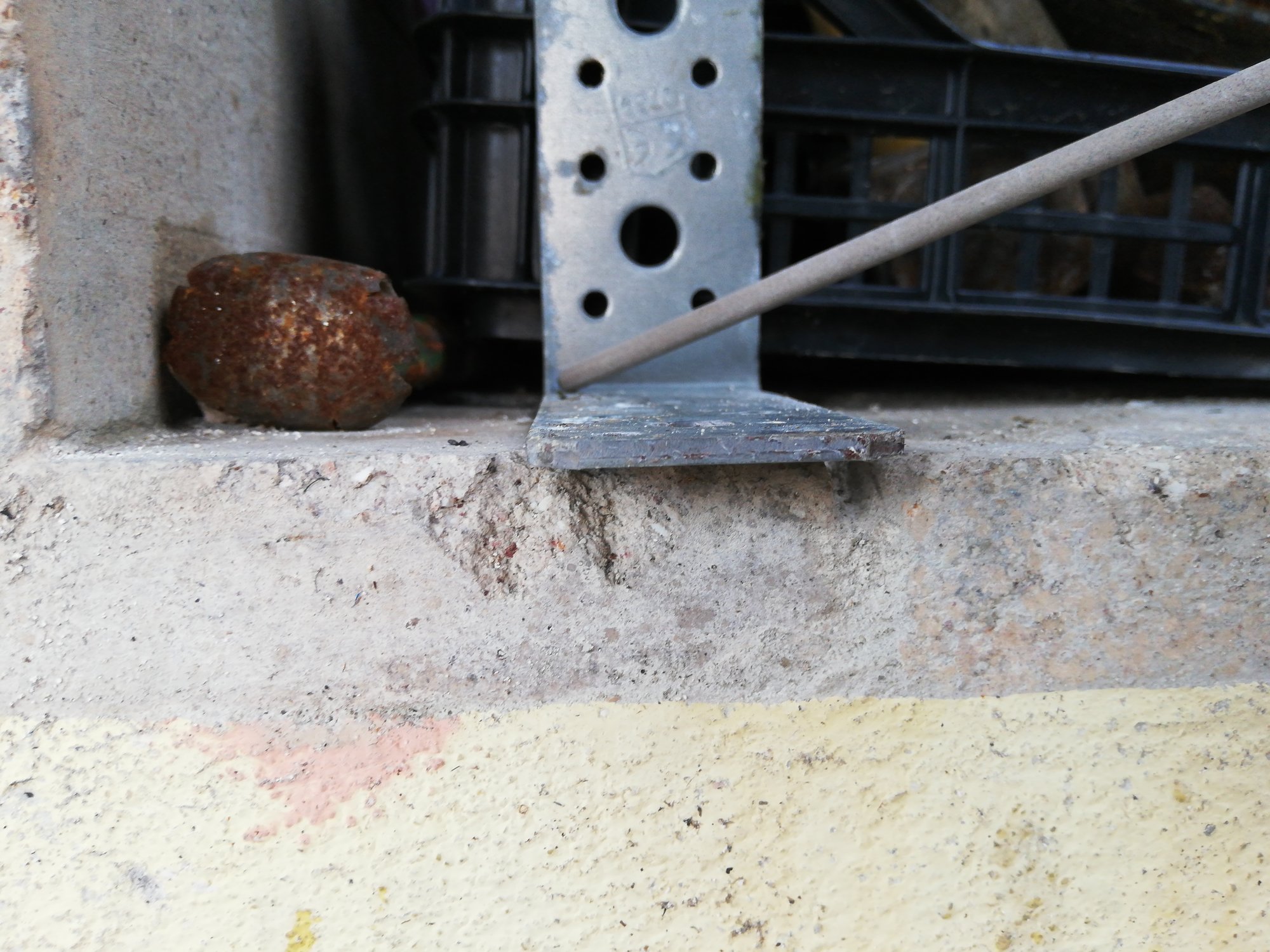

Memmeddu Member Messages 5,866 Location Italia Sardegna Nov 18, 2019 #123 Those angles works for me Take a try And don't forget to push the rod against the center of your fillet You should be able to see both the edges being melt by the puddle 15740879578026852513975327299712.jpg 293.5 KB · Views: 98 15740879784841704219124286965813.jpg 430.5 KB · Views: 100
S Sparkyarc19 Member Messages 125 Location London england Nov 18, 2019 #124 Yeah I haven't been using even half of that angle I'll give it a try
Munkul Jack of some trades, Master of none Messages 7,794 Location Cumbria Nov 19, 2019 #125 You don't need that much angle. You need to slow down.
