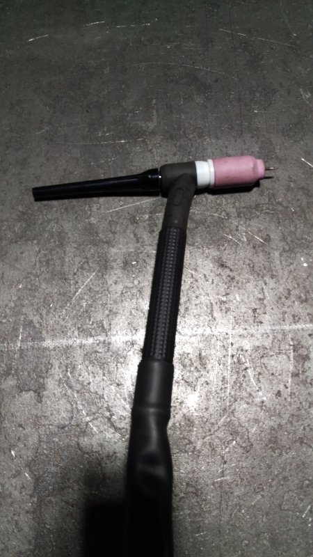

I think he means the sheath D.You mean the shroud that the hose and torch lead go in?
Glad I have my uses buddy.That's the very word I was searching for Rich![]()

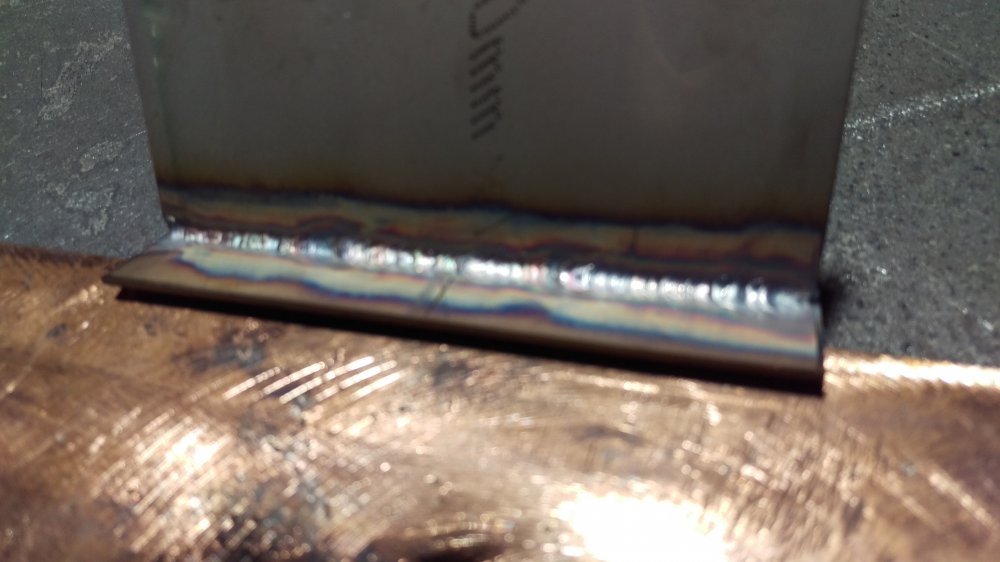

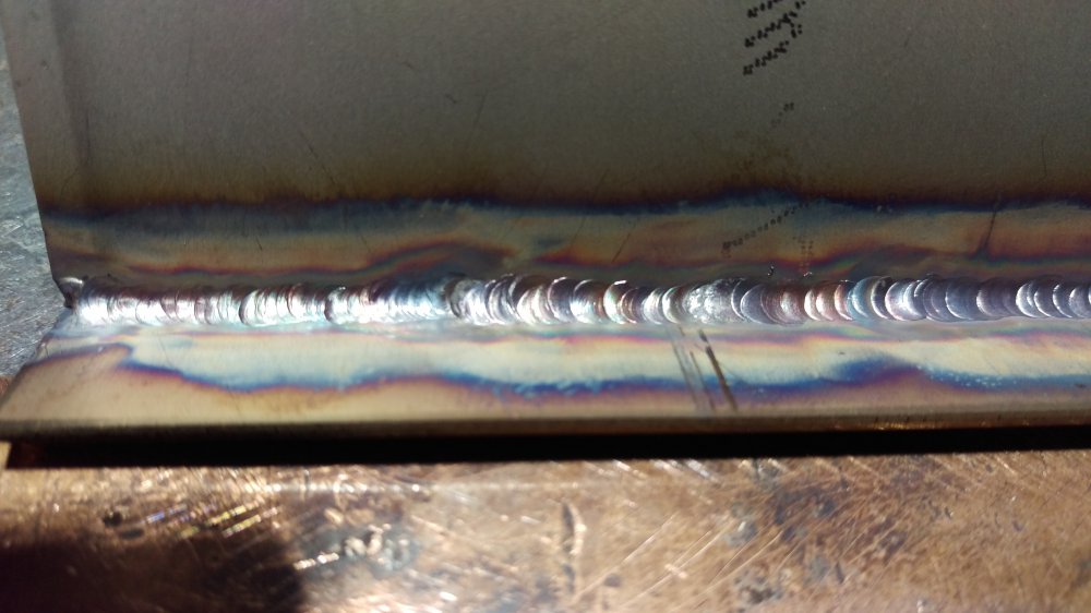

On a close appearance there is some things that need addressing.
You need to be more positive with filling. That's a thick lump and it's in need of some reinforcing. You've got inconsistent width where arc length has been too long widen in the arc also causing undercut. Why not put up an impressive looking run on a flat plate where your able to concentrate on the basics rather than throwing yourself down the gauntlet too soon with a fillet joint.
Looks thicker than that. It's certainly not thin but I was thinking 3mm. Still needs more thoat thicknessThanks for the advice but why would you call it a thick lump it only 1.5 or am I missing something
Try something a little simpler to start with like the good old Butt joint. Aim for perfection on something like that to gather a set of skills such as arc length, filling and consistency. Then transfer those skills to a harder joint like lap or outside corner once perfected. EsCHEn above done exactly that and taught him self to Tig weld to a lovely standard (don't denie it D) by simply mastering the basics and taking those skills to more challenging things then mastering the more challenging things without worrying about the basics that will naturally be there. Muscle memory I think they call it???Cheers I will have an other go tomorrow and see how it goes
That's impossible!! We live 300 miles apart!!!!Exactly as the more learned Richard says - start on a simpler joint as it lets you concentrate on the basics and get them down pat so that when you move on to more complex joints the only thing you're needing to learn is the new bit, not everything else as well!
