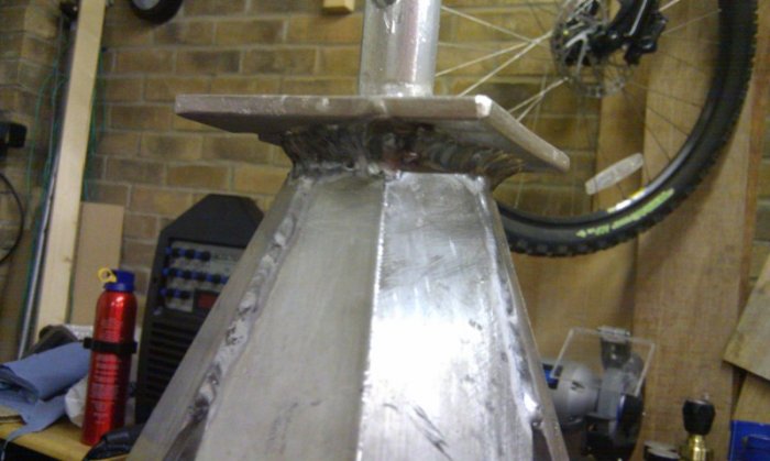

Hello all,

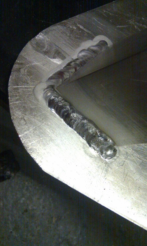

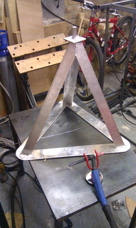

I've finished my first bit of purposeful ally welding, although I think I'd give myself a relatively low mark on the absolute quality of the welds.
Successes
- Well, it's together!
- Some welds came out well
-Technique is improving
Not-so successes

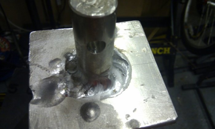

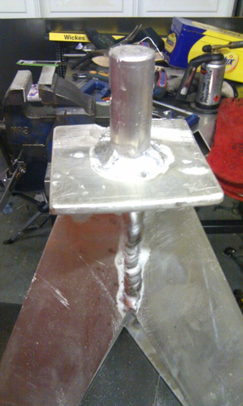

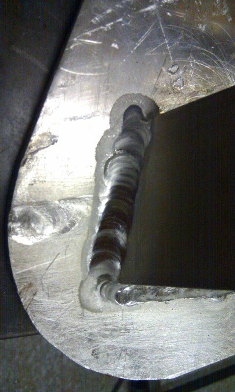

- Caused material drop out in places, particularly the top piece which I welded with the hole stand upside down (legs onto top piece)
- Bach sides of the angle section joins look not nice!

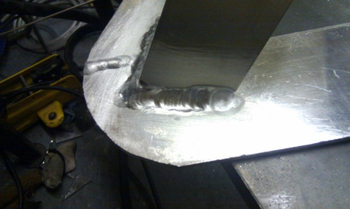

- Some welds displayed a 'micro-bubbly' surface - don't know why
Learning points
- Get the weld pool shiny before doing anything with it
- The twisted filler wire tip to make an equivalent larger filler rod worked well

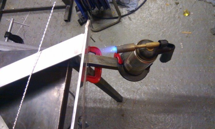

- Preheating (see pic) helped a bit
- Designing the piece so that I don't have a thinner (3mm) piece welding to a thicker (5mm base) in a perpendicular fillet.
- The better the fit up the better the weld
- Don't bevel every edge to make a vee channel to weld into.
- Ally sucks amps - if I were doing a lot of this I'd coonsider a machine with more amps! (although I haven't gone above 140 A yet since 'I got scared' - machine is a 160A)
- Higher frequency concentrates the weld pool
- Tight electode gap improves cleaning (should have played with cleaning/EP/EN balance instead of leaving it at 50% though)
- Give the arc time to get rid of the black floaty bits in the weld.
Any tips, particularly on the micro blisters in the wled surface, much appreicated!
