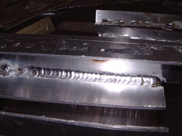

After many hours things seem to be getting a little better. you try that many different things that you dont know what has worked and what hasent. but
ive produced a few exceptable fillet welds. i was not holding to tungstone
close enough. also not enough power. also the right angle with the torch helps to melt just infront of you. where i was going wrong before was melting
both surfaces then dab in the rod but not moving the puddle forward dab in the rod again and so on looks great but when you look after its a mess to much filler i think another problem is the aluminium im welding is 2mm and it
is a fine line between moving the puddle forward and going through see what
you think folks
ocean

on that one Woz. I just cant get my head around the perspective in the photo.
