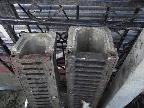

I made my outer 'frame' out of mild steel 12mm square but where the fire sits I used cast strips of cast iron grating from industrial drain tracks like these (see picture) the slots in them are tapered so the grooves are wider underneath so the dust falls through without clogging
I used to work in a metal recyclers yard and we used to get all the scrap from the council they used to come in regularly so I grabbed a load I think I still have a few left for MY spares. but being relatively short when cut to the shortest span and seperate they dont burn or distort to much.
