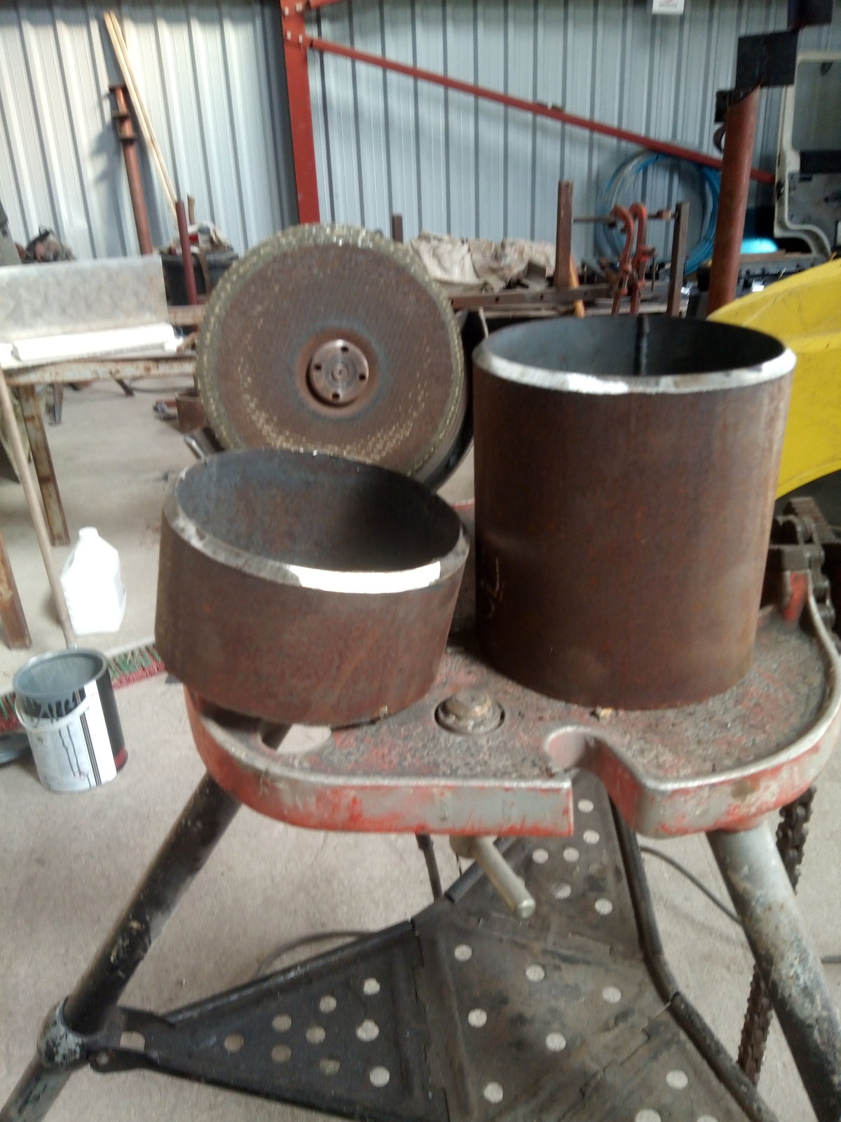

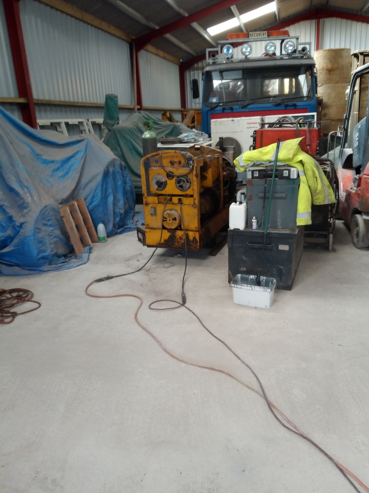

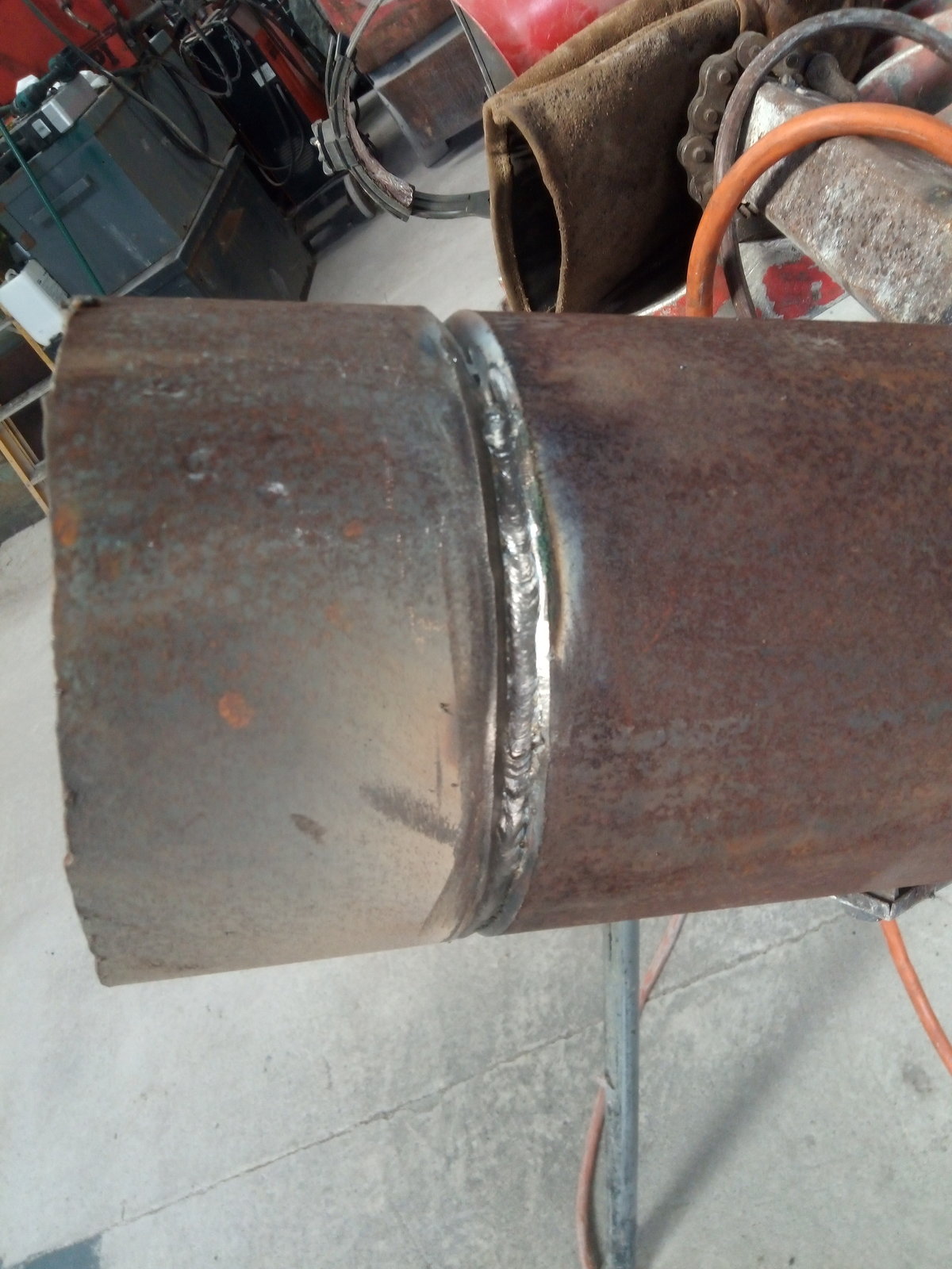

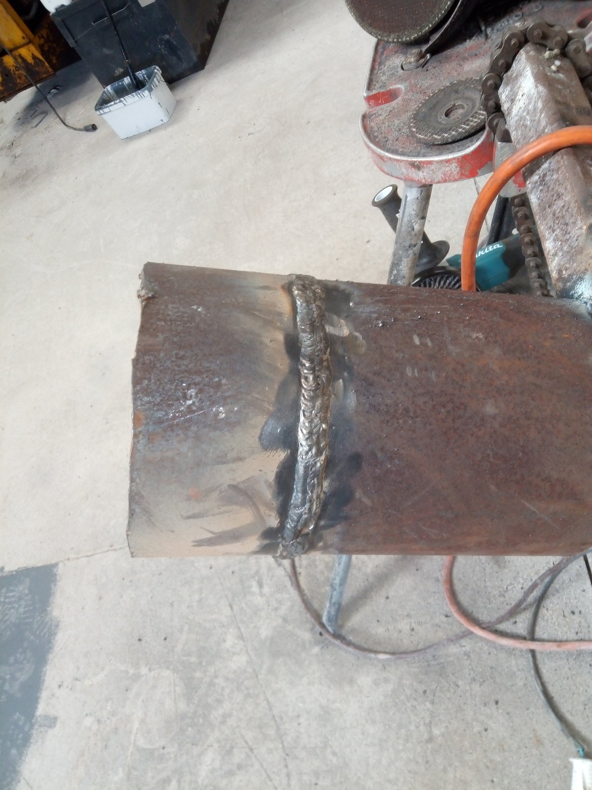

It's been been time since I fired up the sae 300 she still runs and welds I finished the rest off with my thermal arc was getting gassed out after a few passes I've not practice pipe for over a year I'd thought I'd share some pics I don't like using 8018 vertical up but it's all I had one side of my root was 6010 down hill Lincoln 3/32 Lincoln 5 p plus pipe linner fill pass 1/8 Lincoln 5 p plus's and capped 3 passes 1/8 8018 filarc welding rods I've got lots of practice to do this was the only test peice I had cut already it's a Sunday and my backs still in a bad way hope you like any comments welcome oh and the other root was 7016 v up bohler 2.5 it closed on me in certain parts so did not get full pen
And got some inclusion as I pulled out when I got snagged on my bench but it's my first go in a year before that not done it for ages
