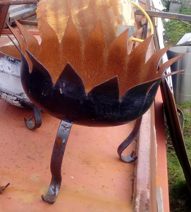

What sort of thickness do you think a garden firebowl 200mm deep & 900mm wide should be? 6mm?
All the propane cylinders I've seen are between 14" and 16" in diameter so more like 400mm at max.i made one just before xmas i think out of the top of a gas bottle, its about 600 something diameter and around 120mm deep, 3mm steel as per propane bottle and its had a around 40 fires in it since then burning scrap cardboard, paper, broken pallets, charcoal, oak logs and my xmas tree last week...seems to be holding up fine at the moment. if i was making one (which i intend to do towards the end of the summer) from raw stock i would probably use 4-5mm

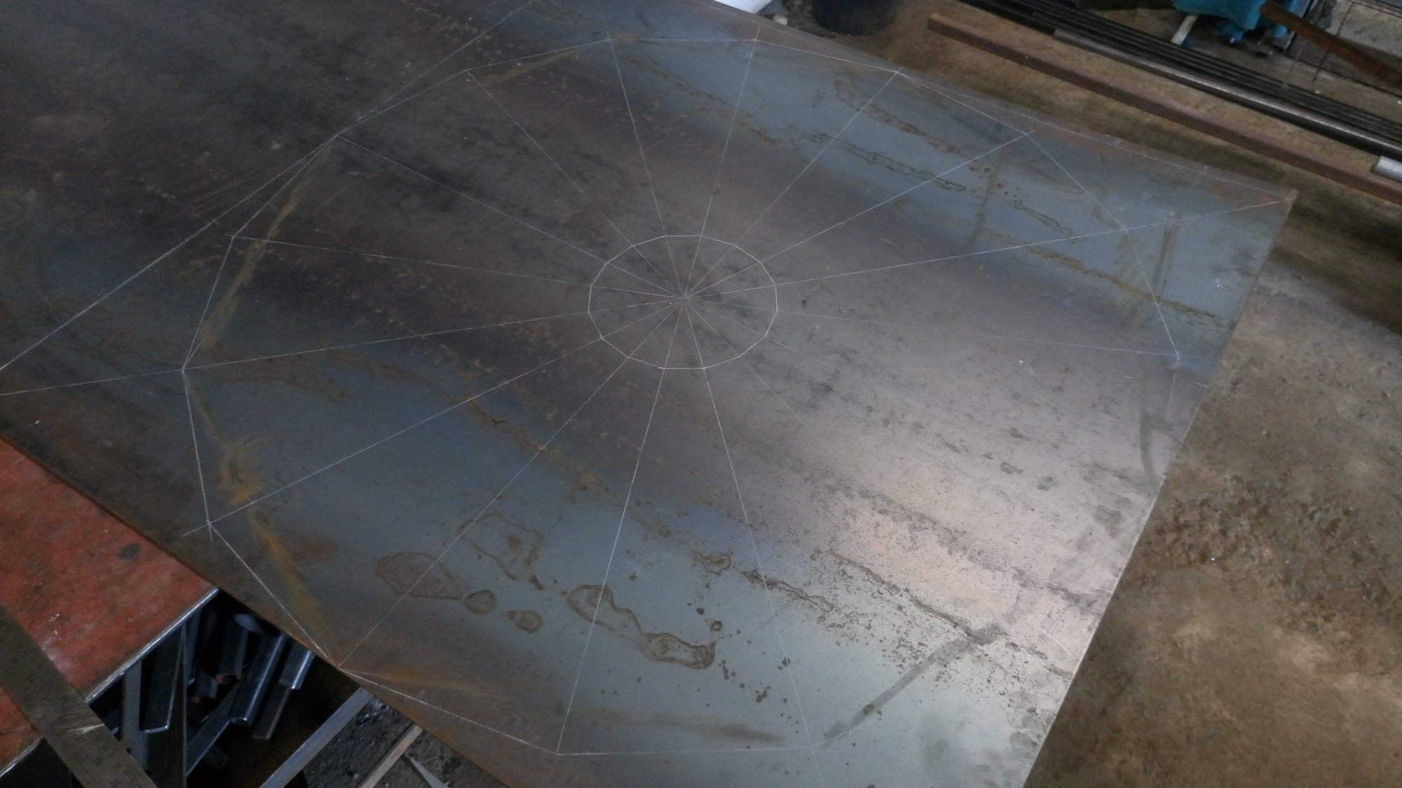

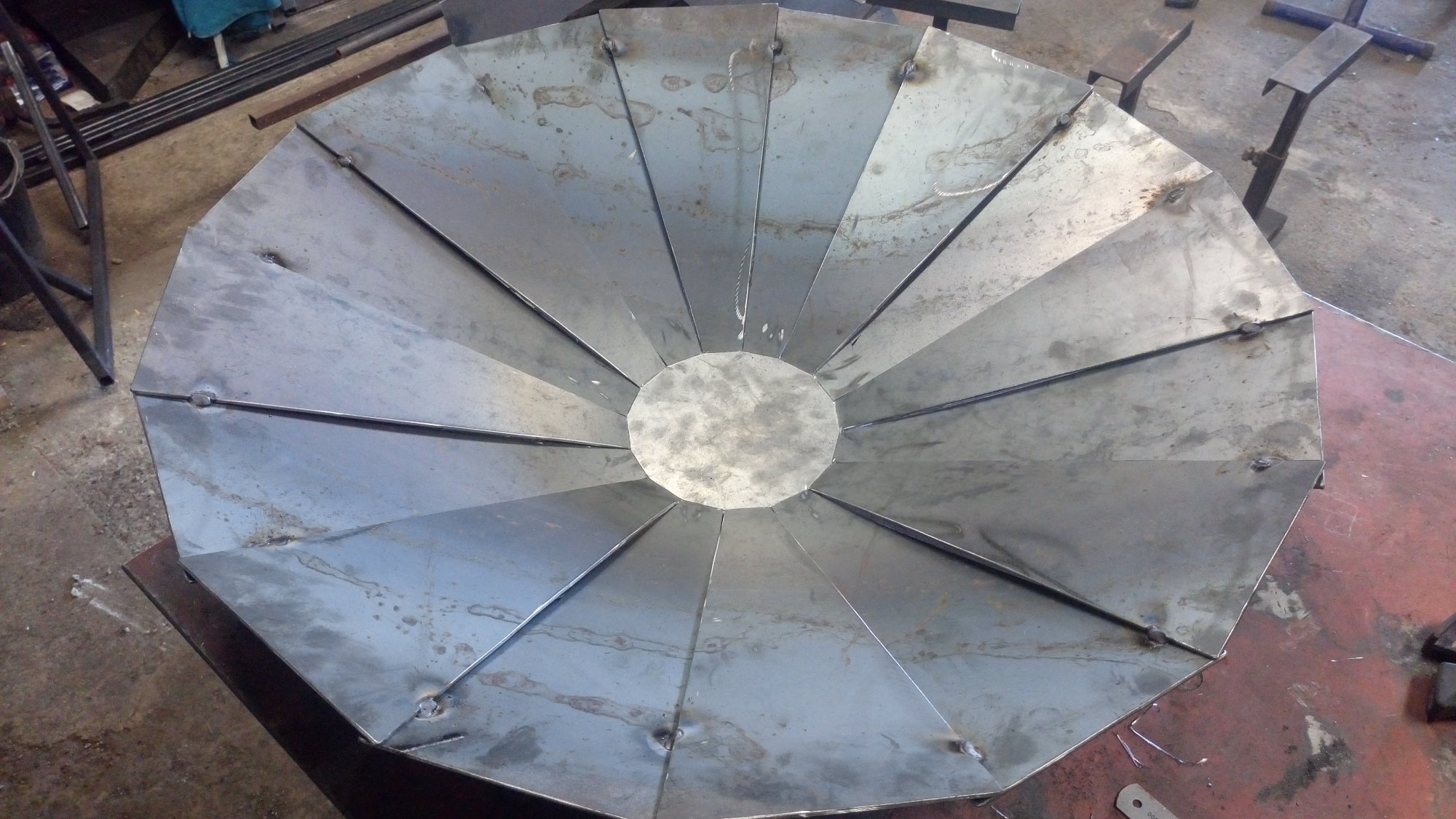

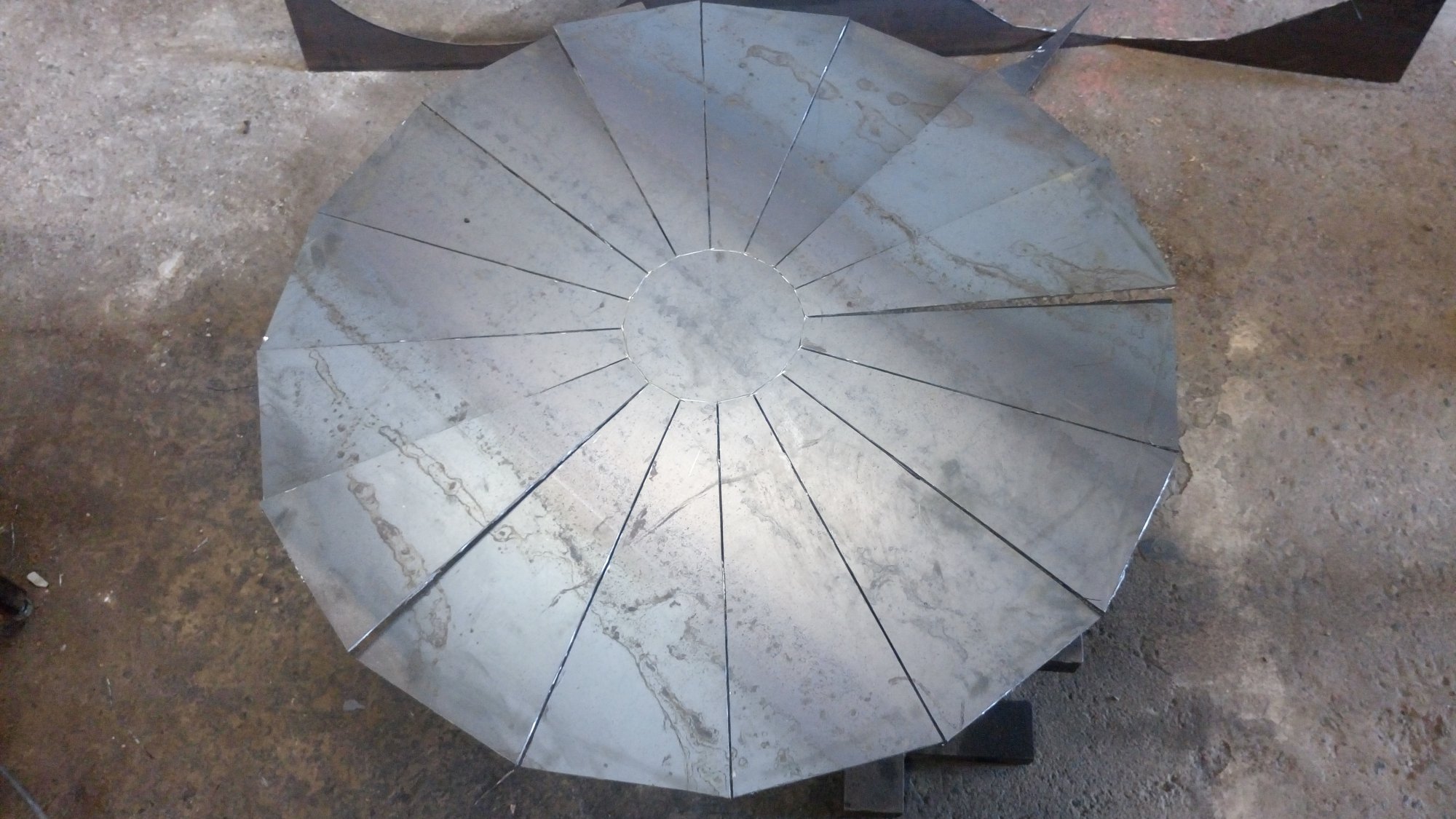

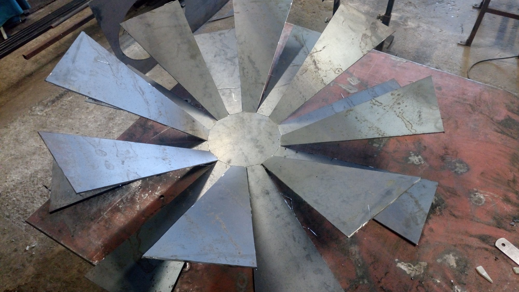

How are you going to make a "bowl" shape ?

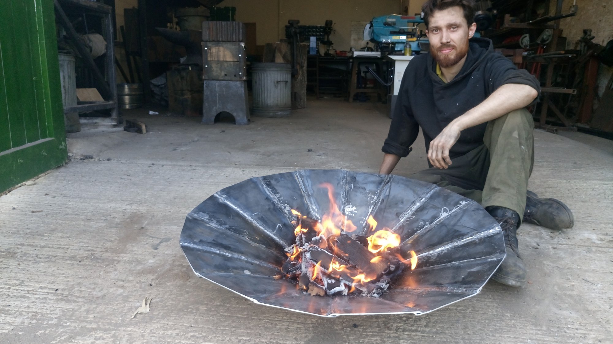

That's the problem with this stuff. There's so many people doing it their garden sheds for pocket money. It's a shame.Last one I made. I only use gas bottles though, as there are so many about .The spikey bits needed more shape to them, the next one I shall make a tool or a jig to shape them better.
Not had great luck in selling them though, people will only pay £25, which doesnt really cover the work involved.
