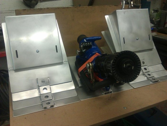

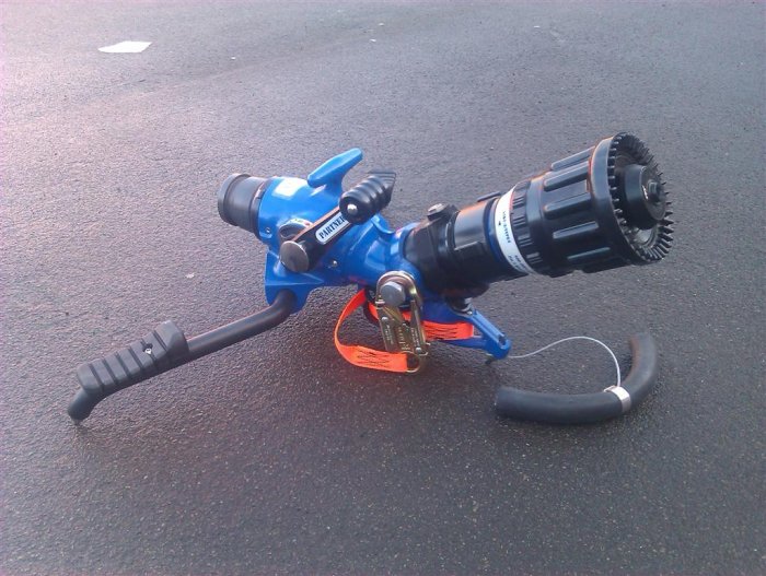

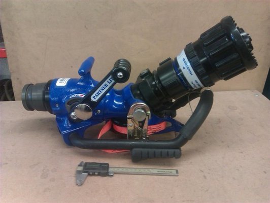

A bit of metal bending, asked to supply mounting brackets to stow these monitors in a fire appliance storage locker, the legs fold up to look like this but laying flat they are too high for the locker.

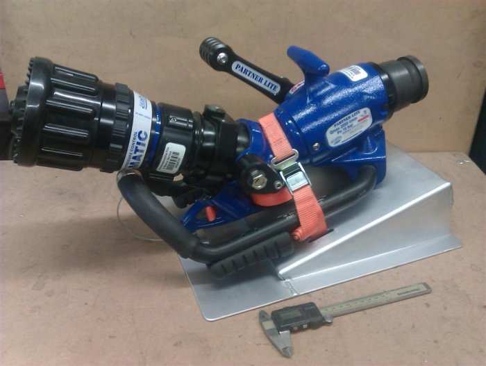

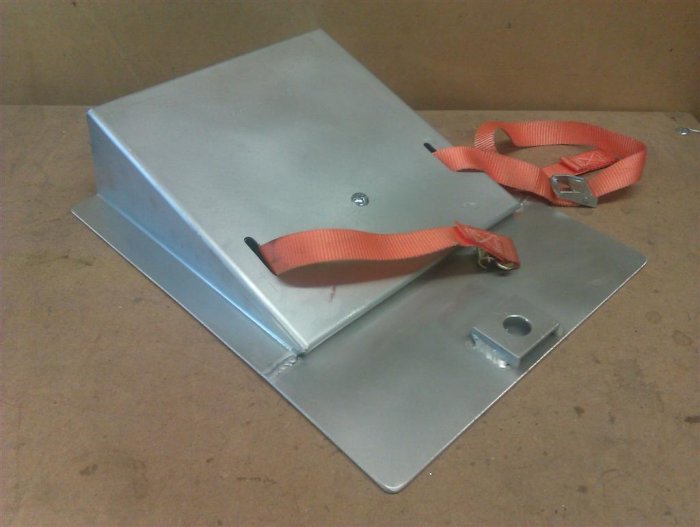

So I made an aluminium bracket to tilt the back up and lower the front, the bracket on the front is to locate the spike, and a simple nylon strap to tie it down completes it, the customer will fit a thin
rubber pad to the flat surface when its installed,
9 off them all together, ready for delivery
