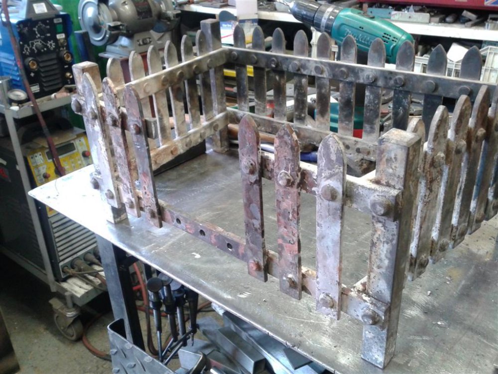

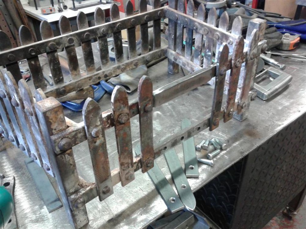

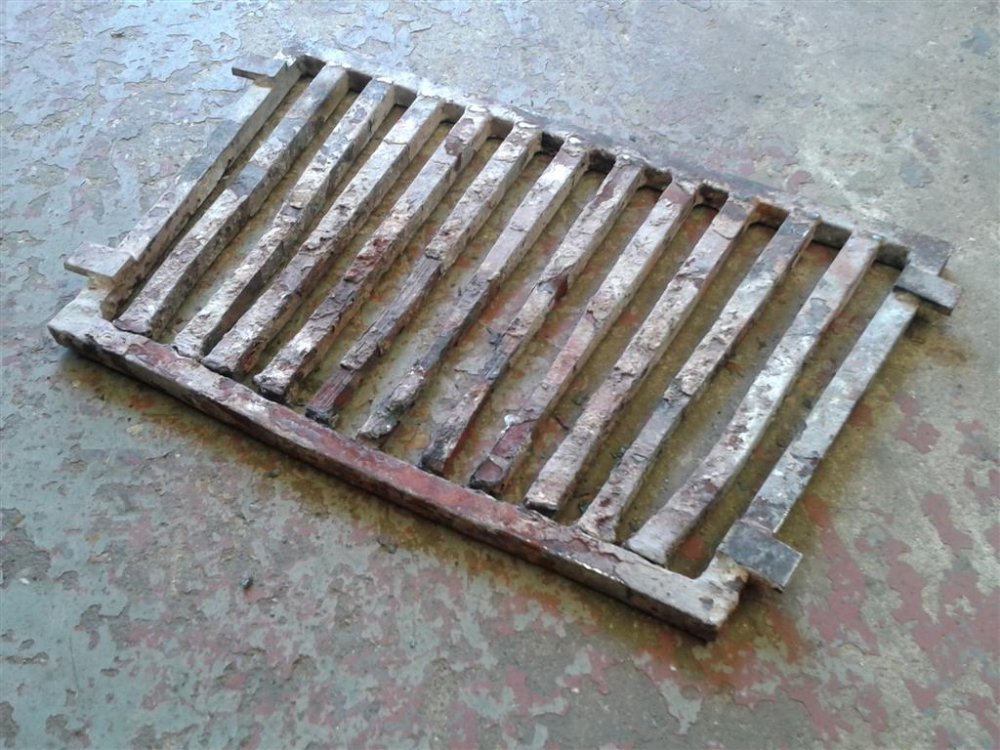

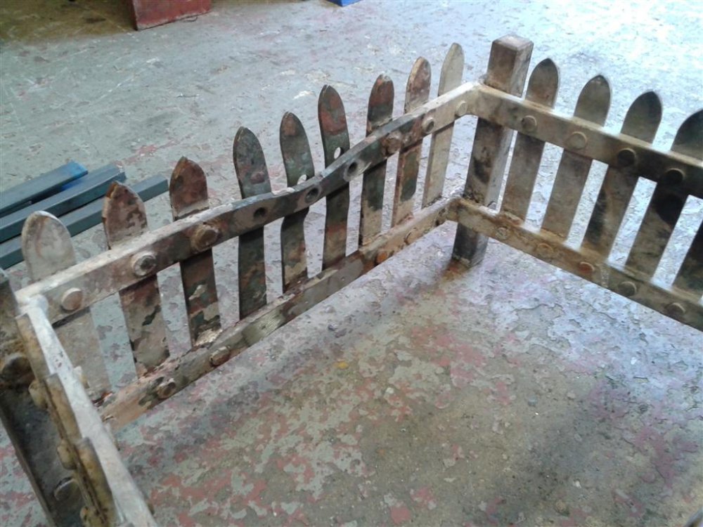

Nice little bench job for a change today, repair this fire basket and grating, not a proper restoration just enough to make it usable again, the grating is definitly past its sell by date, but the basket is repairable, I've started to pull the rivets out here.

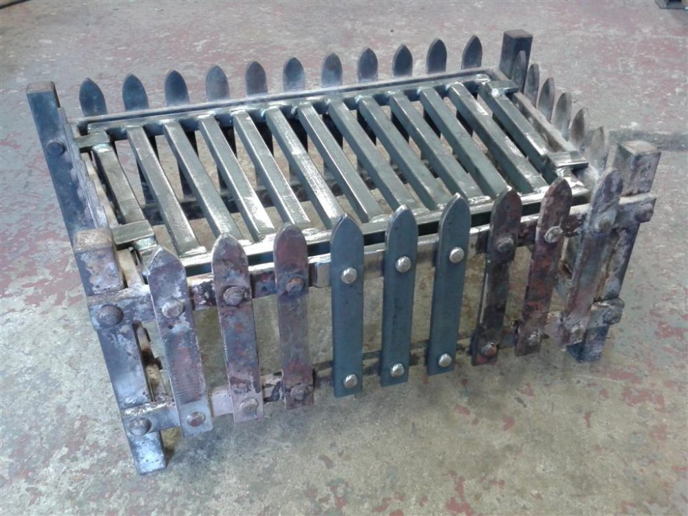

The horizontal rail is burnt and distorted so I've cut out the damaged section and let in a new piece of bar, make 3 new pointy bits and make some rivets out of M8 bolts

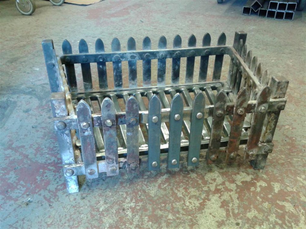

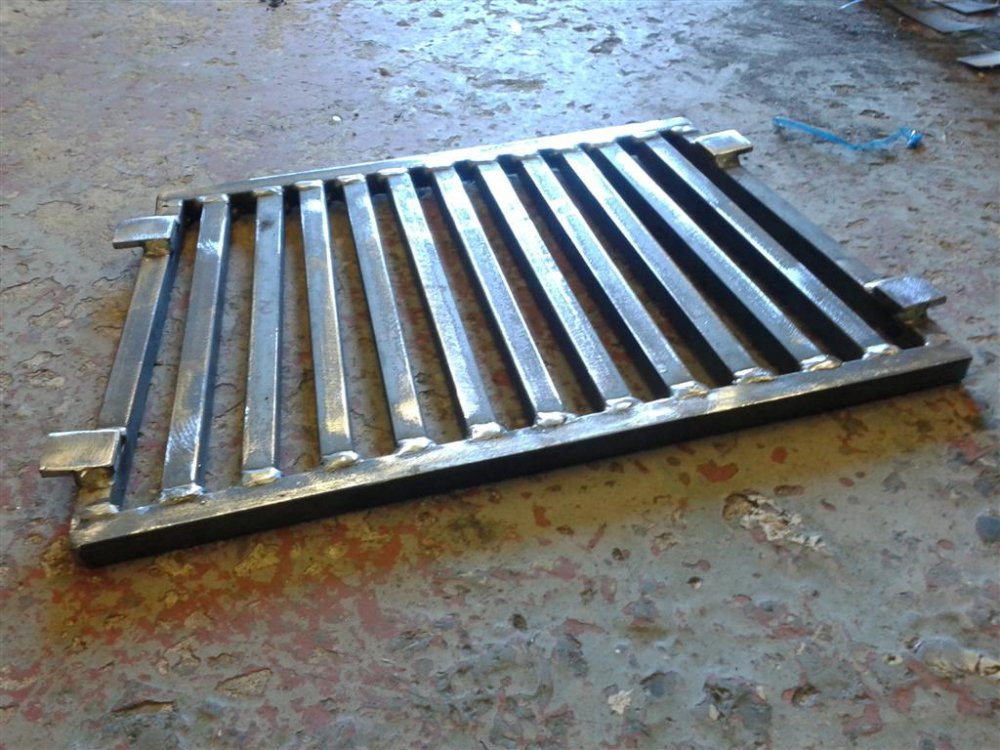

New grating made fromm 16mm square bar, and its ready to put back in service.
