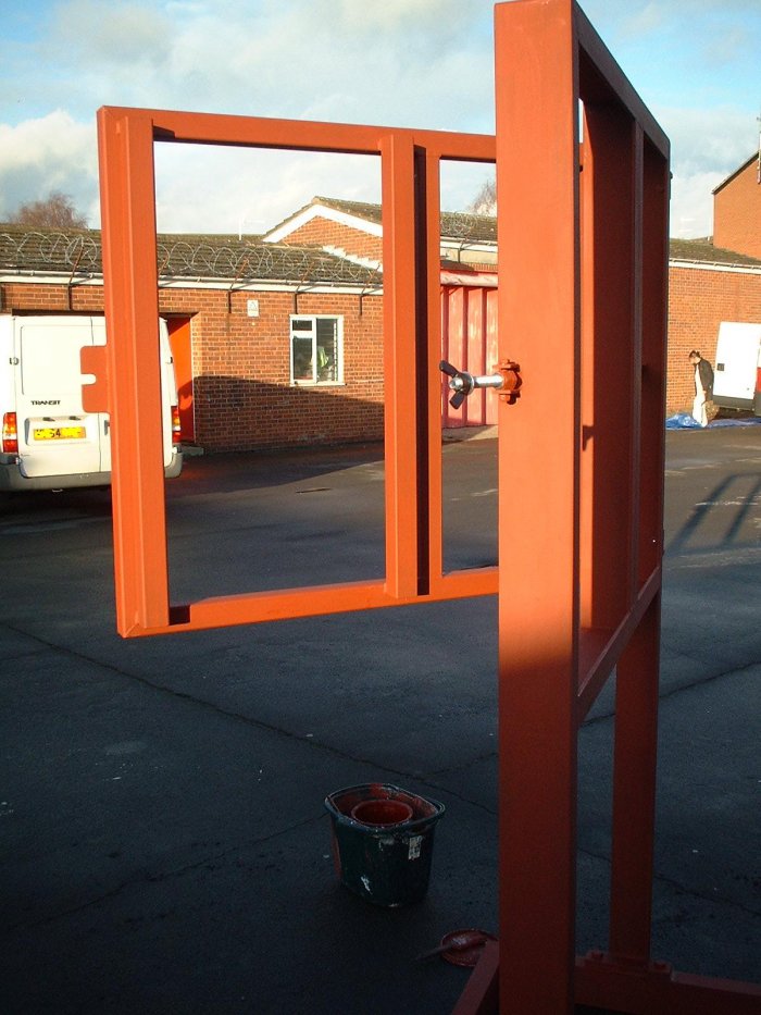

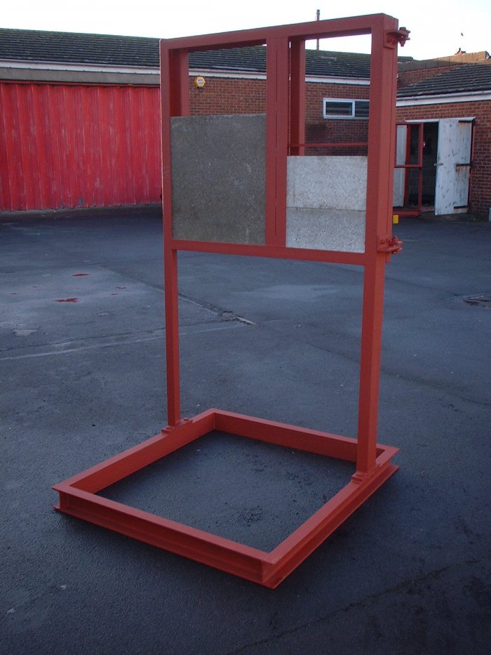

Just finished 3 off these today, its a training rig for my customer who is just setting up this system, its a hand held waterjet cutter for firefighting and cutting, the frame holds a 600 x 600 or a 600 x 750 paving slab, and 4 concrete blocks, clamped in by the door on the rear, all stick welded, 100 x 50 PFC base and 100 x 50 RSA frame, rear door 50 x 50 SHS,
3 more to make to hold wooden panels,
