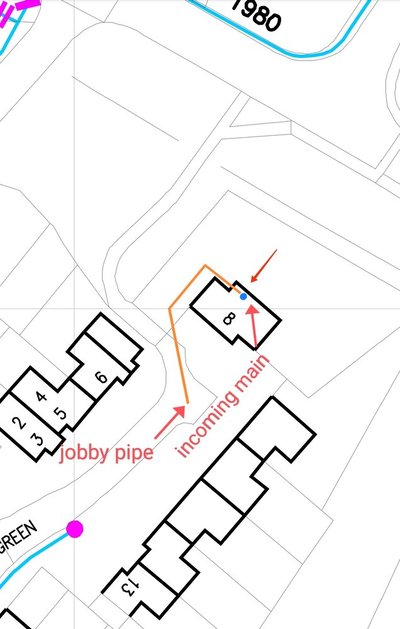

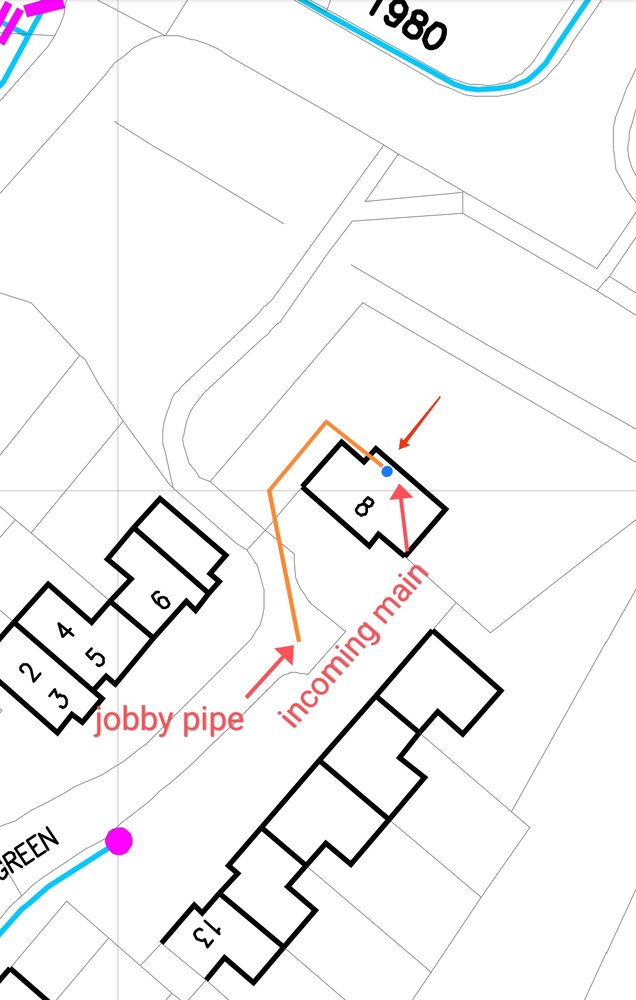

That might not work, the street stopcock is the waterboards property, they may argue property owner should not be touching it and use the properties stopcock, usually under the sink or nearby, not that it's stopped me where I have had to isolate supply via the street stopcock.should be a stopcock outside your property just ask the waterboard to come out and find it as you want to turn water opff in your property they will probably do it for nothing if its in lead they deffo will
My 70's house is supplied via a copper pipe. Took me ages too to find the external stop cock - which didn't work when I finally dug it out.Why are you assuming the pipe is plastic? How old is the property?
In the cottage we had, the internal stopcock turned off next door as well. After we sold, the builders doing work there turned off the water & ripped out the plumbing giving next door a bit of a problem.A house my parents bought in the 60's was built in 1908 and the stopcock in the street would turn off the water to 4 houses so my dad had to go knocking on the neighbours doors to let them know if he wanted to do anything.
Ours is like that, built in 1955.A house my parents bought in the 60's was built in 1908 and the stopcock in the street would turn off the water to 4 houses so my dad had to go knocking on the neighbours doors to let them know if he wanted to do anything.
Great result.Phoned Scottish water, helpful guy said it happens all the time, paving companies just pave right over it. They will be out next week to find and service it, was expecting more of a fight, credit where it's due
daughter had a big leak on the mains water feed .water board came strait out dug down to the stopcock and renewed it as it was half knacked .the leak was in her property a yard in on an elbow they told us where it was and the insurance covered it they were real helpfull thats why i put in post give them a ringPhoned Scottish water, helpful guy said it happens all the time, paving companies just pave right over it. They will be out next week to find and service it, was expecting more of a fight, credit where it's due

well went with the bob suggestion of just dig and make sure to have a set of squeese offs in the digger, operator that knows what hes doing just tickled the top of it, does run under the new build in both ends of the trench. Not be hard to find the toby now and probably run a new main around the outside of the building
