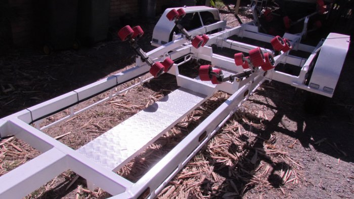

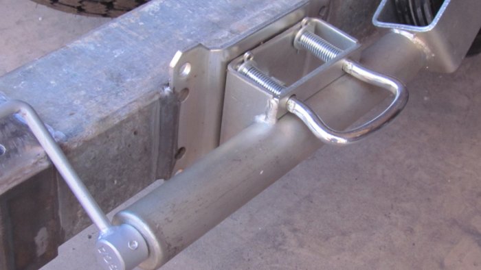

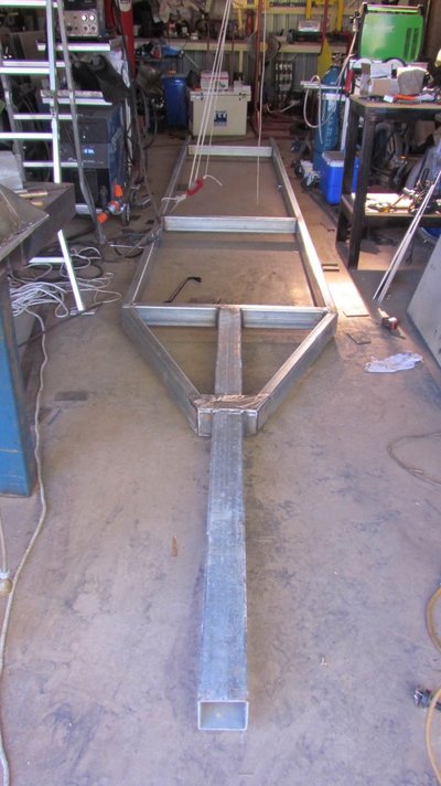

Started building this about 8-12 weeks ago and finally got the safety certificate and registration on it a couple of days ago. It's rated for 3.4 tonne, and has electric over hydraulic breakaway brakes with 12" rotors and 1800 Kg axles. The breakaway unit is a Hydrastar 1600 PSI unit (could have used the 1200PSI one) which connects to a Tekonsha P3 controller in the 4WD. Built it using 4mm x 100mm x 50mm Galv RHS, the main rails have a 19mm solid round bar underneath for the majority of the distance from the axle carrier up to the "V" at the front to add stiffness, using 16 x 7 x 245/75 light truck tyres on Sunrasia rims. Made quite a few modifications along the way so the frame might look a bit different in some of the pics.

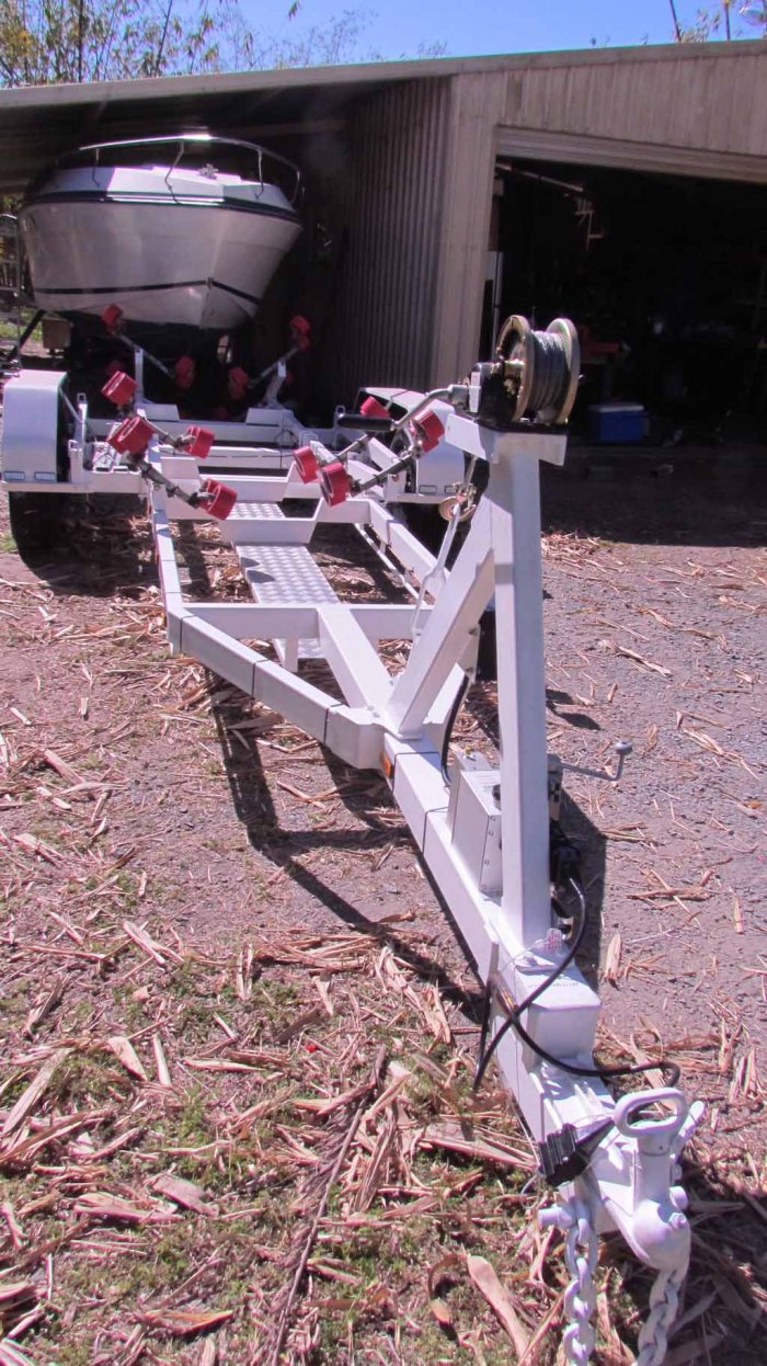

I painted the frame with two coat of Cold Galv paint and another 2 coats of epoxy paint to help keep rusting down, still a couple of bits to finish it off, the two small rollers at the winch post to lock in the tow eye and some more keel support rollers for the bottom of the frame. Now I can start work on the boat!!

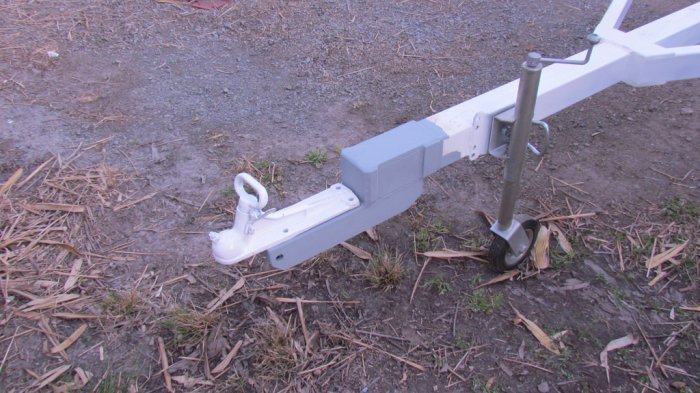

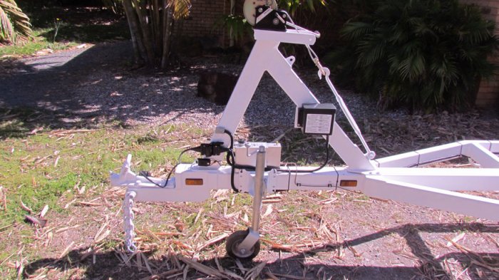

3. 8 inch Jockey wheel added to front of drawbar IMG_0541.jpg42.1 KB · Views: 562 -

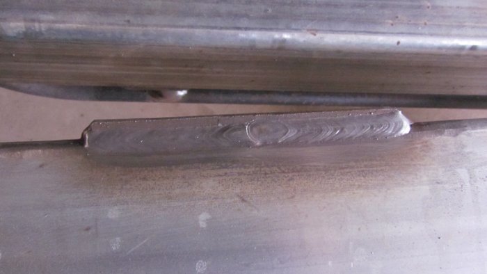

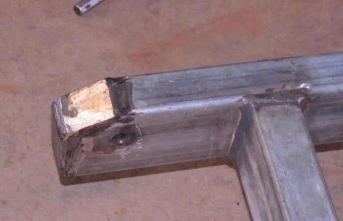

6. Trailer end sleeved to hold the wobbly roller arm Bolt IMG_0551.jpg40.6 KB · Views: 562 -

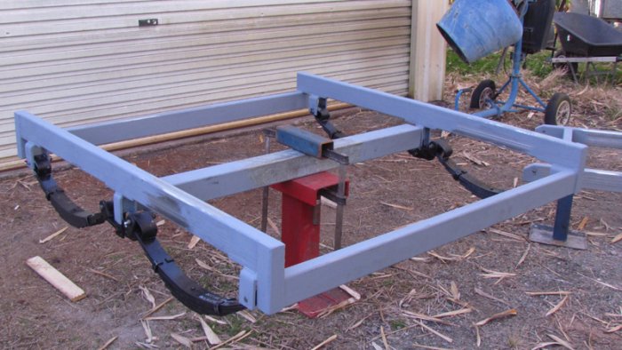

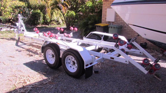

13. Frame holding the axles getting painted gold Galv, End caps fully welded IMG_0611.jpg69.6 KB · Views: 559 -
