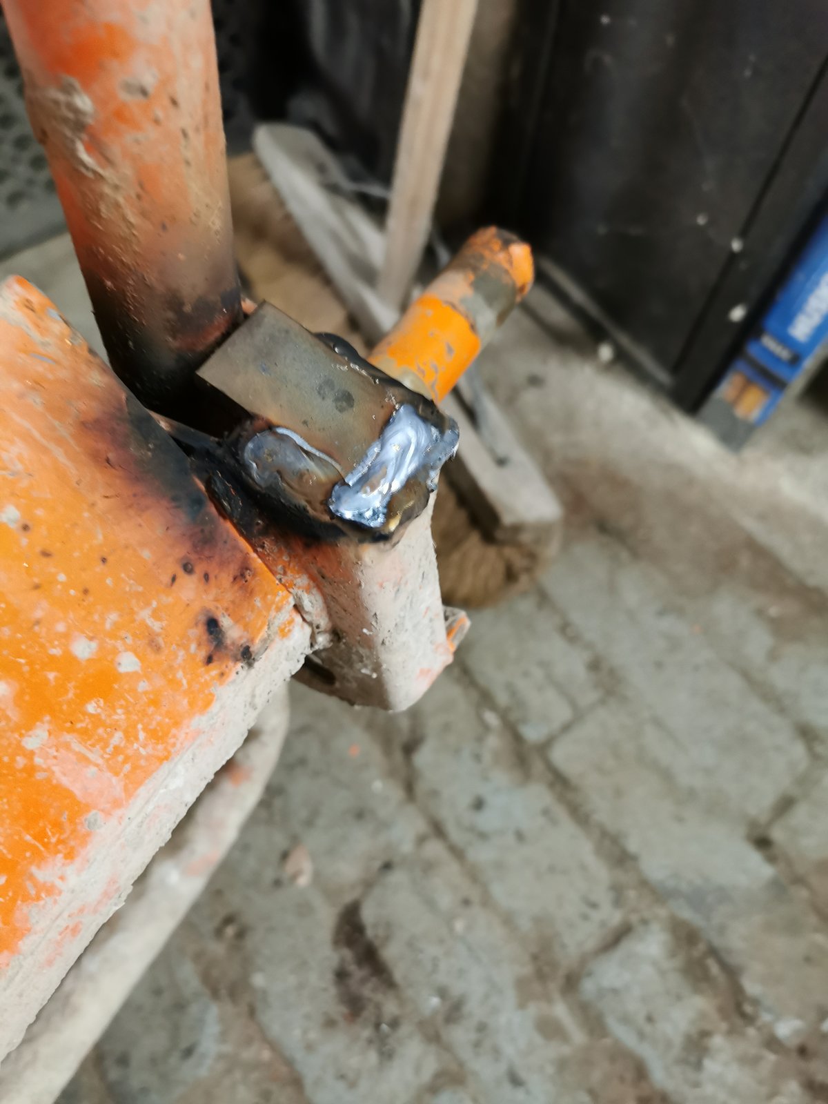

I needed to brace up the lugs on my mixer and raise the height by 15 mm. I also needed to try out the welder and lay down the first weld in 25 + years. I'd just add that I was never an expert, or indeed a welder, I'd just used stick and MIG in a workshop setting.

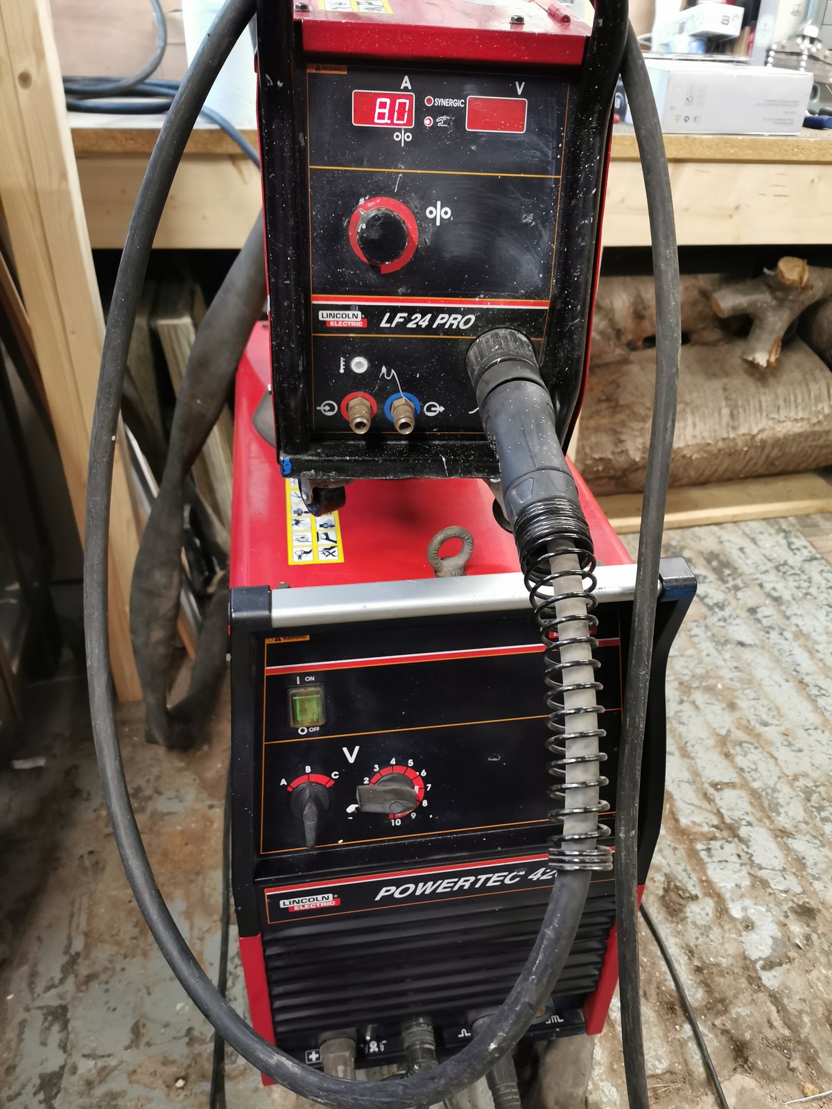

So, the mixer metal is 4 mm and the plate I had to hand is 6 mm. 1 mm wire in the machine, settings as below which is 22.4 volts according to the LED display.
Oh and I did grind back the metal to clean it up nicely, you just can't see that now as there's melted metal on it.
Thoughts? Advice? **** taking? All welcome.
