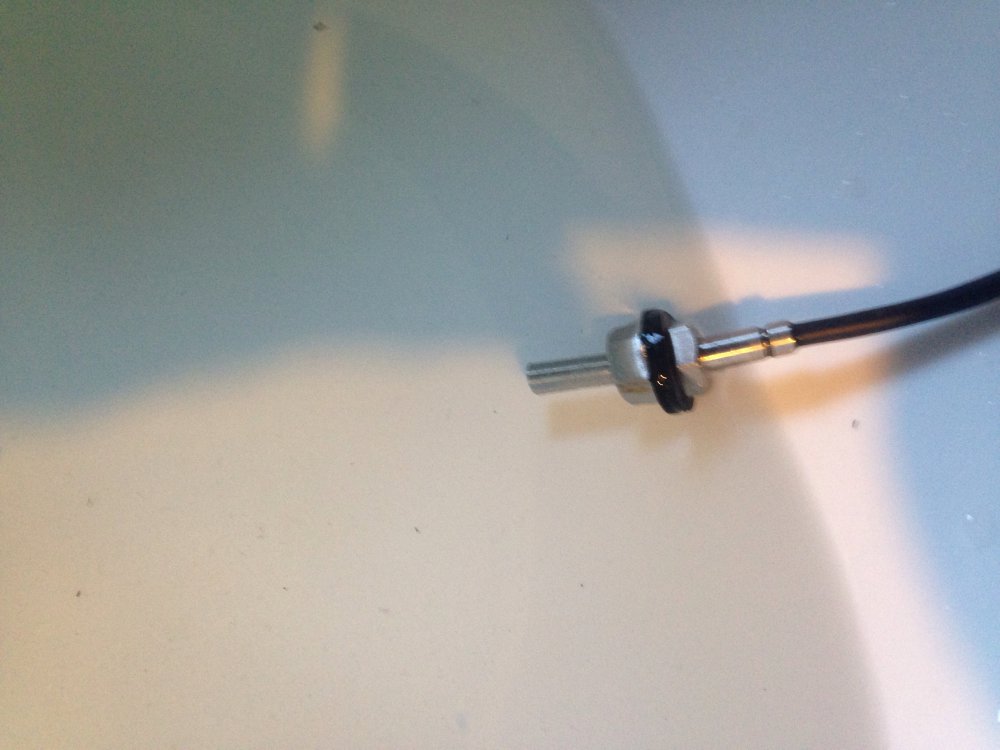

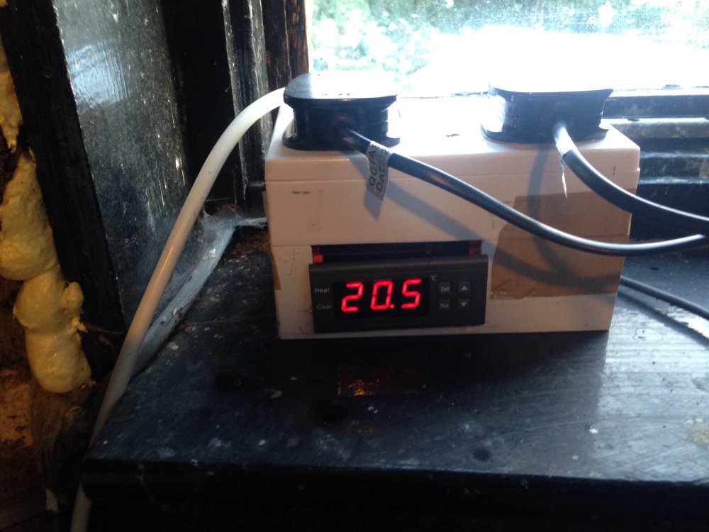

It's a basic water bath setup, but as I like to limit the variables I disabled the stats in the heaters and built this
It's a Chinese temp controller built into a double socket, it can switch 2.4kw without a relay, I went for the thermistor type to simplify the wiring but replaced the sensor with one from RS
It can also easily get to temp to develop colour film, but haven't done any for a while.

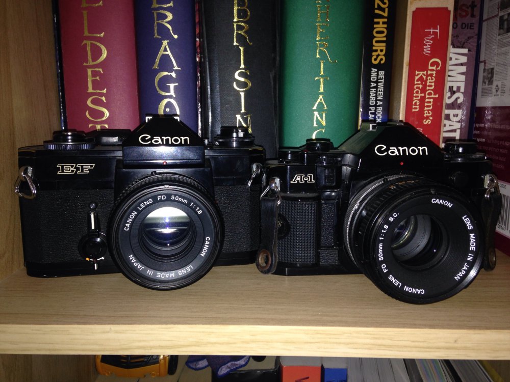

For those interested its a roll of Rollei Retro 400s I will develop in Rodinol (1+25) for 10:50, 20 seconds over recommended but without it I get bits of black on the sprocket holes. Was shot on a canon EF with a 50mm f1.8 lens (the one on the left)
