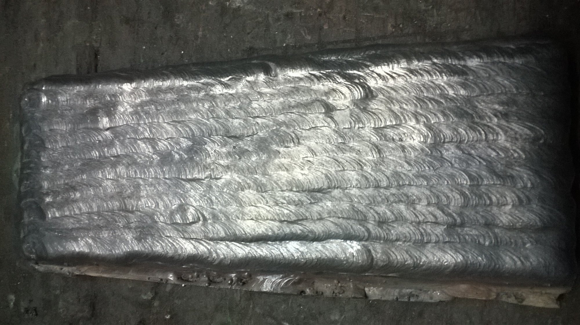

Make practice using common 6013 and 7018 would be cheaper than using stainless steel
7018 is my favourite electrode , it's way easier to use out of position and the slags are not as heavy as 6013 rodsFirst try 7018 padding beads. Electrode is specific and more difficult to lead than 6013 but beads looks cool.
Stainless steel rods are funny to run , but dangerous because the slags once cooled down will be shot
Very dangerous to your eyes , and smokes are plenty harmful for your lungs

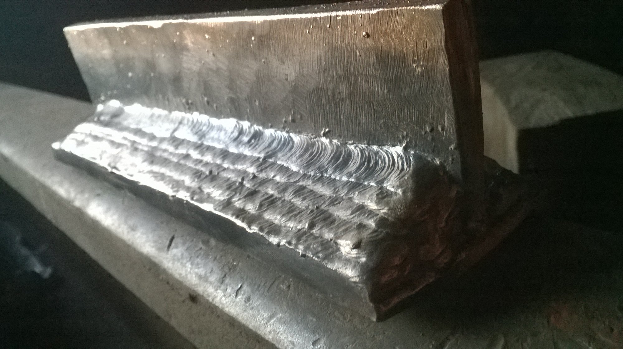

Training in fillet weld position?
It's not as hard as you might think
Fillet would be the best position
