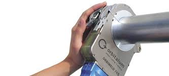

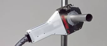

I need one of those then lolPolisius are probably top dogs for those things and yes perfect results from minimum skill.
Best Start saving the pennies. Those things are a fortune.I need one of those then lol
Lol. And who could blame them. It's a similar misconception in all automated welding processes. Just because the process can be used more easily and learned quicker doesn't mean the guy using it is not a up to spec in various manual processes too. I know a couple of guys who work with SAW along with many manual processes welding pipes. The tool is there to increase productivity and repeatability only.I can't remember company my mates worked for, company was based in Livinston. With a handful of my students, we had a tour around their shop. In the clean conditions room, some of the welders were running various procedures for pending work. They would rip the head off, anyone calling them button pushers.....lol.
It was perfect results with minimum skill I liked the sound of. ..anything expensive is beyond my reach. LolBest Start saving the pennies. Those things are a fortune.![]()
Yep. That's the one mate. I knew I'd spelt it wrong.Did you mean Polysoude Richard?
